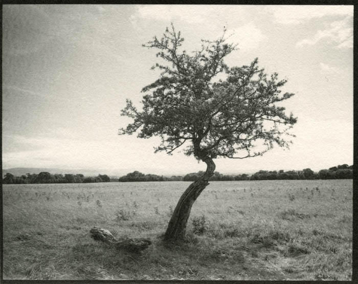

I printed 5 images and this was the first one and the one I like the most.
But the paper doesn't scan well. :sad:
