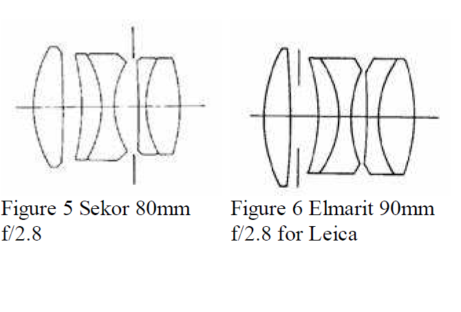

I was reading about this earlier, because the Mamiya Sekor 80mm f2.8 is really based on the 90mm f2.8 Elmarit design, which is a Tessar derivative. The f2 Summicron is a very different and more modern design.
