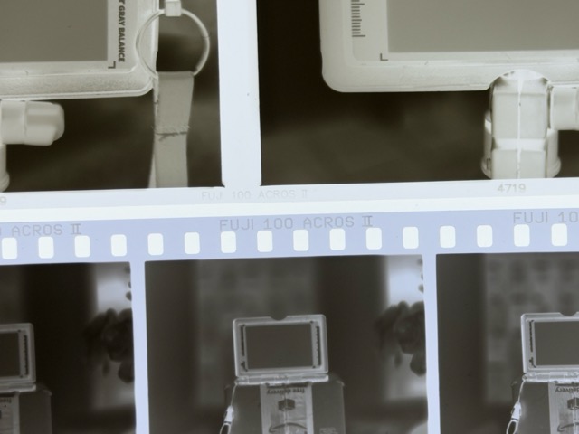

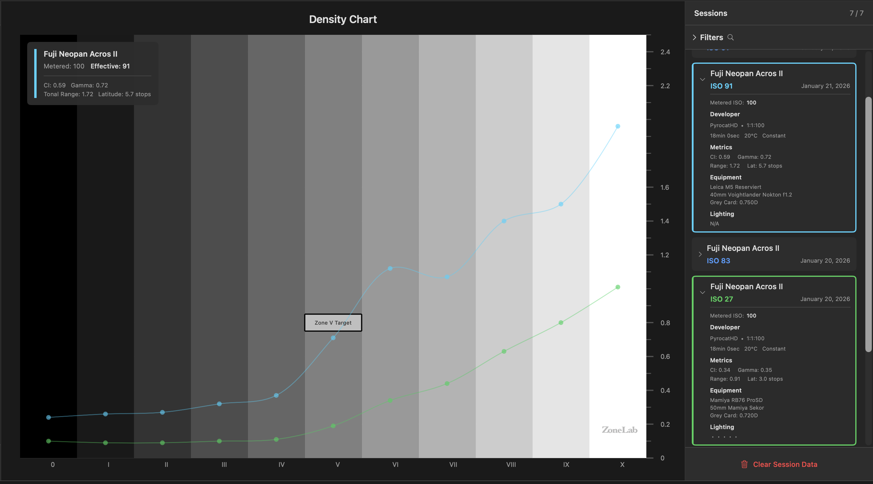

I just prepped a brand new batch of PyrocatHD and made a coupld of step tests to work with an app that I've been jamming on, and something weird is happening.
Both films here are Fuji Neopan Acros II, the one on the bottom is 35mm the one on the top is 120.
Both processed at the same time, 18 min @ 20°C in PyrocatHD (this has been my working time for Acros II so far with no issues)
Obviously very different results. The only difference is that i bought the 120 film a few months ago from B&H, the 35mm last week from Samy's in LA. All kept in the fridge.
The EI for the 35mm is 91 and an EI of 27 for the 120. It also looks like the burn in data on the edge of the film is much lighter on the 120.
Do you think this is a case of me being sold expired 120? There is the possibility that the 50mm Mamiya Sekor C lens might have a mal-adjusted shutter, but that wouldn't account for the burn in being so light and the different shades of the film base...
Thoughts?
120 and 135 are coated on a different base, so that they're of a different color isn't surprising. The blue color of the 135 is part of the anti-halation package of this film; on 120 this is handled differently, I assume on this film also with a dye that's included in either the backside anti-curl coat (which 135 lacks altogether) or underneath the image layer.
Edge print is generally not of controlled density so you can't say much on that basis.
For the difference in densitometry I'd primarily look for methodological problems on your side.

To be clear, these were both exposed at box 100, used the same grey card and the same spot meter in the lighting conditions in the same setup 5 minutes apart. I was doing everything that i could to make sure the tests were as close as possible. The EI was determined by reading the grey card exposures and putting them into Zone Lab
I was using known good lenses on both, one in a Mamiya RB67 ProSD with a tested 50mm Sekor C, the other in a Leica M5 with a 40mm Voightlander Nokton.

There must be - which is not to say I can pinpoint it. It's not just the overall higher density; it's also the wonkiness due to highly inconsistent measured densities across the tonal scale. Something's up for sure and there's no reasonable explanation that traces to the film, aging, fogging due to storage, x-rays etc.
Then there's the far higher gamma with the density at the upper end being massively for the 35mm film compared to the 120. That I can imagine could relate to a mixing error of either the batches of Pyrocat that you used. The non-linearity is not explained by this, of course.

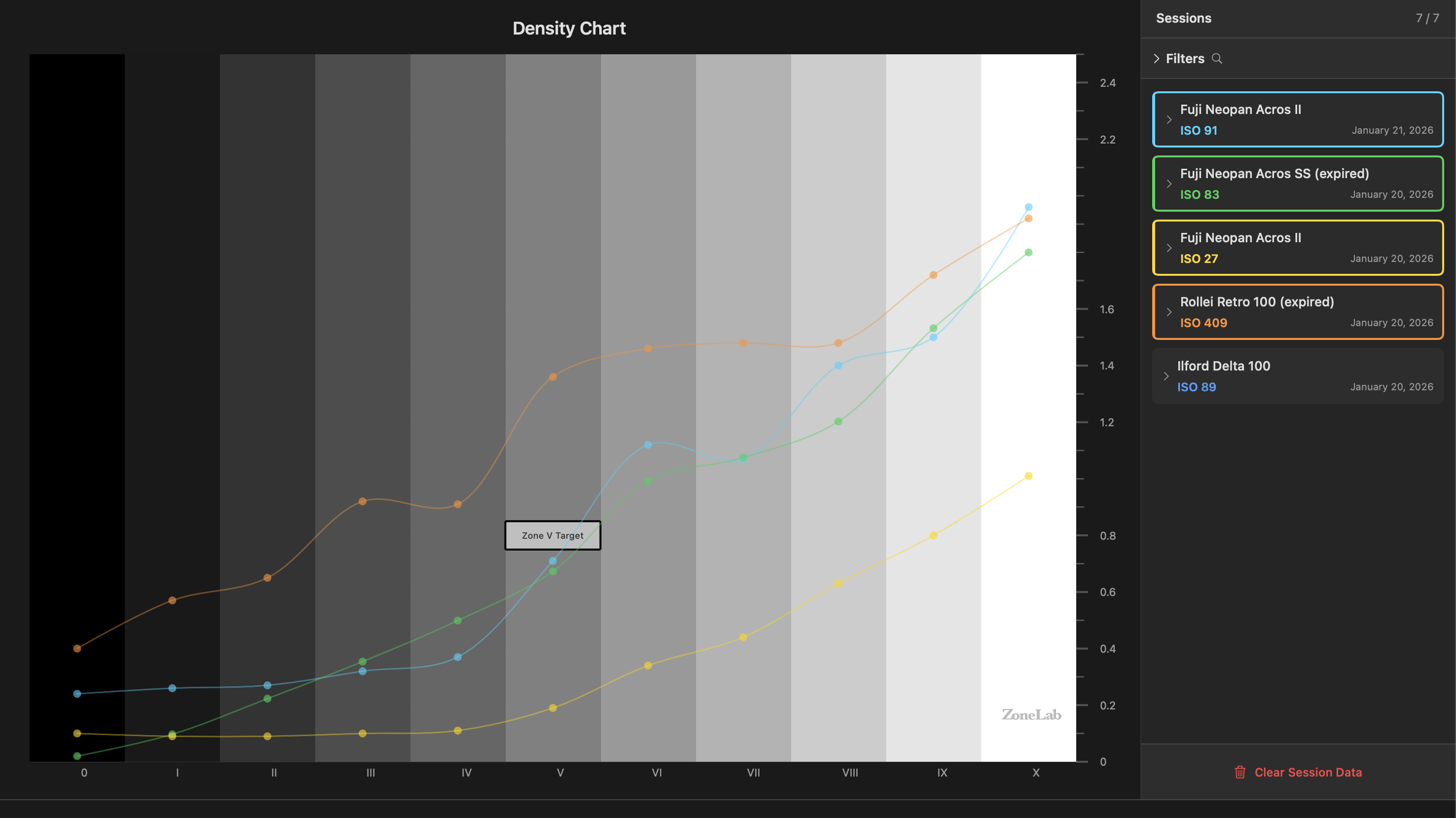

The films were processed in the same tank at the same time with the same brand new batch of well mixed 1:1:100 PyrocatHD. I use an AGO film processor in the Patterson tanks that does constant agitation for the whole development cycle.
For clarity, I processed 5 rolls in the same developer batch. Expired 35mm Neopan SS (green), New 35mm Neopan Acros II (blue), "New" 120 Neopan Acros II (yellow), 120 Ilford Delta 100, and some ancient Rollei Retro 100 (orange). The Rollei seemed like it was a touch fast, but that was expected as I exposed it at 50 ISO (I need to re-calculate the EI because it was calculated at 100 which explains the too high EI on the chart). The 35mm Neopans seem to be in line with expectations, as does the 120 Delta 100. The only odd one is the 120 "New" Neopan.
And I am going to re-run this test both with Delta 100 and Acros in both 35mm and 120 at some point this weekend.
