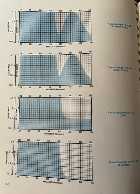

This page from Kodak Filters helps illustrate why it’s ok to use Red instead of Amber if you feel like it. Red cuts more of the spectrum so is safer.
