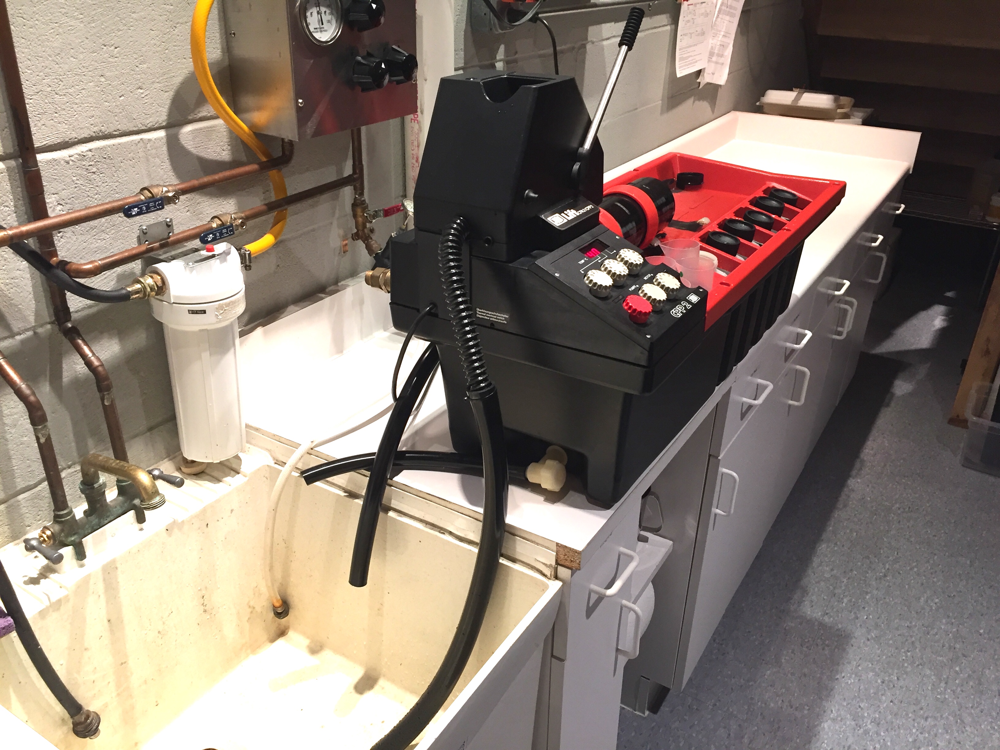

I bought a new CPP3 a couple years ago from Catlabs, based on my experience with Jobo stuff it should still be running 30 years from now.
Got my CPP2 new almost 25 years ago and still runs and looks like new today.
mshchem
Nov 26, 2007
14,630
Iowa City, Iowa USA
Got my CPP2 new almost 25 years ago and still runs and looks like new today. View attachment 311997
Yep, I have one of these great machines as well. I bought it as is off Ebay, as is for parts. I reset the thermal breaker, that fixed the no heat, I had to open up the unit and fixed the reverse switch. The original motor speed switch fell apart during my repair, got a decent close enough switch from Catlabs. Works fine now.
This machine had been used and not cared for. I spent several hours getting rid of lime build up. Mostly just warm water and Vinegar. I took the new style lift apart cleaned it and re-sealed. Replaced the drum tap. It works fine. I bought a new CPP3 because I wanted one. 🙂
