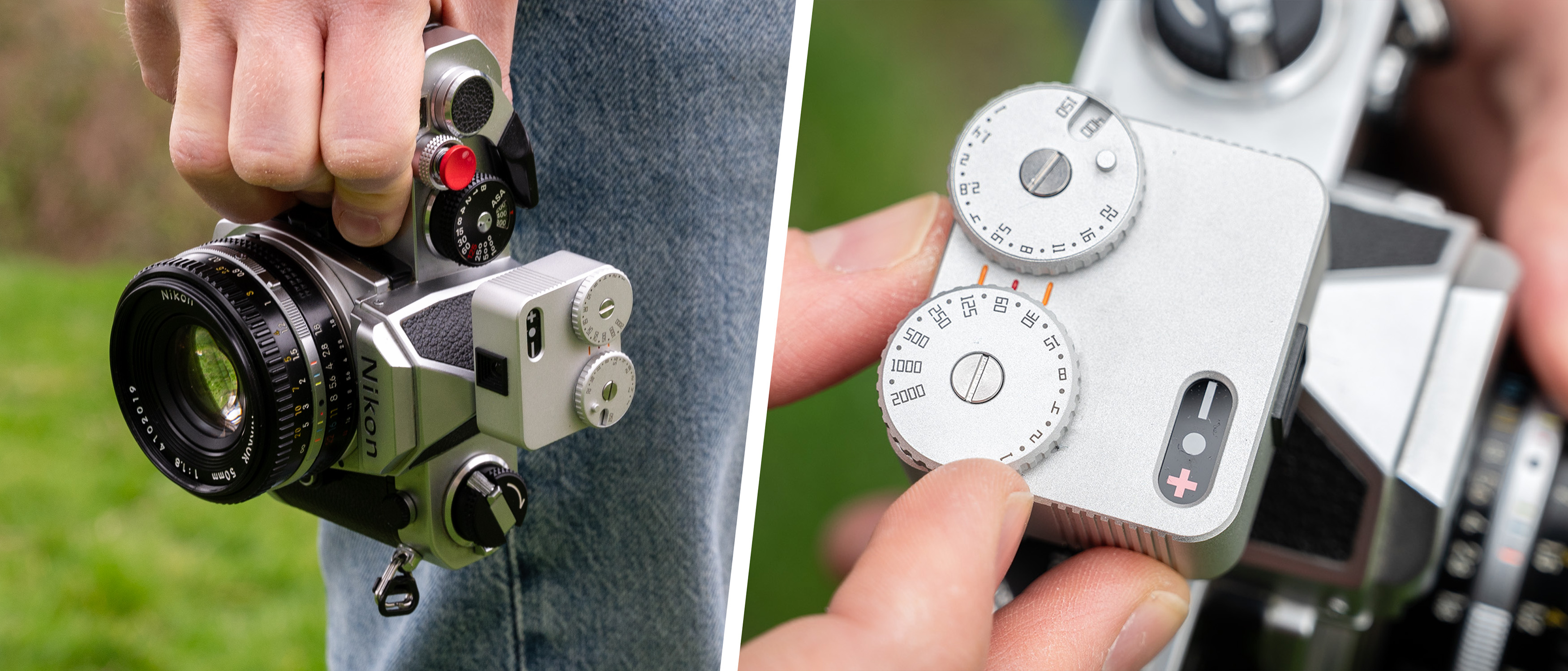

This one may be the Trabant of meters:
Looks quite good though. The article has it mounted on the Nikon FM which I am quite sure has a superior built in meter (I had several FM's and FM2 and all of them have accurate meter).
