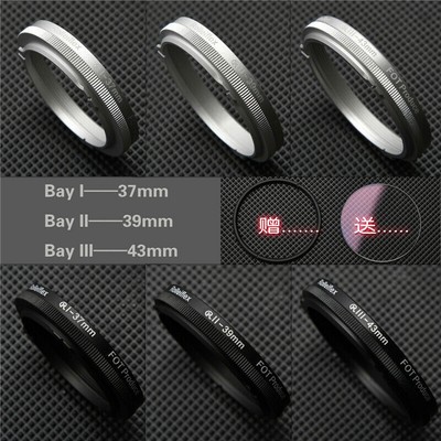

Thanks so much Dan. I just looked on eBay and found this Hong Kong seller which has the top filter already with the overlapping part removed. He is out of the Bay II version which I also need so I messaged him to ask if he will be restocking those.
Ah, that looks nice. Never fun having to grind glass with a Dremel!

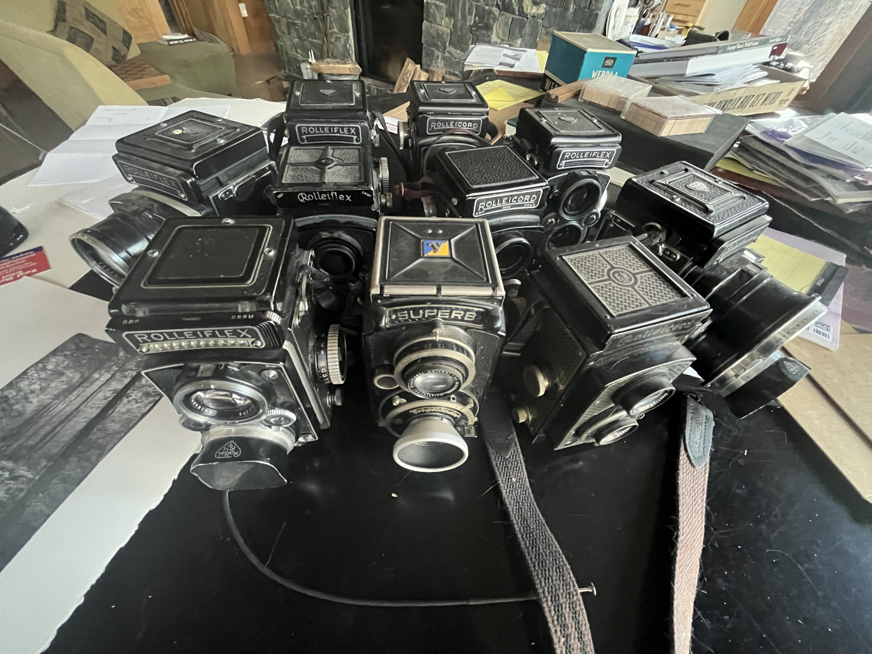

For the benefit of the group, I am attaching a photo of the ten TLRs still in my possession. I shoot them hard -- all but two have Maxwell screens, and each has made multiple trips to Paul Ebel for repairs to shutters and film transports. (The original Rolleiflex sits on a shelf, and the Voigtlander Superb gets light use.) One of the Tele Rolleflexes has lens separation issues (a common problem for the camera, which is why I ended up with a second) but please feel free to visit and inspect the condition of the lenses and coatings. Their lenses (Tele aside) were, and still are, pristine. I might kill shutters and transports, but I am meticulous about keeping a hood on the taking lenses in use, and keeping my fingers off of them.
That's not a dozen. I gave away six or seven other Rolleiflexes over the years, to other photographers. Do I need to get receipts to prove this to you as well?
And if you cannot make a long exposure handheld, I suggest you learn. It's a tremendously valuable skill for a photographer. And it's pretty easy, if you have some modicum of self-awareness and self-control.

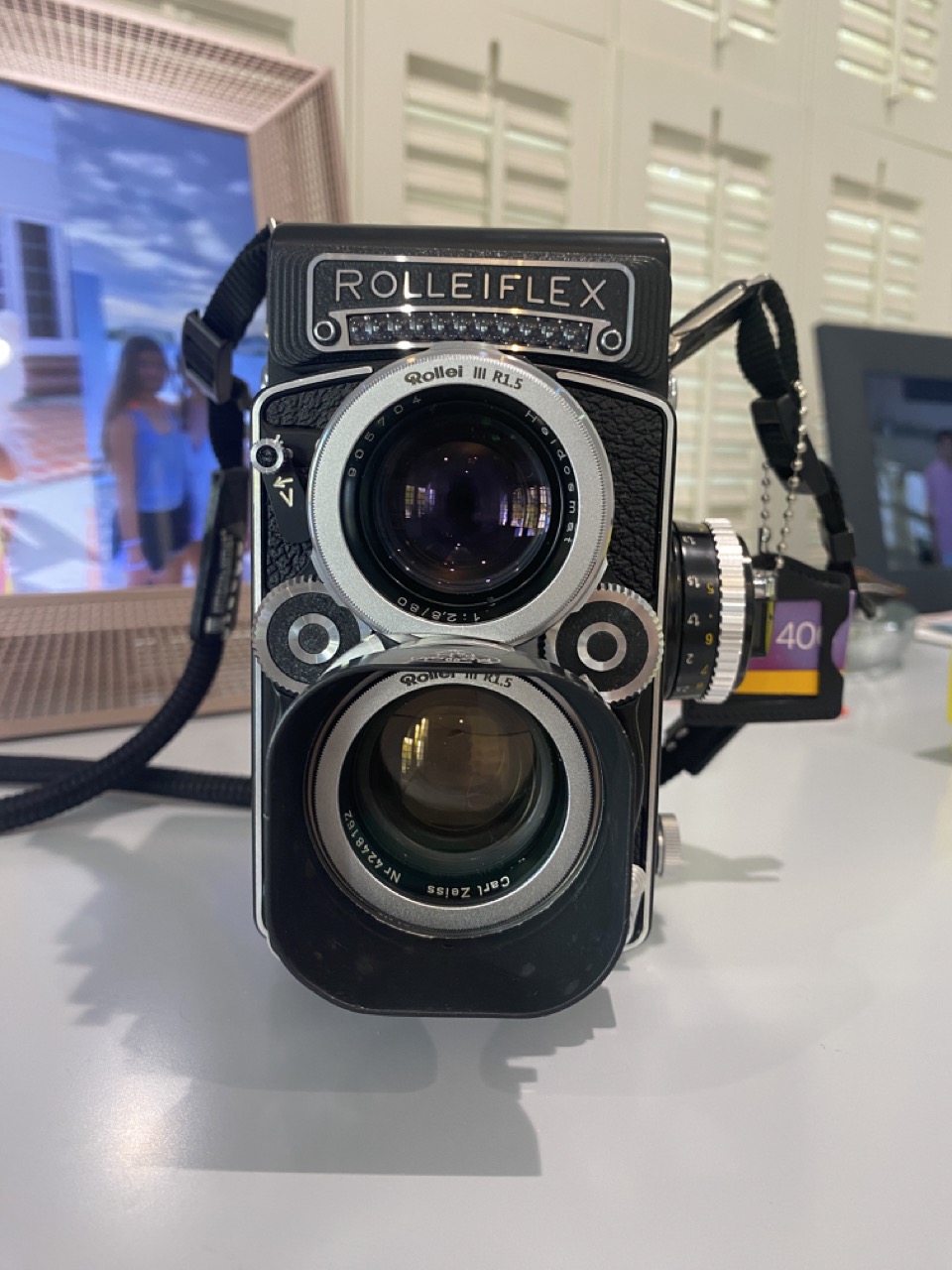

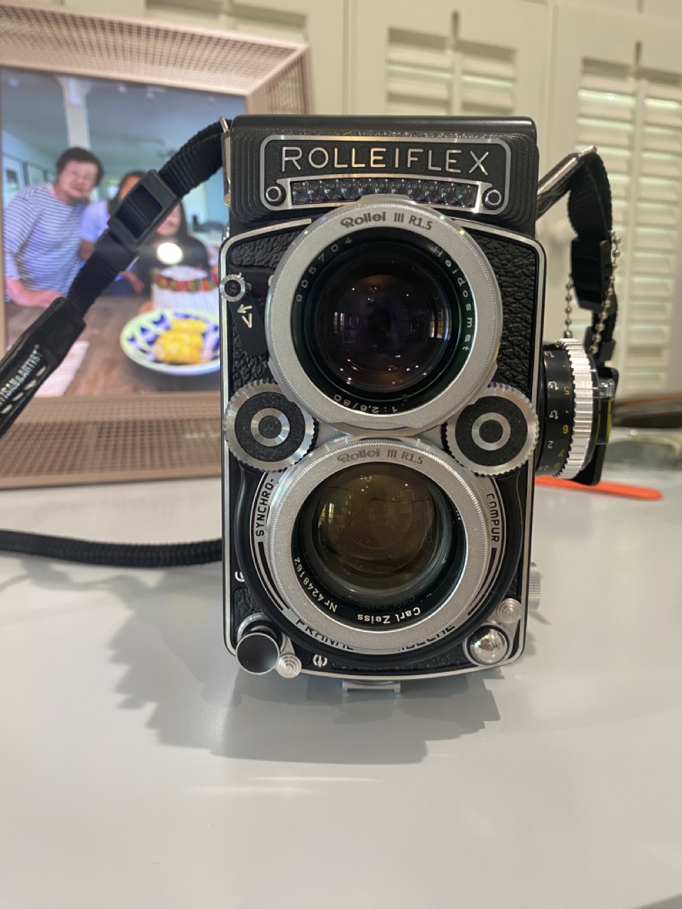

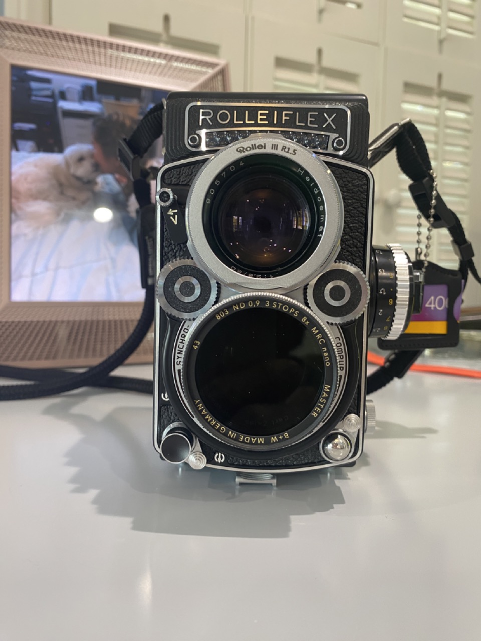

Just a follow up. I received the UV lenses as well as a bay III to 43mm adapter. The UV filters attach to both lenses and allow concurrent use of the hood. Without the hood, the adapter also allows the UV on the viewing lens to stay in place. This method keeps not having lens caps on any of my cameras constant so I don't need to remember to take off the caps as it could cause issues on some of my rangefinders.

Your camera looks fantastic! Like new!

Yes, even with ASA 100 film, I invariably need a 3 stop ND filter and 6 stop if using ASA 400 speed film on most days I’m at the shore. It’s easier not to have lens caps and aloe have the ND filter attached or at least the UV filter on and ready to change out if needed.
Looks as if the top filter is notched and the bottom one not? Or is there a lower cut-out? Anyway, both filters look well made- are they?

Yes, the bottom filter is notched at the bottom which allows both the lower UV filter and bay III->43mm adapter to fit. They all seem well machined, without any play and with a definite "lock" feeling when twisted into place. The packaging and Ebay ad states it uses Schott multicoated glass but I cannot say for sure. They are coming out with a re-designed version for bay II sizing which I would need for a 3.5F.
