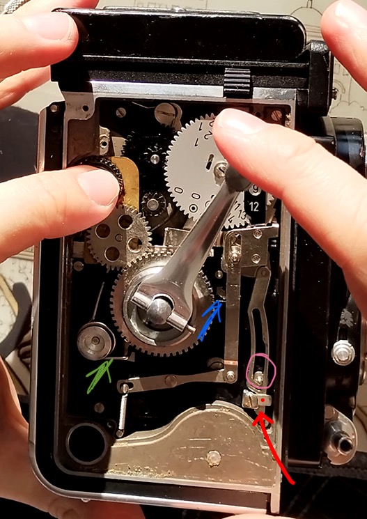

You mean the little piece of metal that I marked with a red dot in this picture?
That is very soft and it can be bent quite easily. It didn't help as far as I can tell

So after a couple of hours this is what solved it for me:
the problem was for me most likely that the spring that pulls back that pin (pink circle) that cocks that lever (as you marked with red arrow) lost too much tension. So the tension wasn‘t enough to move that lever far enough.
I removed that spring (green arrow) and bent it to have more force. That solved it for me that the lever was not consistently caught on the square you marked with the red dot.
Another issue that occurred was that when rotating backwards after winding the film the winding wouldn‘t stop as it should. For that you just have to move that little pin up that you can see through a black window on the other side of the assembly (blue arrow). Hope this helps in case someone else encounters these problems.

What fixed it for me was to detach the whole side plate from the body and give it a good clean, plus adjusting the position of the little square block.
However, that black cog that I'm holding with the index finger in the picture, which goes into the spool, for some reason is made of plastic on my model. I played around so much trying to fix the camera, that I ended up breaking two little teeth on it. There's no fix for it except replacing it. I did find a replacement part, and I'm sure it's exactly that one (spares have a code name, this one is 08072.00.0), but this one is made of metal. Turns out the diameter is something like 0.1mm larger, and it doesn't fit :sad:
Btw that little lever that you showed with the blue arrow gave me a big scare...I thought I had messed up, instead it was just the backward stop pin that got caught under the central block and was stuck there, not blocking the crank from winding backwards anymore. Thankfully moving the pin from the little window there is enough to fix it (big thank you to whoever at Rollei thought about cutting that little window back in the day). I found that happens pretty often when putting the side plate back on.

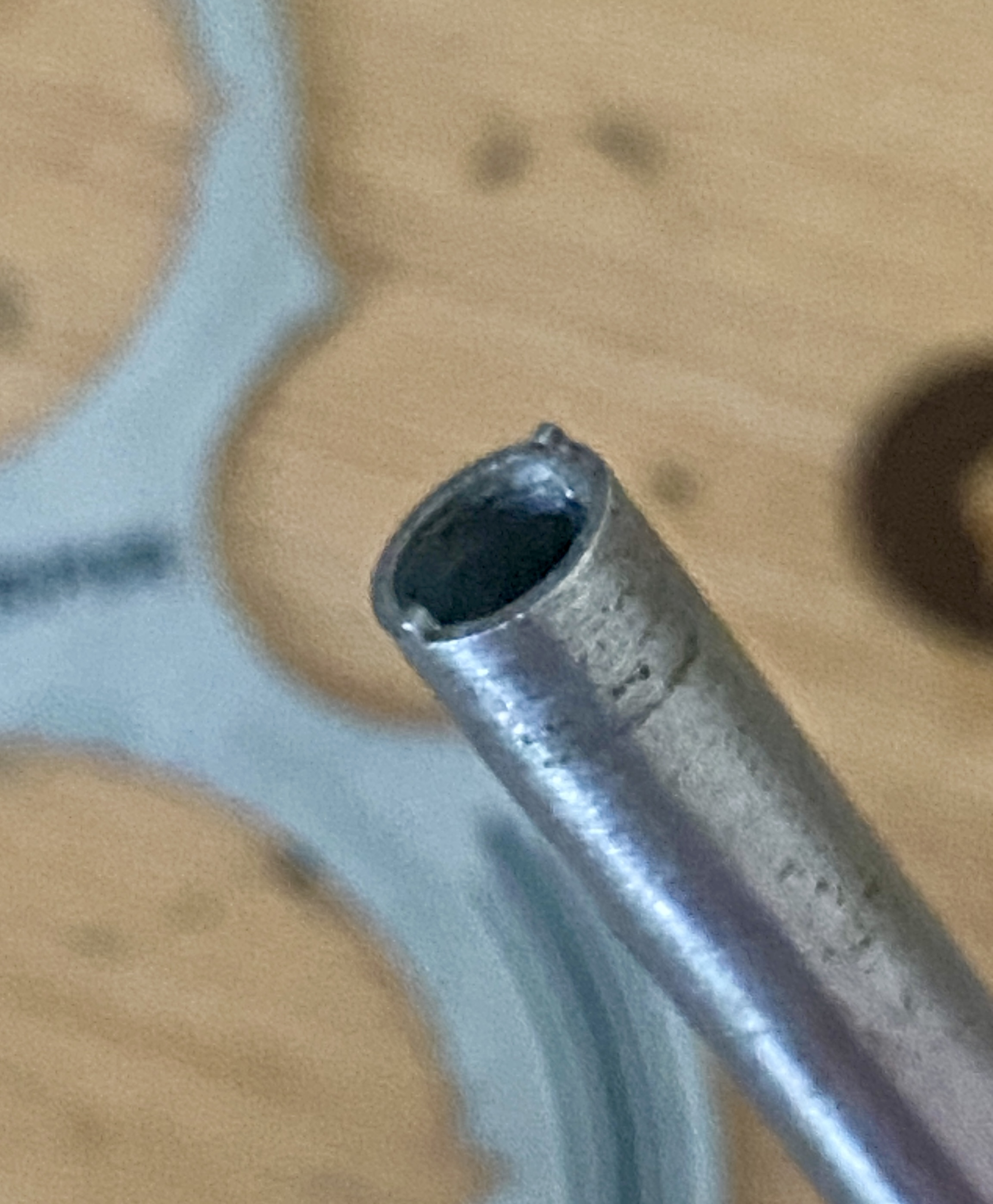

For opening that retaining ring you need something as the photo. Or spanner wrench with the two pins really sturdy (not flexible).
Dimensions are:
Outer diameter 6mm
Thickness 0.6mm
About the broken cog… as I saw all T and Rolleimagic have same cog but 3.5F, Wide and Tele share the same, I think 2.8Fs as well. You might try to find one of them and see if they fit.
