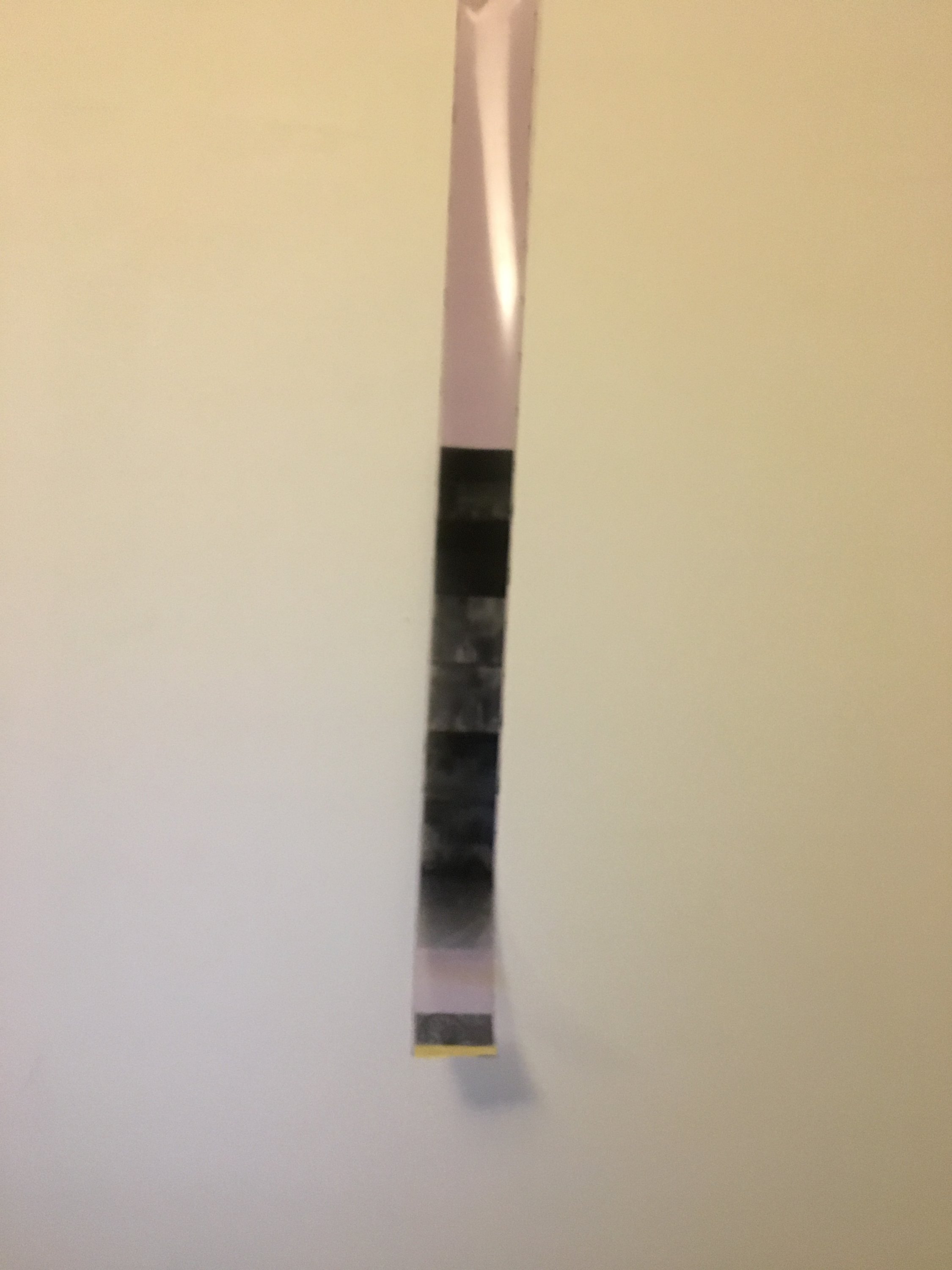

Well after shooting and home developing I see the following negatives strip and I am not sure what the problem exactly is and if I can fix it myself?
See photo 1: frame 12-19 are black and the other frames partly overlap and the roll also ends with half a photo, just before frame 1. I guess the frame spacing is not working properly or I made a mistake at the start of the roll.

What does the last picture in the middle of the film show? Are there any double or more images on the same part of the film? If not then this means that you didn't cock the shutter or you did cock the shutter but it is stuck.
Further, from your film roll it appears that the film was completely advanced before opening the camera, so the film advancing system works however should get cleaned since there is overlapping. You can do that yourself by taking off the part of the camera with the advancing lever and clean the inside 'gear clockwork' with some lighter fluid.

Really appreciate your info, thanks. There are indeed double images, some overlap half an inch. It seems the last 7 images are "taken", but the first 5 not.

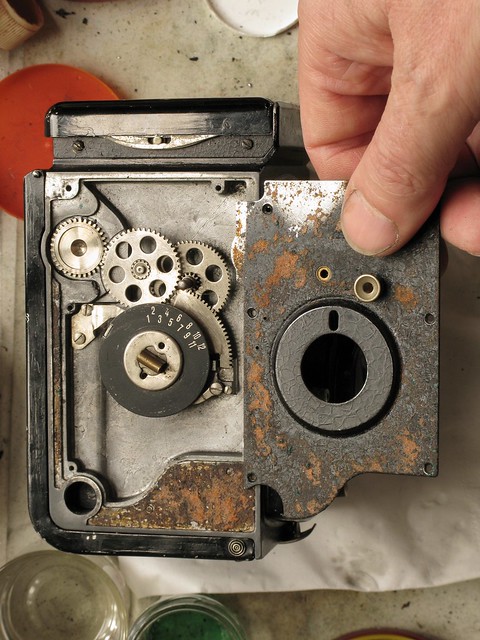

There were actually two frame counter mechanisms on Old Standard
One that stops displaying 12, that was posted earlier by Ron
One that stops displaying a red dot
This version actually shoot 13 frames, check how many times you can turn the crank before hearing the "counter end clicks"
You don't hear it between 12 and the red dot but you hear it when you crank after
On a 13 frames counter, the spacing is very tight, expect 2mm overlap unless you use a thick film;
A larger survey must be conducted but I think 620 and 621 have the 12 frames counter and 622, the 13 frames counter

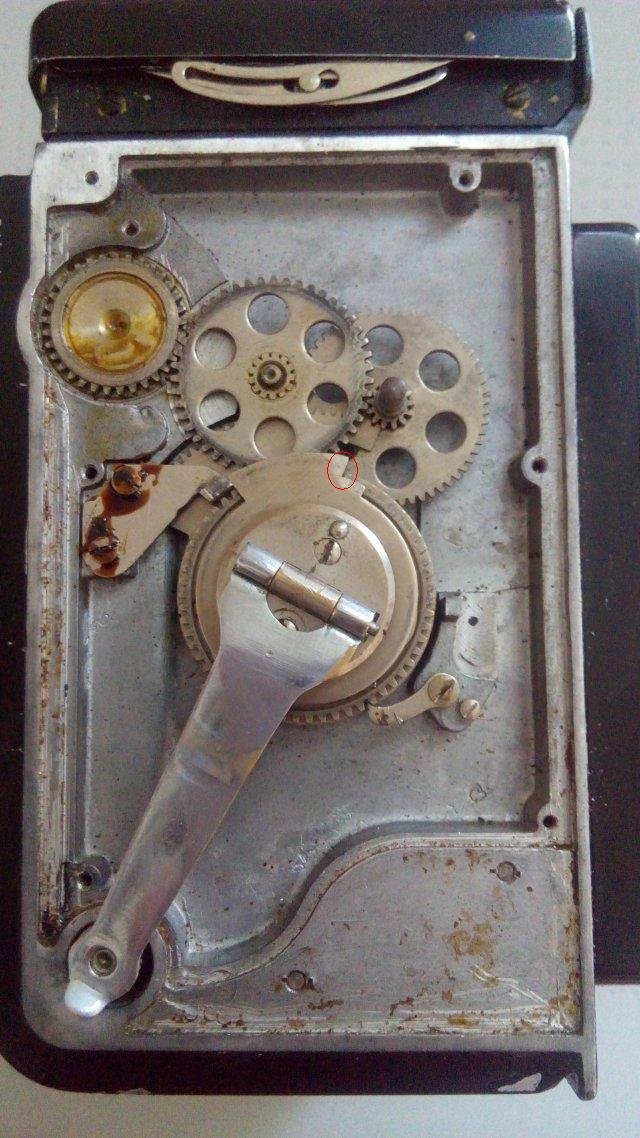

Here is the part responsible for the spacing, I think, since I can't find the disassembly photos of a 12 frames counter for comparison
