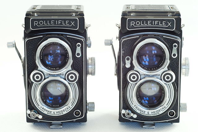

I bought (after using several older type of Rolleiflexes and Cords) in the 'end' the 3.5f type 5 (white face) - have 2 of them (one for color the other for b/w), because of the very high resolution of the six lens planar. I had the 2.8f before but found it too heavy and did hardly ever use the 2.8 stop.
Afaik, the later model FX has also the 6 lens planar (and of course the HFT coating); but since I don't miss using the 2.8 (still hava a 2.8A flex that I don not use), I stay with my 3.5f whities...
(over about 25 years I had about 16 Rolleiflexes and 8 Cords)
I don't know from own experience but some say the GX and FX feel plasticy compared to the older models....if you never had an older model, you probably won't mind the difference....

I had two of these in very (really) beautiful condition, a type 1 and type 2; few weeks ago sold the type1 and still have the type 2; perhaps I will sell it indeed (and this one has the very very rare sunhood and the (also quite rare) matching leather case. ....
Since you have the rare lens hood for it maybe you should keep it after all and use it more? It's a special camera and the 2,8 Tessar should perform little differently from the common 3,5 and add more character compared to the Planar/Xenotar.
I agree with what you said about the 2,8F being too heavy and that you didn't have much use for the larger aperture, and that's the reason I sold my 2,8F. The next Rollei I will load with film is a 1939 Automat. I like the Tessar and how lightweight the camera is.
How likely are you going to DEEPLY regret selling one of these?
What is unusual about the lens hood for these models?
Its the only hood that was made for this type of Rolleiflex; the 'regular' bay1, bay 2 and bay 3 hoods do not fit. Since this special hood is very hard to distinguish from the regular hoods, and therefore not as such offered by (regular) sellers, it is very hard to find if it is not provided by the camera as such.
