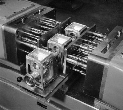

Yes, the chassis is an aluminum casting that was machined. Not made by Rollei; I think there are at least two supplier names to be found inside over time and models. Here's a photo of a setup to index and drill/tap both sides of the chassis block after machining.
And more factory photos-
Thanks for posting this link. I like my Rolleis even more now! (and I have a stereo Rolleidoscop as well, the forerunner of the Rolleiflex, it still works and is a pleasure to use).
