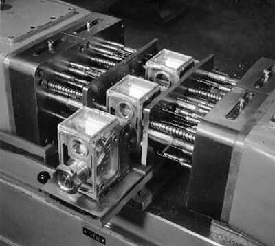

Was the bare chassis a machined casting? Does anyone know?

Yes, the chassis is an aluminum casting that was machined. Not made by Rollei; I think there are at least two supplier names to be found inside over time and models. Here's a photo of a setup to index and drill/tap both sides of the chassis block after machining.
