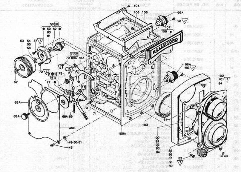

Rolleicord VA lots going on in there even on a III or IV.
I don’t understand. I’m not sure if your being serious or not. I’m not sharing your humor at the moment. It’s me, not you... but what do you think that exploded diagram is showing regarding this discussion?
More than meets the eye from the exterior. Linkages and levers pass one another at very close distances, possibly a few thousands of an inch/ tenths of a millimeter. Play in one can affect unrelated control operation.

The cable release is under the lens, not directly on the shutter so the release is by levers. An exploded diagram of the III would make the explanation easier.

And I found a pdf on ebay that shows exploded views of the Rolleicord III through Wide angle Rolleiflex, along with their projectors and some finders.
