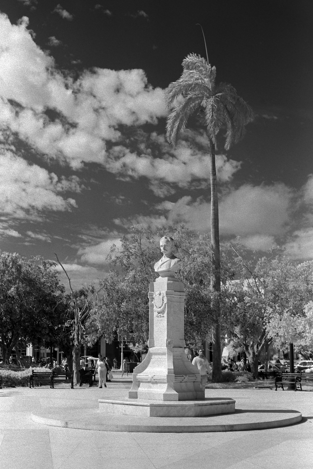

I have managed to do some IR handheld with the R72 filter. This was on a trip to Cuba (so intense tropical midday sun) and was handheld at 1/25s at I think f4. The negative was on the thin side but not severely thin. It's a bit grainy because it was a 35mm camera; the only time I did infrared with that format.
Jose Marti monument, Ciego de Avila by Howard Sandler, on Flickr
