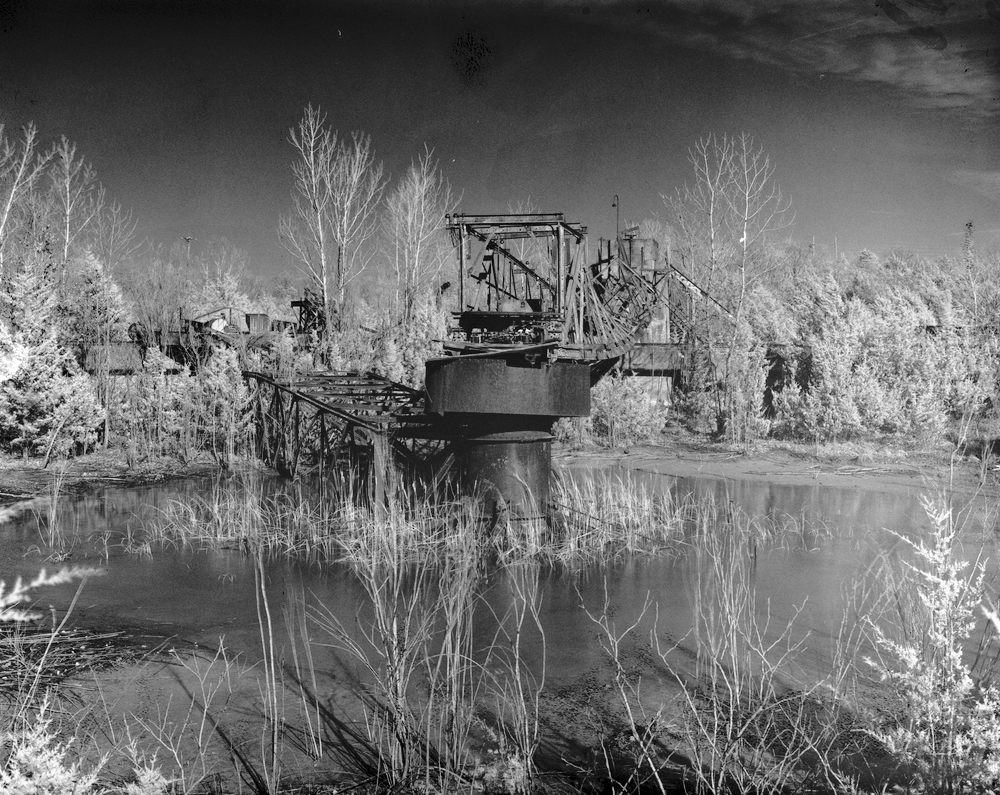

My first try I shot at ISO 6 with a 720nm filter and went by what the box said, 12 minutes. They came out very dense, though I was able to pull an image from them with a scanner. After that, I decided I need to do some test shots. I took 6 pictures with 3 sheets using a half dark slide. Half of each sheet is with an IR filter, the other half without. ISOs were 100, 200, and 400 with no filter, and 6, 12, and 25 with. I cut the sheets into strips and tray developed them at difference times, with the most detail coming out around 6min. Even so, I am still getting very dense negatives, even when there appears to be almost no shadow detail. They do not appear to be fogged, however, as the edges of the sheets that were no exposed are clear. They are drying at the moment, so I haven't scanned them, but I expect a very left leaning and narrow histogram band when I do.

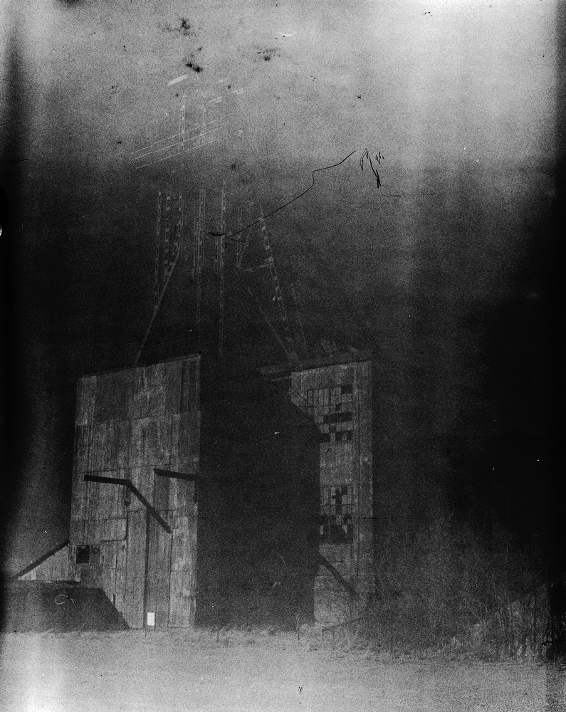

Photos: The 2nd one is all I could get out of it. The negative was almost black.

The first example above... is it one of yours?
Also, are you loading/unloading holders in a completely darkened environment?

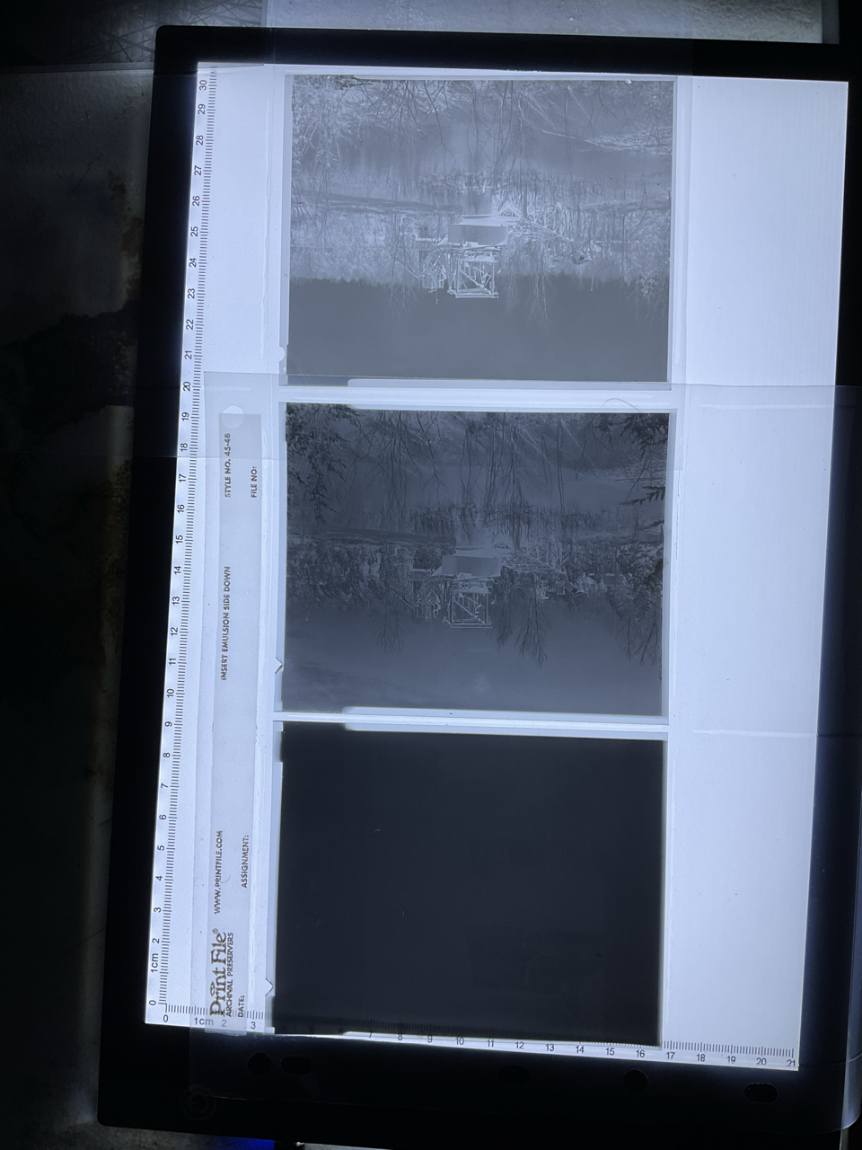

1st image is also mine. It's also too dense, but was at least a 'usable' image. Printing with it would be an absolute pain, though. I load and unload in my darkroom, which is light tight. Fpp Frankeinstein with the same subjects were loaded, shot, unloaded, and developed in the same sessions all came out fine. I'll go grab a shot of the raw IR400 negatives real quick, and see if the issues are clear enough.
The top image is Frankenstein 200, and about when typica density looks like, despite my ipads exposure making it look thin. The bottom two are IR film. Notice the blow out on the edges of the frame, too.
