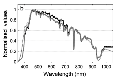

Moreover, it would be the other way around - on a cloudy day, the relative component of IR in the entire spectrum is more than on a sunny day:
(source)

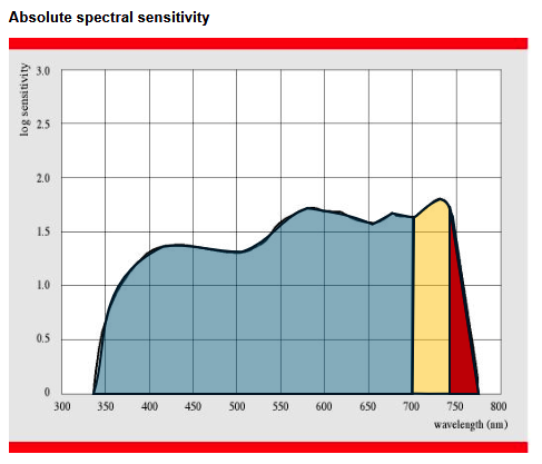

The influence of IR on total exposure depends a bit on how you define IR; if you define it as anything above 700nm (where human visibility reaches virtually zero), it's a small part of the integral exposure; if you define it as >740nm (popular cutoff of IR filters for our purposes) it's just a sliver:
The yellow + red parts are maybe 25% of the integral exposure; that means effectively a difference between let's say EI200 and EI250 or so if you include or entirely exclude that part of the spectrum (which is a very different and much more extreme scenario than the more subtle relative attenuation of cloudy vs sunny!) The red part (>740nm) is something like 5% of the total exposure, so the effective impact on film speed between sunny & cloudy would effectively be negligible.
Hence, you can work out fairly easily that the IR difference between a sunny our a cloudy day would have only a very slight effect on total exposure, with the cloudy day resulting in a higher effective film speed than the sunny day, and none of this being a good explanation of an entire stop in film speed rating. There's a more problematic aspect to this proposition, and it's the fact that the relative distribution of spectral flux actually does not change all that much between cloudy & sunny conditions - grasping back on the spectral plot I've quoted before, the same article also shows a normalized plot for these conditions, which shows that the relative distribution is really virtually the same:
You could try to make a case for broad daylight vs. dusk/dawn, which would have more of an effect. However, that would make for an apples & oranges comparison as you'll be changing the entire spectral distribution and not just the IR part. For the same reason we don't use different ISO ratings for regular B&W film for broad daylight vs. early mornings & late evenings, we shouldn't do it here with a film that happens to have a little IR sensitivity.

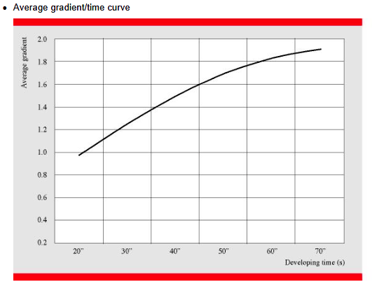

For the real reason, refer to the datasheet here, specifically the curves shown below: https://www.agfa.com/specialty-products/wp-content/uploads/sites/8/2017/06/AVIPHOT-PAN-200.pdf
Note how the effective speed is roughly 125 to 250...
...but that's for a gamma that's over 1.0, whereas for general photography, we generally aim at something like 0.6-0.7.
The reason for the optimistic speed rating of 200 (let alone 400) is therefore mostly due to a situation that's akin to 'push processing'; an aerial imaging scenario is effectively a low-contrast situation, so the film is developed to a high contrast to compensate for the low SBR (scene brightness range). The result is that the speed point is bumped a little, too (see HD curve family on page 5 of the datasheet; you can plot the ASA speed point in there and see how it moves a little).
Taken together, the rating of 250 is the best-case 'wind in the back, sun in your face' scenario for the film developed to the maximum gamma for its aerial imaging application, and the 400 rating is a marketing fudge factor added on top of it because hey, it looks good in the sales pitch and shucks, who gives a hoot anyway what speed it really is. Developed for a more usual gamma in regular photographic applications (visible spectrum), you can expect this film to reach no more than ca. ISO 100.
