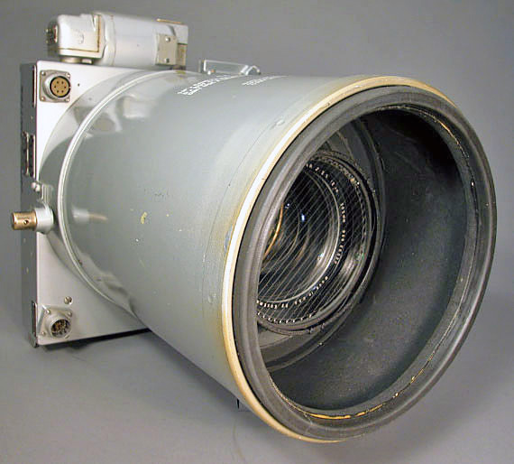

The lens is an aerial lens, it can shoot on 9-1/2 inch wide roll film. Comically large stuff, I cut it up into sheets.
Believe or not, you can still get this type of film! Agfa does still sell it in 9-1/2 inch rolls, although you do have to meet a minimum order requirement of something like $8000 and 2000 feet of film from my understanding. However, I’ve gotten it in smaller quantities for a couple of folks on here from Astrum in the Ukraine.
The real trick is, you need a camera to shoot the stuff, and a way to develop it. I know someone that has the camera, he says it weighs about 500 pounds! Good luck getting a tripod for that thing! And the developing rig is basically a giant tank with a couple of spools you have to wind the film back-and-forth and back-and-forth between for quite a while before the film is all developed.

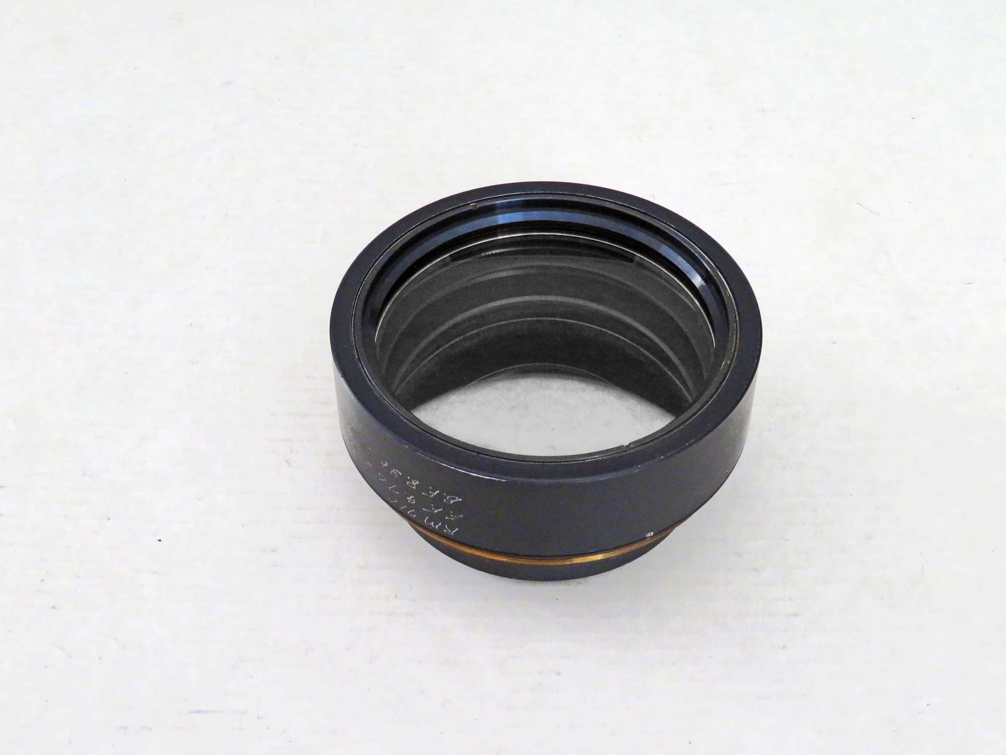

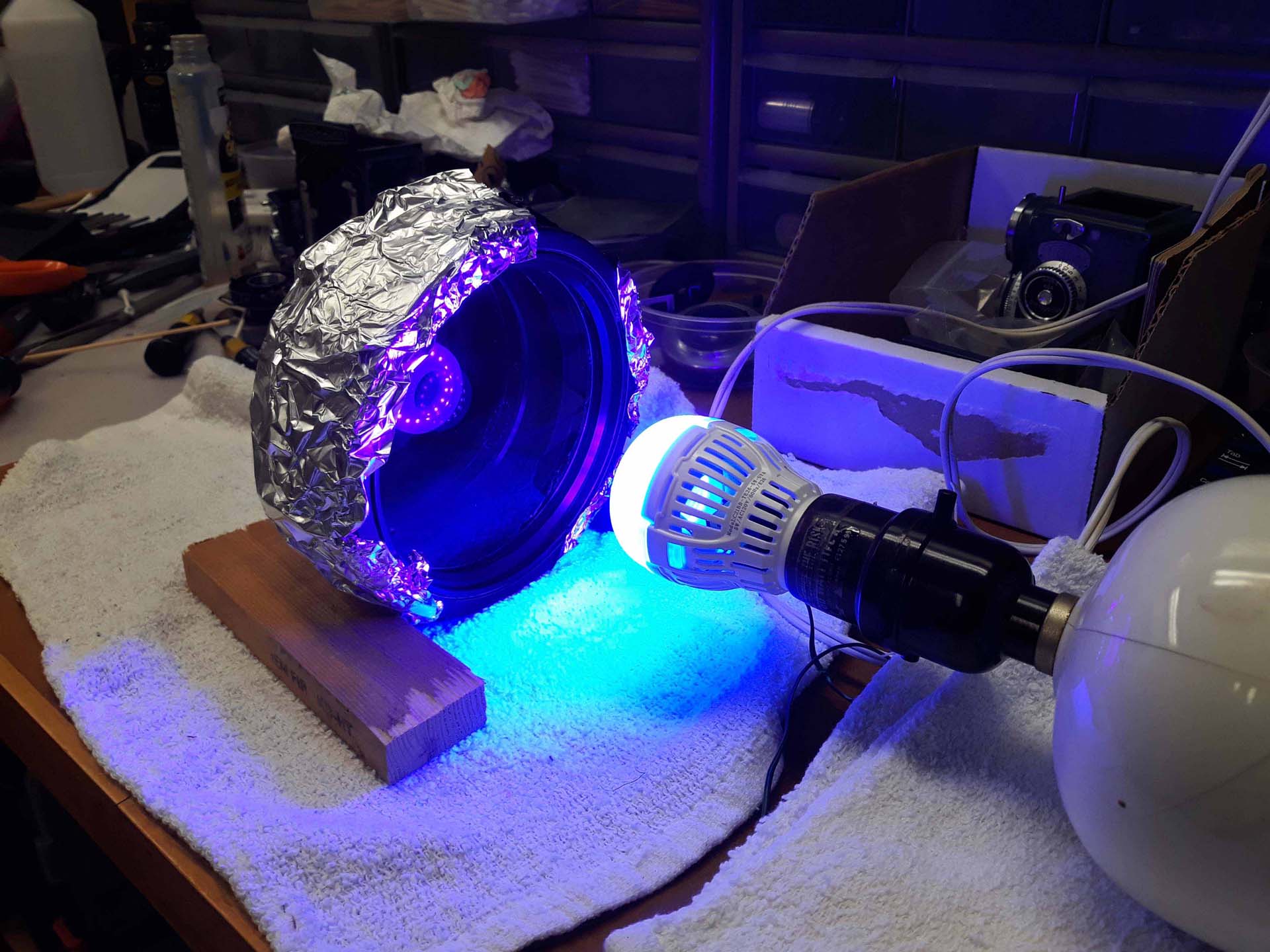

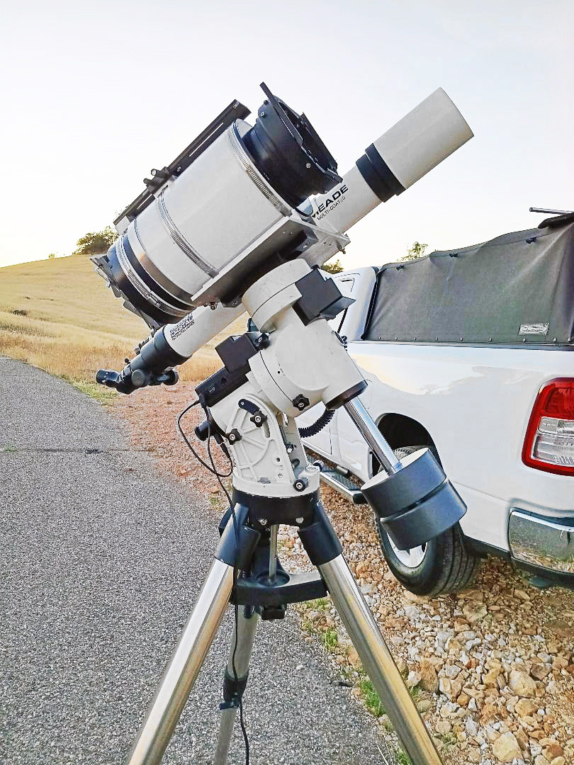

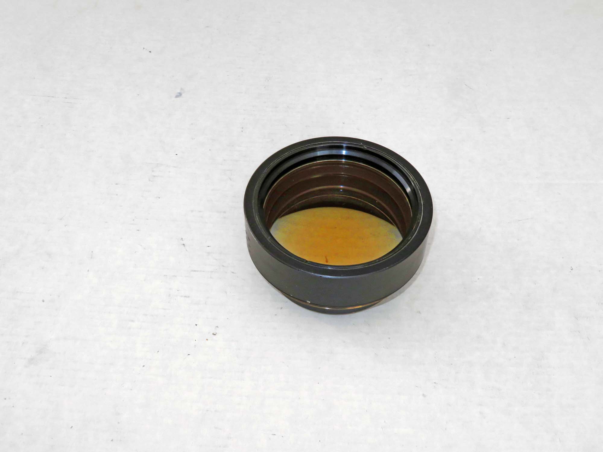

No thanks. I do not have the original camera any more. I have constructed my own astrograph camera using this lens and 4x5 film. It attaches to my German equatorial clock drive to take time exposures of the night sky with no star trails. I attached a photo of my rig setup on the local mountain a few weeks ago. Also note the before and after shots of the rear lens cell. It contains thorium which turns the glass brownish as it decays. I completely cleared it by exposure to UV for about 7 weeks. Lastly is the camera my lens came with. I had no use for it and got rid of it years ago.

Holy Cow, and I think I'm crazy! 😁
Very cool!

As for the type of UV bulb I used, it was the following I found on Amazon:
SANSI 5W LED Black Light Bulbs, A15 E26, 320-400nm​
I wanted something low wattage so not to introduce any heat into the lens cell. That might account for how long it took to clear.
