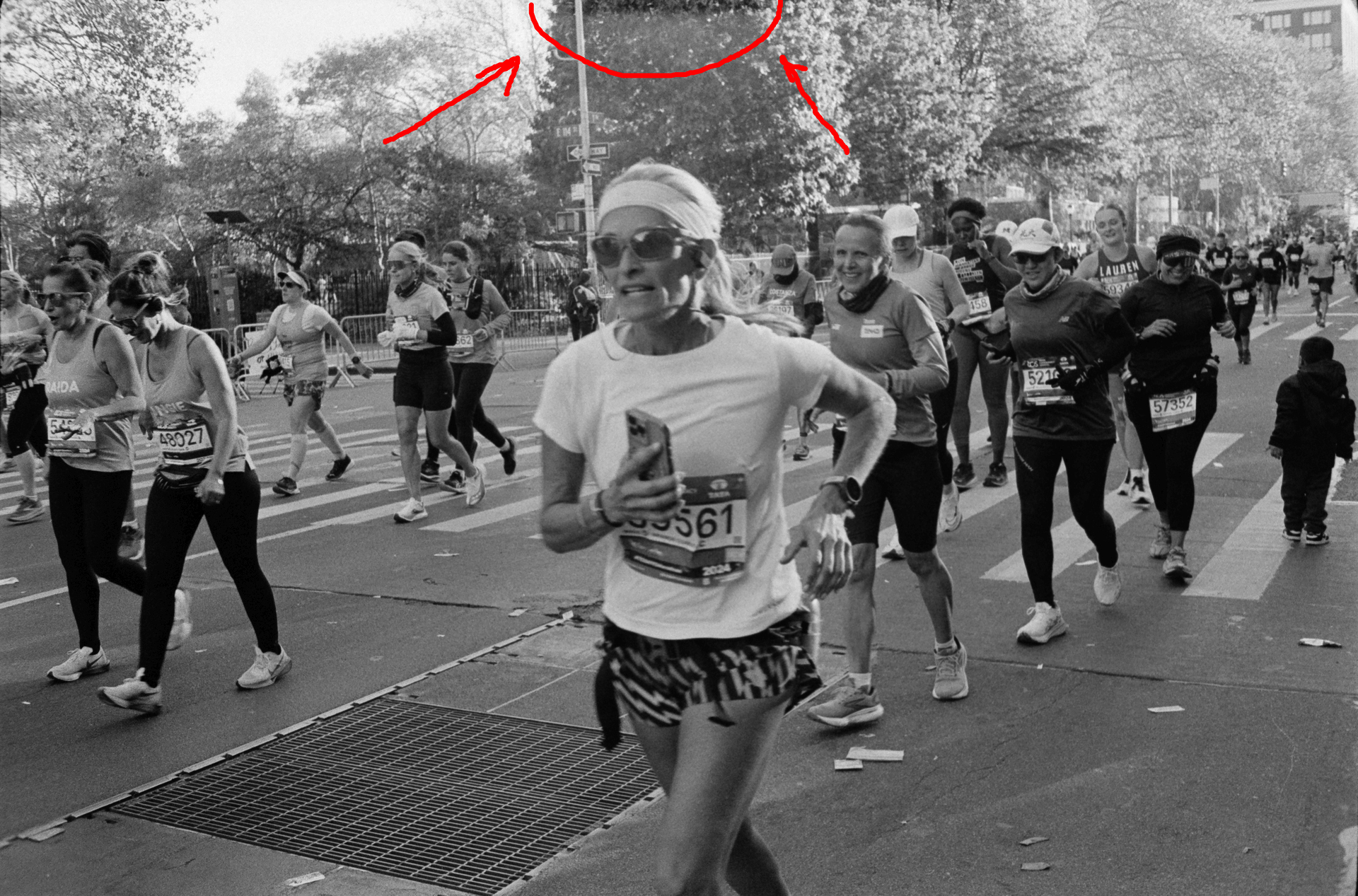

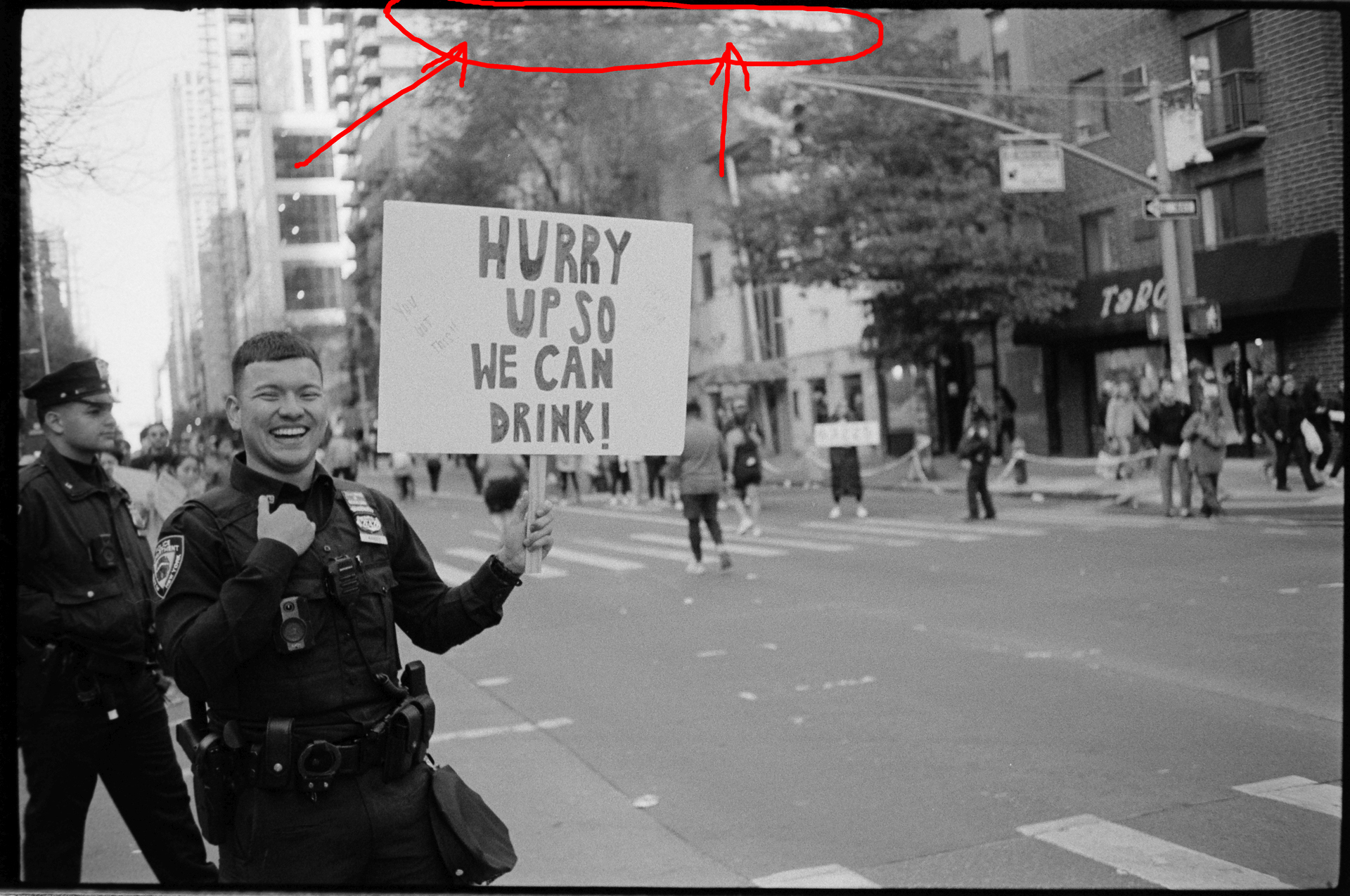

I've stumble upon this thread recently, where I've also seem to have a very similar light leak pattern as described by @c41
I've shot my first roll with a Rollei 35 I picked up from an estate sale
Seems consistent in terms of WHERE the pattern happens, but it doesn't happen with every frame, also when it does appear, some more obvious than other.

But I too have a light leak in mine. It's not in every frame but it is in every roll. Always roughly the same position (top of frame) and always giving a disappointing veiling glare to the image.
It's the gap where there is no problem at the top of the frame, always with a clear horizontal definition, that makes me think perhaps it's mechanical - light leak in the barrel or back or something?

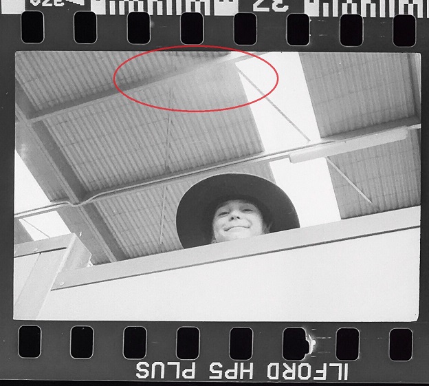

Here's a good example of it, my daughter (the problem circled in red.)
Another example in colour, the same line at the top of frame visible..
Can anyone tell me what is causing it as this camera is just the best in all other regards.

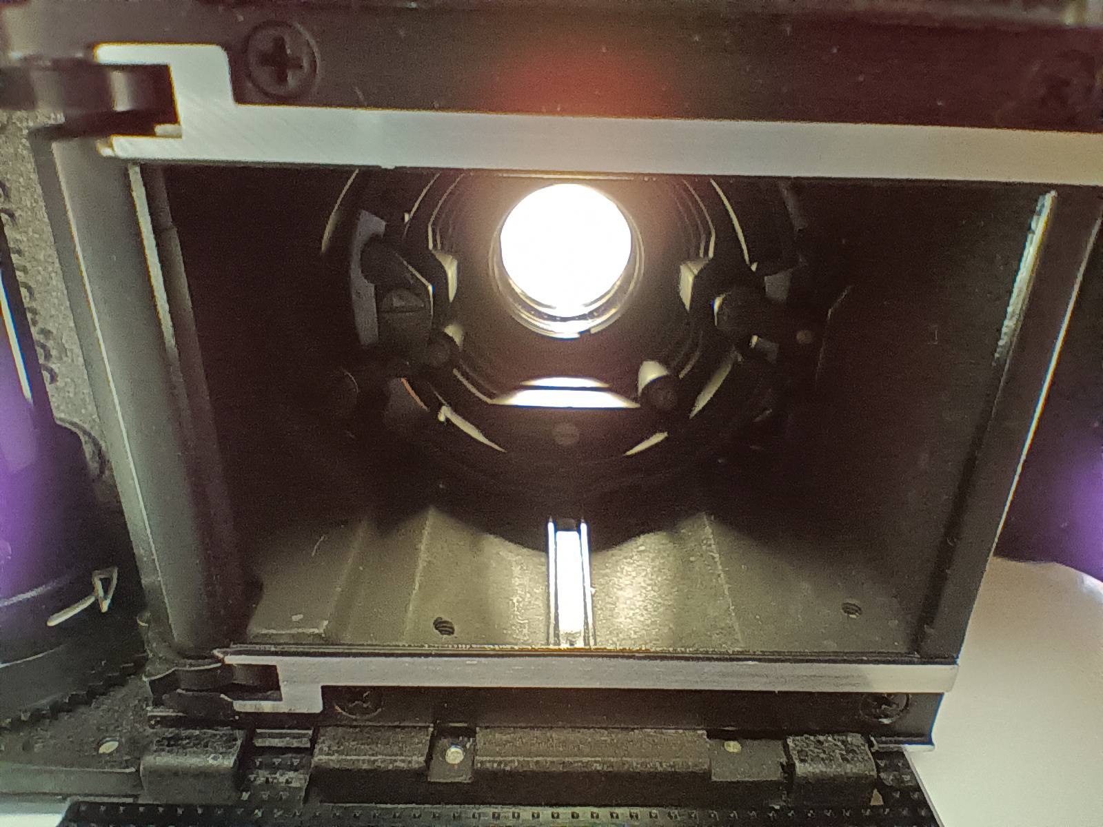

If you have a black plastic bag, you could cut a hole in it just large enough for the lens to stick out and then reach in and snap off a few frames at infinite or whatever and get some sky in. That would at least tell you whether the leak is an internal reflection or light coming in from the outside somehow.

I had the same issue. It was fixed by the shop. They replaced the rail. I don't know weather it is possible to paint it without causing new issues.

I'm guessing its a Rollei 35-specialized part and not a generic/common, guess I should also be on the look out for spare rails on ebay as well. I don't think there are any repair shop in the US that specializes in Rollei 35 cameras - at last I checked...
