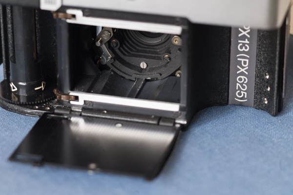

    I had my Rollei 35S serviced by "Arlüwa Czens" http://www.arluewa.de just a few weeks ago. He showed me before the service that the small metal sliding rail at the bottom of the lens track was worn-out and no longer blackened and mentioned that this might have led to flares in the images. In fact I observed some in the past (see for example https://www.photrio.com/forum/media/boston-summer-slides.43376/ at the top of the image) when I had the camera in landscape orientation with a bright light just above the frame - which fits to his explanation. I still am shooting the first film inside the camera after the service (in which the rail was reworked and blackened again). If I think of it, I will try to include some images under these "flare" conditions to check if the flares have reduced now.

    I think I include the mentioned image with the flare on top, so that @c41 can see it outside the "media" pages - even though subscribing would be a great idea ;-)
    Best regards, Heinz

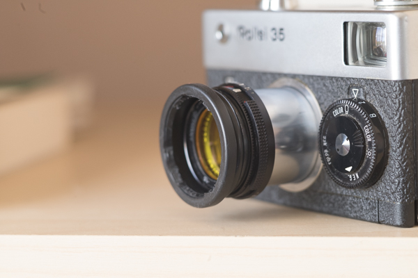

    I had a good look inside and the mechanism looks OK. There is some wear on the bottom rail and I can, with a lot of contortion, at just the right angle, view light when holding the extended lens from behind with a light in front.
    Here is a shot with the lens extended.
    I guess now my next choice is to a) live with it, b) repair it or c) sell it.
    Option A doesn't appeal, it is spoiling too many pictures.
    Option C isn't appealing either. I pass the problem on and now I have to find another one that may or may not have the same (or another) problem.
    Option B I suppose but I worry it might be 'good money after bad', my repair experiences here in Australia have been mixed. I'm very keen to see how you get on Heinz.
    FWIW I did at least discover that a hollowed out 35mm film cartridge lid makes a perfect lens hood. (My filters don't have front threads to use a threaded one.)
