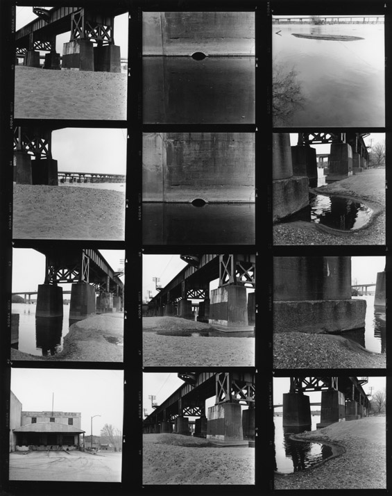

Thomas - sorry about my late reply also, had to find this scan. This is a contact sheet I did last year:
Trix120 , Rodinal 1:50 72F, 3 min presoak, 30sec agitation, then stand for 18min, agitating 30 sec every 6 minutes. I made 420ml of developer to allow enough room for the solution to move around during agitation, and put a spacer in the tank to keep it from shifting up and down during agitations - I've had surge from this before.)
Looking back, greater dilution (1:200, as you suggest), with more initial agitation (I think Sandy King recommends 2 min with Pyrocat), then maybe no more intermittent agitations might be better.
I just banged some shots off to create an exposed roll. The bottom of the reel is to the left. When I load the reel, I take the film completely off of the paper backing, and lead into the real with the taped end. The beginning of the roll is the bottom left, then up and over, so the bottom exposures are #1, #5, & #9.
You can see varying amounts of surge on the right side of nearly all images, and even on the left (bottom of the reel) on 3, 5, and 6.
I had similar results with normal agitation (beginning for 30 sec, then 5-10 sec every 45 seconds) for total of 12 minutes.
Also, I've had none of these problems ever with HC110, stand or normal.
