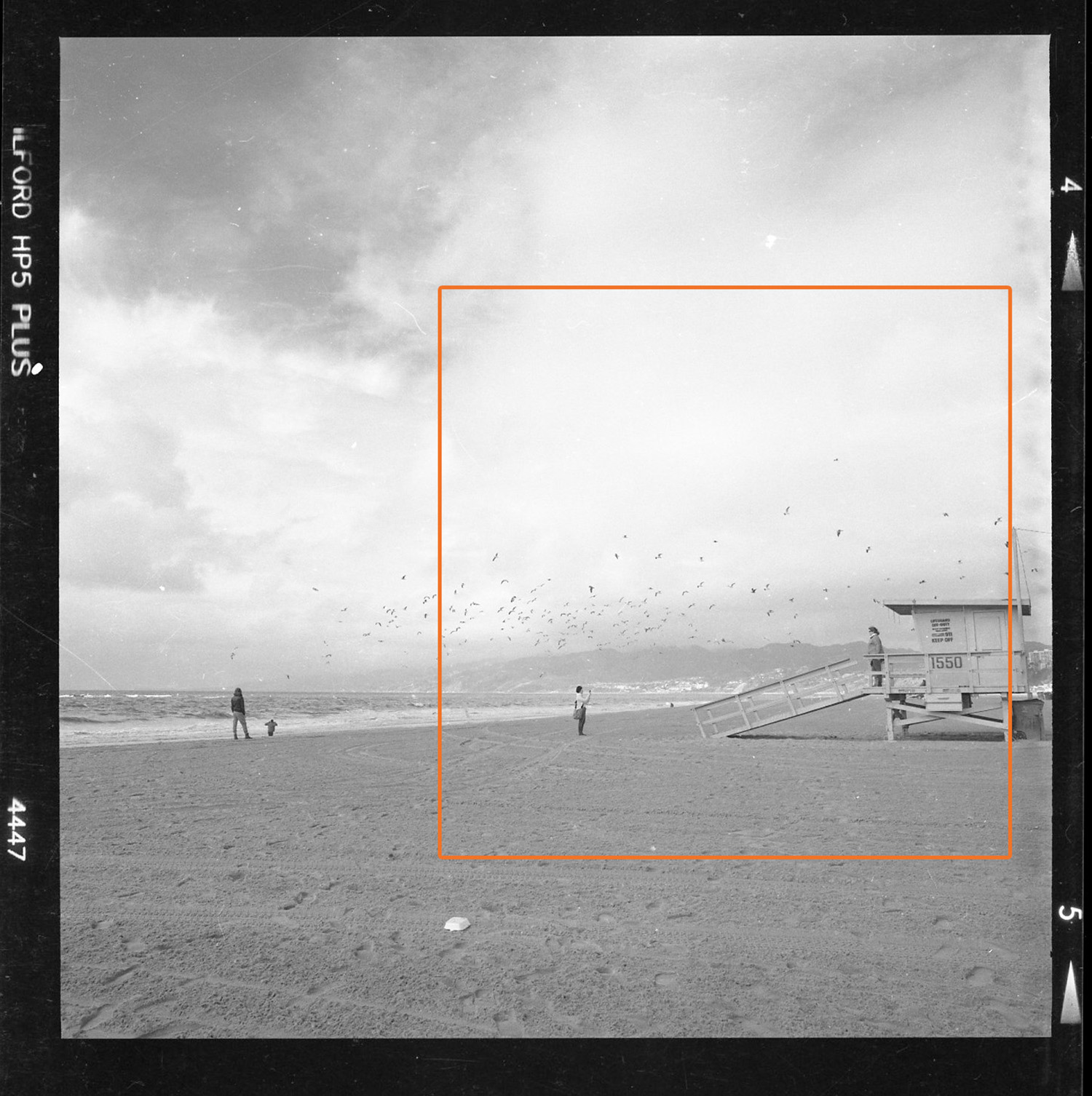

Thank you for trying to answer my question! Sorry but I'm having trouble interpreting the quoted part. I do not know what 2-1/4 negative means and what portion of it was cropped. Let me ask this: how big is the negative area (in mm) the uploaded image maps to? Thanks.
2-1/4 refers to 6x6. Here is the crop that was made:

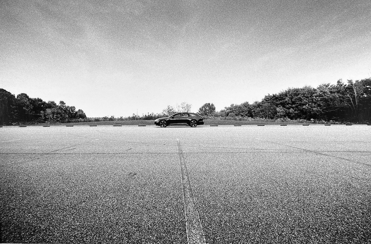

If one wants to emphasize grain in a print, decrease development and print on higher contrast paper. Here is a good example, this is HP5/Tmax Dev printed on Ilford MG FB, probably around 4.5 filtration.

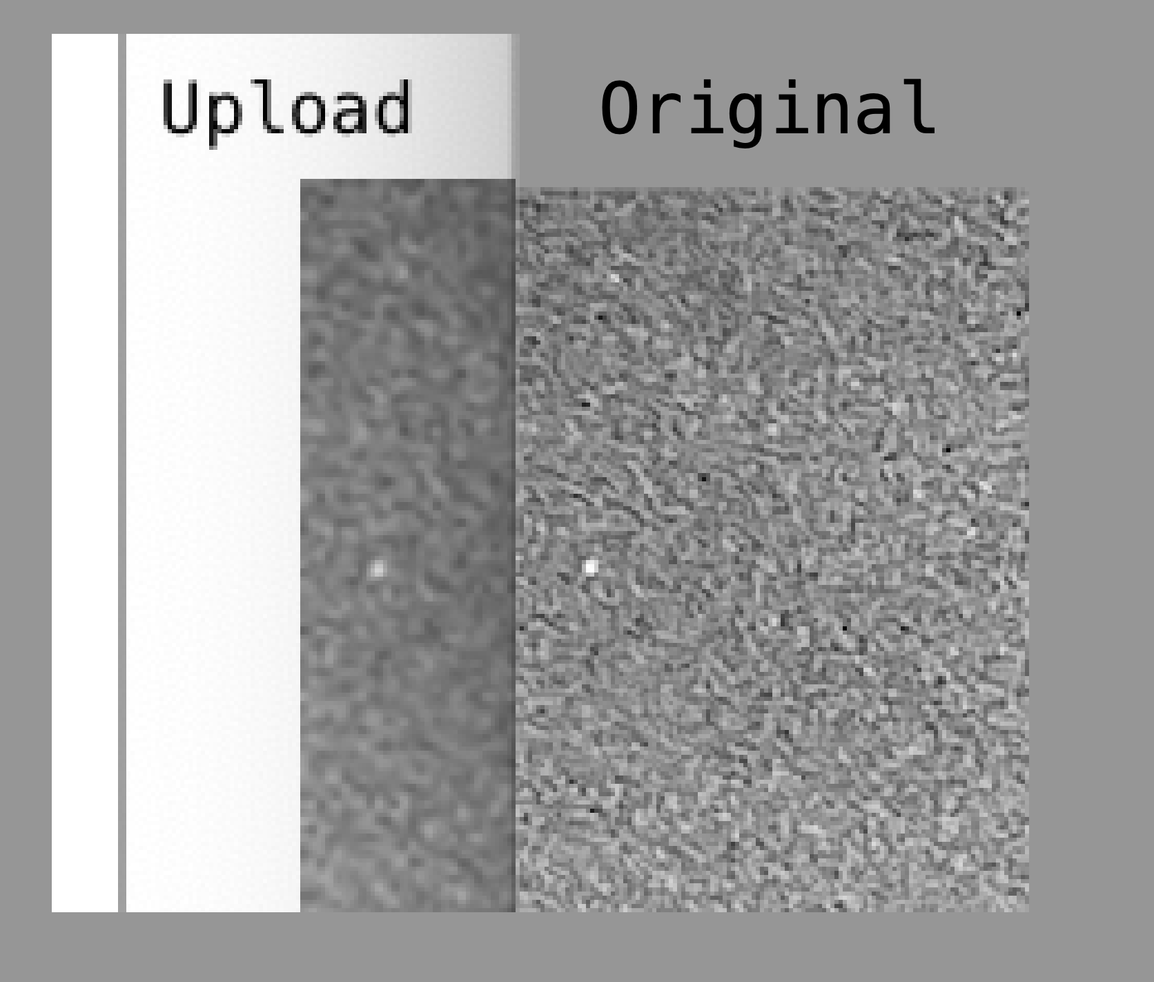

One problem with this forum is that images are softened when uploaded, so the grain (and all other details) are lost. This is a screen shot of the upper right corner of the image I just uploaded, compared to the original file. One reason I'm not so keen to upload my work; it gets destroyed in the process.
I suspect the same is happening with Aparat's posts above.

Thank you for posting this! I meant to point that out earlier, but forgot. I noticed the same thing happening when I link a Flickr image. I first noticed it with some of the great photographs posted by others on the forum. It seems that Flickr uses a really low-resolution jpg file for these embedded images. If anyone wants to look at the original, I make them available on the Flickr page at 3600 dpi, if you click on the image link. Otherwise, judging detail like grain is unreliable, I agree.
I really like the sense of perspective in the photograph you showed. It seems like a combination of a wide angle lens and excellent printing job. The eye is drawn to middle of the frame, right down the white line on the pavement. It's a really cool effect.

In the original the grain of the film blends in with the texture of the asphalt. It helps the eye into the image.
