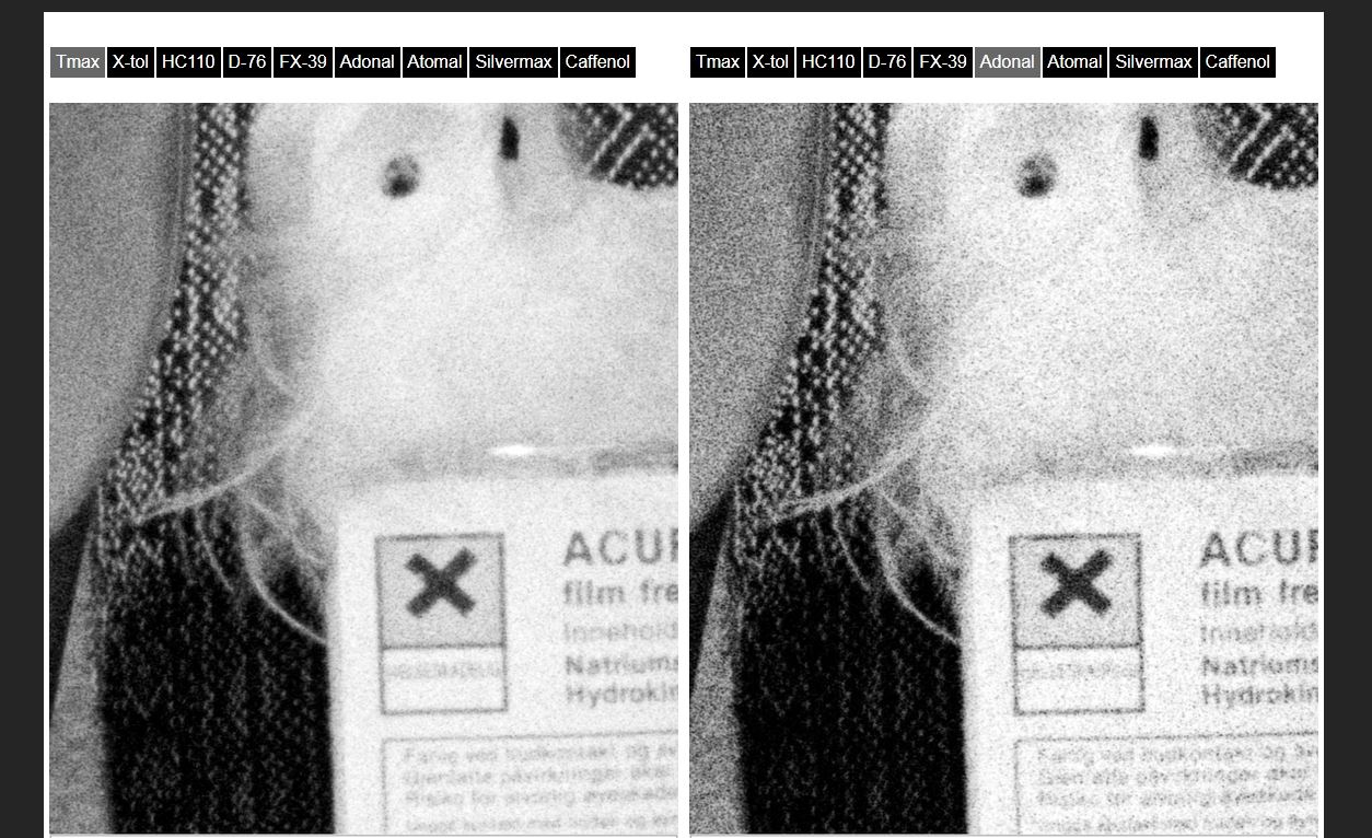

Take a look at this website, he has done many comparisons of films in different developers, and you can have the two panels side by side to show the developers side by side. You can see a noticeable difference in the grain between Adonal ( Rodinal) and D76 for example. You can also see the speed loss on the curves below the enlargement.
Here is HP5: https://fotoimport.no/filmHP5

Take look at this side by side comparison of Tri-X. Developed in Tmax developer on the left, Adonal (Rodinal) on the right. I'd say the grain is different and highly altered by the developer.
