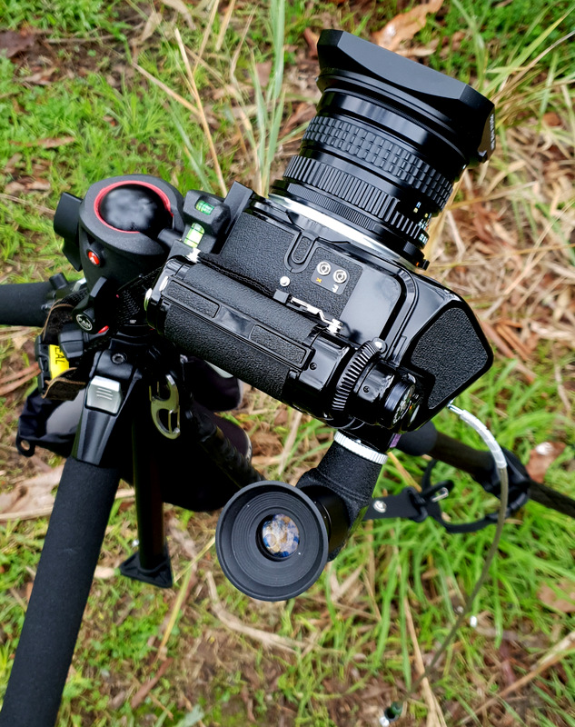

Your anticipated set up is not uncommon (and might even be frowned upon in-shop), but with the camera upside down and the finder angled upward, you will face the dual challenges of adjusting the camera while assuming an awkward, unfamiliar (and very often, testing) viewing position; I did this many years ago and absolutely have avoided that ever since! Right-angle finders are commonly used for situations where the tripod is splayed out, but not right down to ground level; I use my own very often (Pentax 67 [pic] and Canon EOS) so I don't have to crouch down because it is a pain in the back (really!). The lowest I want is near waist level. Putting the camera on a stable resting object at ground level is much simpler an arrangement than using an inverted tripod centre-column.
