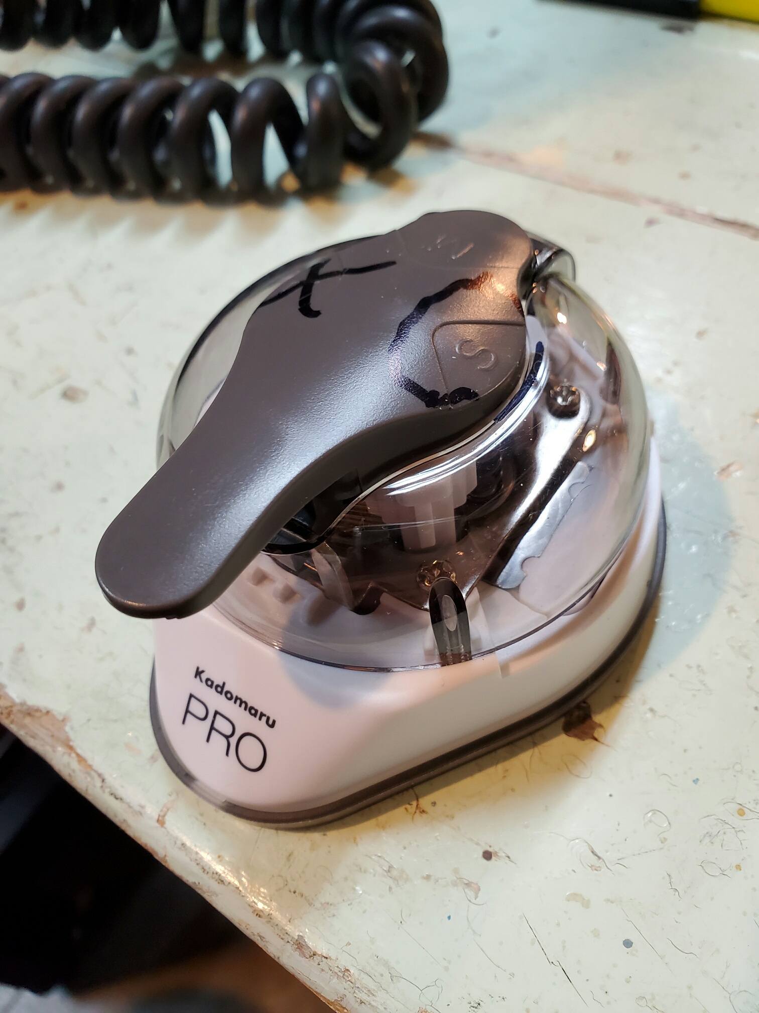

OK, maybe revolutionary is too much. Everyone who's ever loaded 120 film onto a plastic reel has occasionally come upon a stubborn film.
With Jobo especially, "the art of the snips" is of great importance. You need to snip the corners of the leading edge of the 120, (and 35mm) so the film feeds smooth without snagging.
The best snip is a tiny slightly rounded snip. Too big and it makes matters worse.
This leads to old corner rounders for wallet prints for when people actually carried pictures, in their wallets of all places. Pictured below revolutionary tool for snipping tiny round corners. This is the greatest thing since Spenco gel saddles on mountain bikes. Use only the smallest setting makes about a 16th of an inch round snip.

I have really been happy with this little tool.

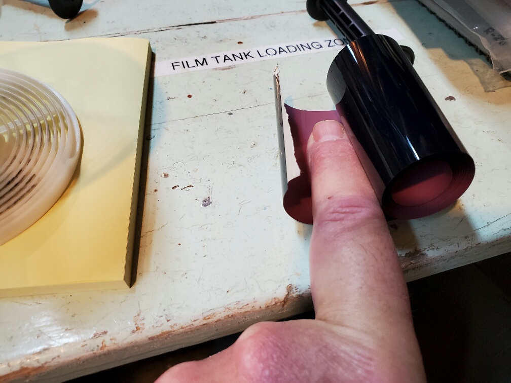

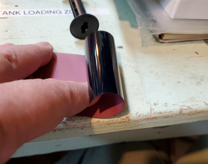

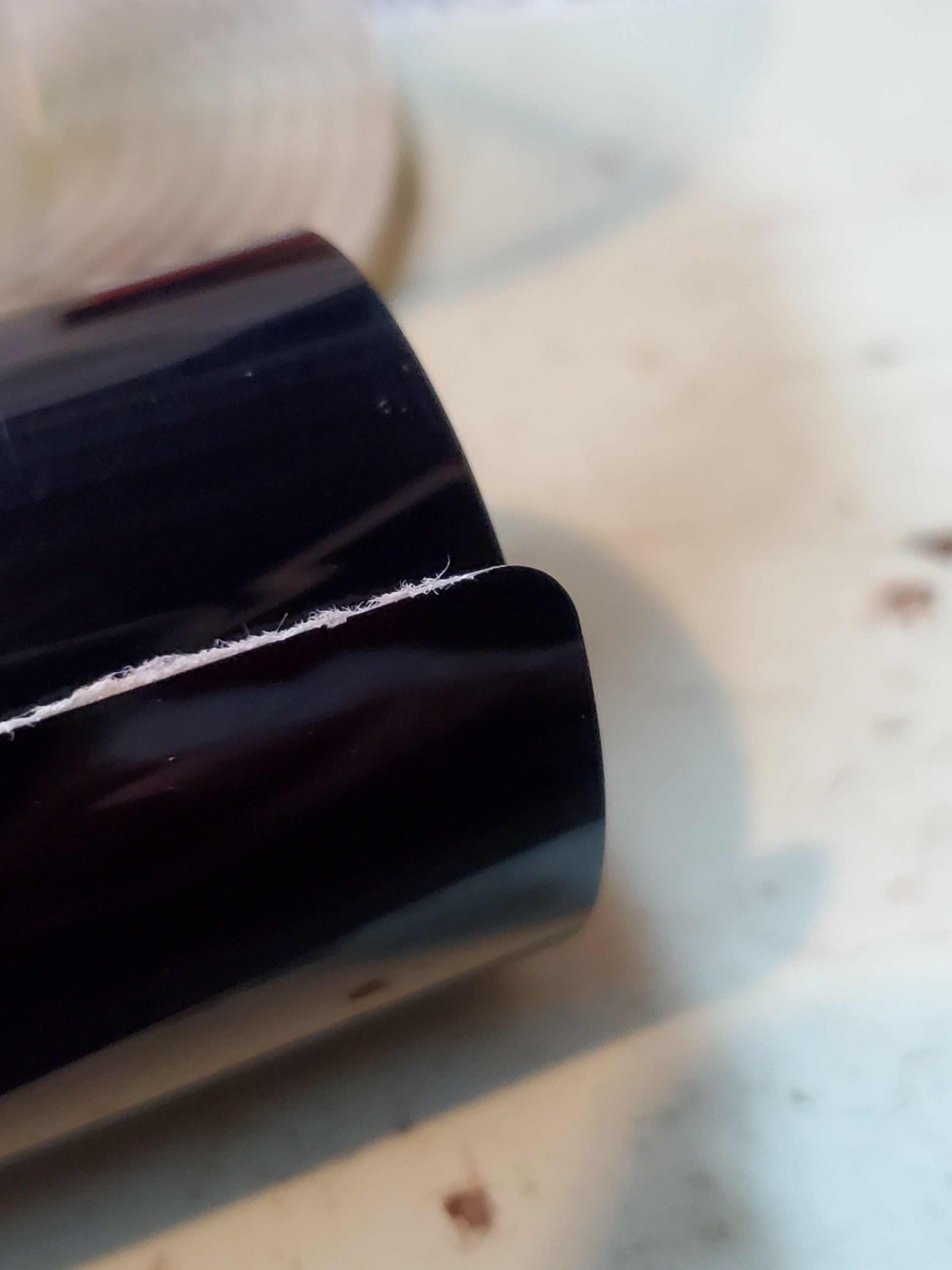

OK FOLKS TEST REPORT (NOT PEER REVIEWED! !)
The way I have been loading plastic reels for the last 40 years is wrong. For some reason I always felt that the tape end should be out. I think as a kid I feared carryover with color chemistry.
1. UNSNIPPED feeding TAPED END FIRST on Jobo. No problem, slid right on, normal occasional snag but it resolved in a second.
2. SNIPPED FEEDING TAPED END FIRST on Jobo reel, WOW the taped end has so much less curl the film stays in the channels. I could hold the reel and simply push the film on. I will no longer fear trying to put two films on a single 1500 series reel. This was the easiest I've ever had a Jobo reel. I could hold the film a rotate the reel, and the film just glided on. Didn't take 20 seconds. I am done complaining about Jobo reels. These are perfect.
3 FOLDING OVER THE TAPE END. I couldn't get the taped, folded end to start or feed on a Jobo reel. HOWEVER on a PATERSON reel it works BRILLIANTLY! I started the film effortlessly onto the Paterson reel, then pulled film past the steel balls. Then the classic Paterson ratcheting, film loaded perfectly. Easiest I've ever loaded 120 onto a Paterson reel!
So thanks to this forum, I re-thought what I was doing. The curl of the taped end is so much less than the spool end that the film stays in the reel channel. It's a dramatic difference. I wasted 2 (May 2020 expir. date) rolls of TMY 2. Best money I've ever spent.
Pictures show corner rounder snipping. Pictures show how much more curl there is at the taped end.
