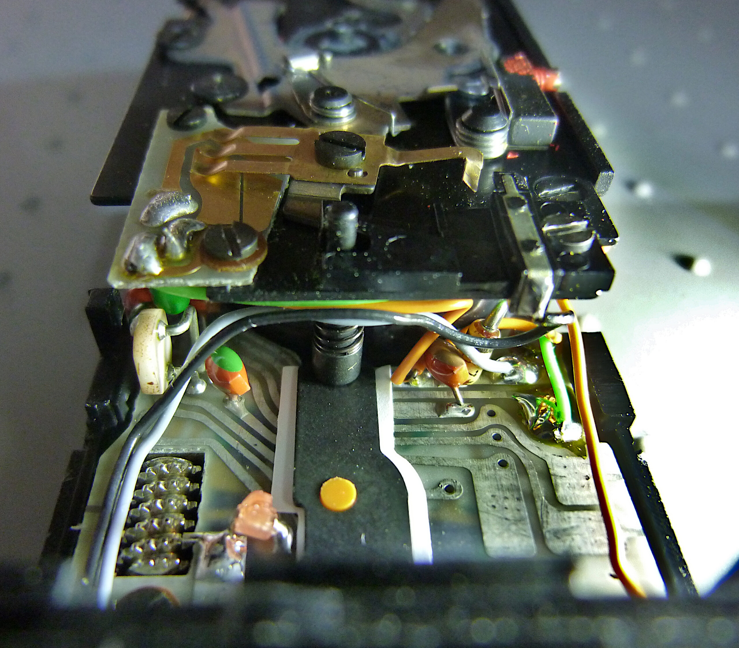

I have brought some Minox EC cameras back to life and it has been a rewarding journey! If an EC camera stops responding, it’s probably the electrics. The usual suspects? Corroded battery contacts and those delicate cable connections. Decades of inactivity can take their toll!
Don’t be intimidated! With a little patience, you can bring these little gems back to life.
I’ve learned that a simple electrical repair can make all the difference, even if the camera looks dead. Now these ECs are shooting photos again, proving that the world’s smallest analog series-produced camera can still shine.
What experiences have you had with your Minox EC?
Here you can find my detailed instructions for beginners with lots of pictures:

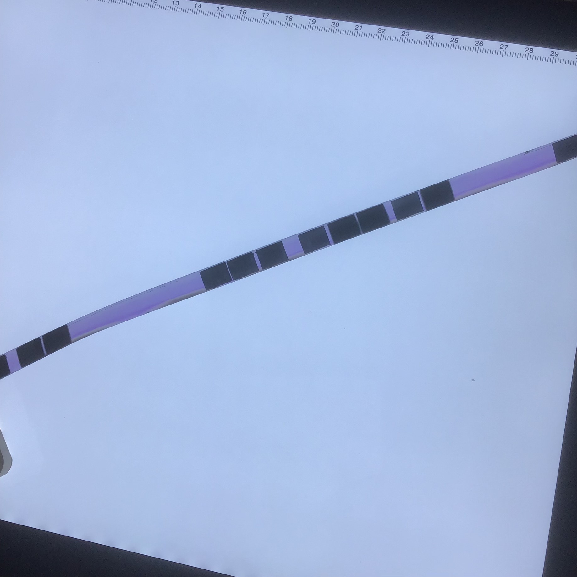

Great potential with these tiny cameras. Shutters are almost silent. But i've never found a good one. My current one has this issue:

As for the negatives, I see that some are completely overexposed and some are completely underexposed, right? But the camera gets power, so the LED in the viewfinder lights up?
Yes, camera gets power. On some rolls, the frames are correctly exposed but always the large blank sections. I suspect the shutter isn't opening - a classic problem with Minox 35 cameras, you hear the shutter but get nothing. Disappointing and I've given up on the EC after never finding a reliable one.
