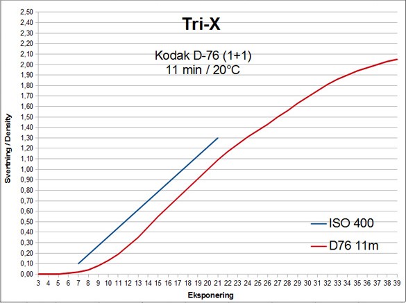

Andy, next time shoot your 400TX at EI 200, then develop it in D-76 1+1. Enjoy all the shadow luminosity you prefer and don't worry much about highlights burning out. See attached curve from fotoimport.no.

At the foot of this interesting discussion, it's worth remembering that it all began because of the differences in shadow detail in Andy's examples—shot in his camera and developed by him in his developer, one 400 film had more than the other!
And what does one take away from that? What conclusions, if any, can be drawn from the examples?
My take away is that in this case Tri-X had lower shadow speed than HP5+.
But "in this case" has lots of interesting variables like, this developer, this scene spectral content, this agitation scheme, and so forth.
Like you, I find Tri-X shadow speed to realistically be more like EI 200. But that's also how I expose HP5+, at least for conventional development and agitation methods. When I semistand or EMA process these films, use use ISO speed as my EI.
