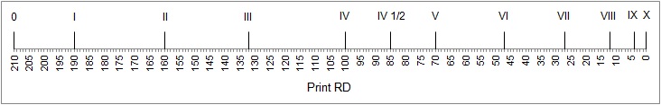

Here's the official answer - just kidding - actually I don't remember exactly how I did this - I think it was based on some of Jack Holm's work.
