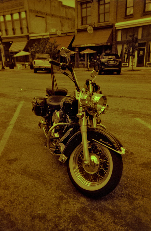

I tried this over the weekend. This is "preflash" "predev" or "prebath" with PA Rodinal 1:100 for 10 minutes, c-41 for 3:15 minutes, bleach bypass, and fix for 8 minutes in Ilford Hypam 1:4 with continuous agitation. The basic negative, which is mostly bronze, is gorgeous. The color balances out nicely as well. That is the raw scan processed in photoshop. I like either/both of these I think the glowing bronze is beautiful and requires the color process, and the silver retention. The color scan may actually be pushed a little - expired from 2009 250D shot at 250.
