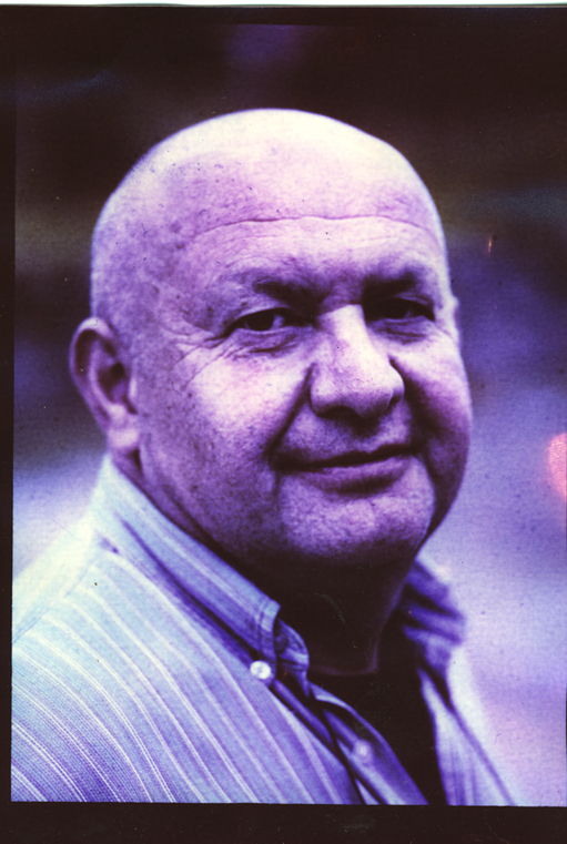

That is my today result Irakli-test.jpg it is too violet I need to use filters like normal RA4 process or I need write exposure and then colour become normal ? I don't know it because I never print Cibachrome only RA4. About My blix I don't know I redevelop in original Fuji blix my one picture and it isn't going better. Maybe my BLIX almost dead but stil works for normal RA4 process but whith this process it doesn't works normal. By the way it is very good test whith BW developer and BLIX You at once see Your blix is dead or not.

Remove Cyan and Magenta to fix this up. Start by removing 10C and 20M to see how it works. The picture appears too blue/magenta on my monitor.
A failed blix with normal RA4 processing will seem to work but will give dull colors. With this reversal process it will give very bad overall gray images.

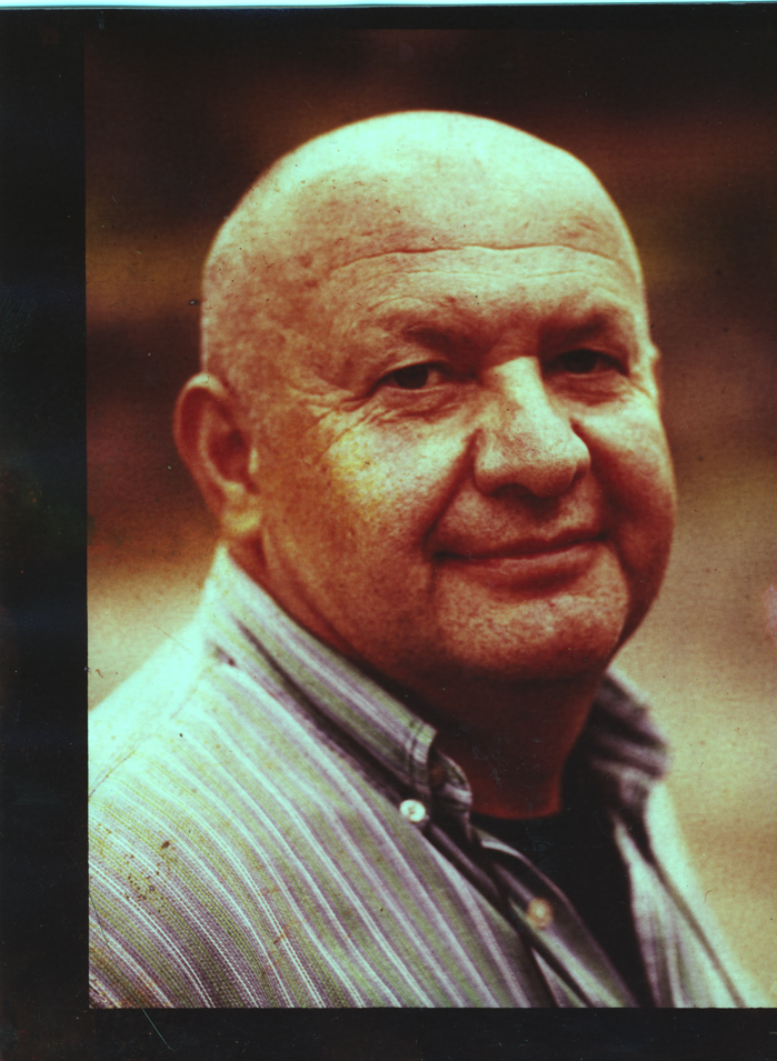

I am almost understand how it works. My today best result Irakli-test-III.jpg at now I understand why ciba prints was so expensive You need to do very much test prints to get great result. I try to mix Your developer 1 / 3 and I think it works better. Developer Works like soft working developer and I can get soft "grey" BW neg. For normal BW process this kind of neg is awful because very hard to get normal BW print but for this process it works great. Tomorrow I try mix developer 1/4 and I do many Re-exposure test and I think then longer Re-ex time than better and colourful print You can get but I not shore yet I check it tomorrow.

Now it seems that you have reached the "typical" point in Reversal RA-4.
As stated by Photo Engineer many times, portraits just do not look very good in this process.
It is difficult to get clean highlights, they always seem to end up cyan and/or yellow and you cannot correct them with filtration. This one seems to have both cyan and yellow cast in highlights.
OTOH, if you print a scenery, different color casts in areas of different brightness may not be bad thing at all, but cyan or green foreheads do not look very appealing.
You can try to do two things to try to clear highlights: (1) reduce the amount of bromide in FD, (2) add some sodium thiosulphate to FD.
If I get back to this process, I am planning to try three things: (1) softer (lower contrast) first developers (maybe including 2-bath developers), (2) using thiocyanate in FD, instead of / in addition to thiosulphate, (3) using SLIMT (latent image ferricyanide bleaching pre-FD).
