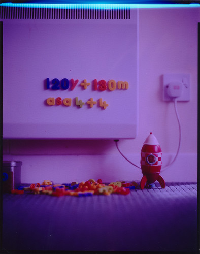

Just a brief update. Having run through another iteration of this I'm finally just about there.
This is the most acceptable of the filtering/exposure bracketing from the last few I did. Exposure and filtering data is contained in the picture, sort of like a proto-EXIF :D
So, from messing around with the scan in PS, it think it needs a touch (maybe 20 or so) less magenta and maybe a smidgeon more yellow. Plus another 1/2 stop or so. I shot another at 6 under asa 4 and it was quite overexposed, so I reckon the combination of losing some of the magenta and another 1/2 stop or so should put it in the ballpark.
Funnily enough, having re-read Bujor B's posts on photo.net again the other day, I've come close to just duplicating his data. But where's the fun in just copying someone elses findings, eh ? :D

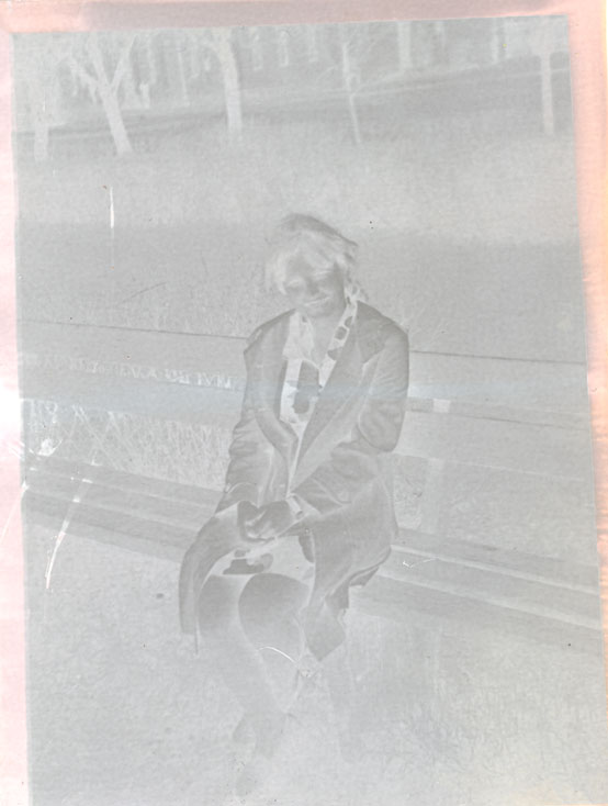

I tried Reversal RA4 on Fuji crystal archive paper and I can't get colour positive. 1 bw developer work's great and I get normal BW image but after that I wash the image pre flash it with 60 watt bulb for 2 min> And after that put image in the colour developer (developer I use is Fujifilm enviriprint MP160) and nothing happens. What is my mistake ? Developer is fresh and when I put to the developer sheet of RA4 paper on light it became black. I can get BW image with looks that мама-4.jpg but in color developer nothing hannend

I have no idea. I have never used the Fuji chemistry, but it should work. If you overexpose, there will be no color image. And, remember, to test this out you must bleach and fix or blix the image.

Today I receive first colour positive picture the colours is worst but it is USSR made slide from middle 70 it is picture of my mum. Now I try to get picture from normal colour slide. If I understand write my problem was bad washing. After stop picture need to be washed in fresh running water for 5 or 10 minutes. I try to use 3 rinse wash (each 3 min) in Jobo processor but it is doesn't work it need to be removed from the drum and wash in fresh running water. Fuji paper and chemicals works but rinse is main problem now. Maybe someone have some idea.
