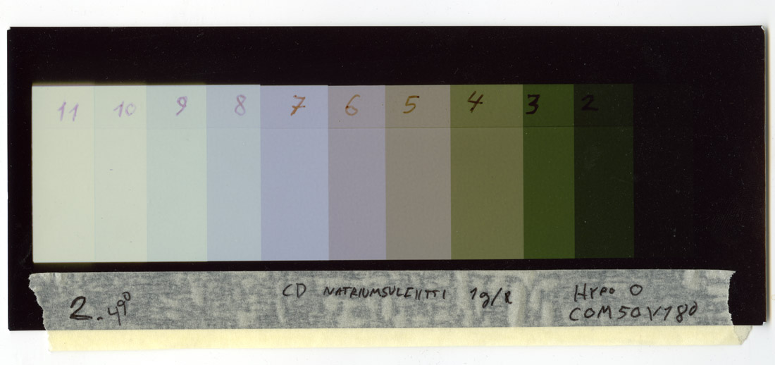

What we want, is a tone scale of about 3.0...3.3 D, or 10 to 11 stops. This is about the tone scale of slides, and has to include the toe and shoulder of the paper to get proper white and black. Some compression of toe and shoulder is inevitable and present in Ilfochrome printing also. So, in practice, we might want to sacrifice some shadow&highlight detail to get more contrast in these areas, so, maybe a tone scale of 2.7D or 9 stops would be quite good for a paper.
I've found that the tone scale of RA-4 paper when reversal processed is about 10-11 stops! It is definitely not too "high in contrast"; but the real problem is the curve shape.
I'll go later to these step wedge tests, but this first example is to show the tone scale problem.

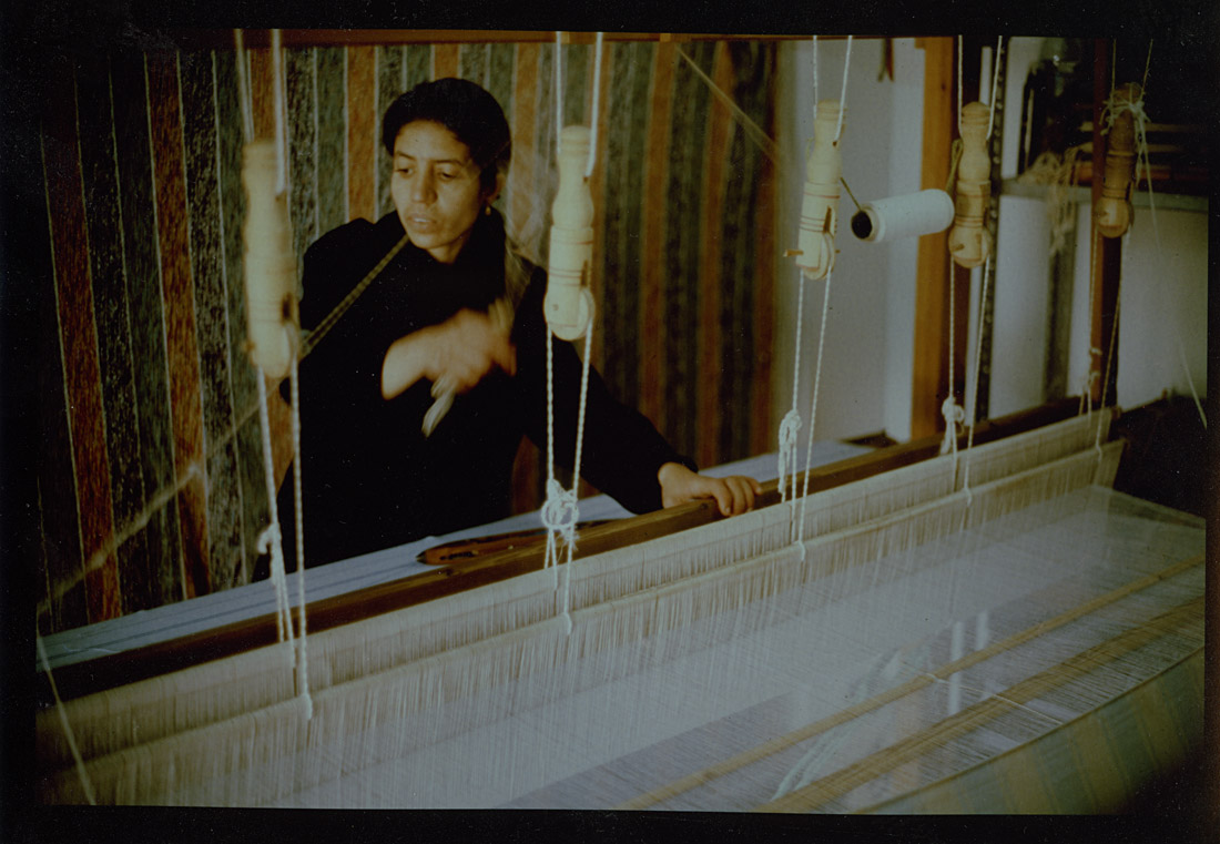

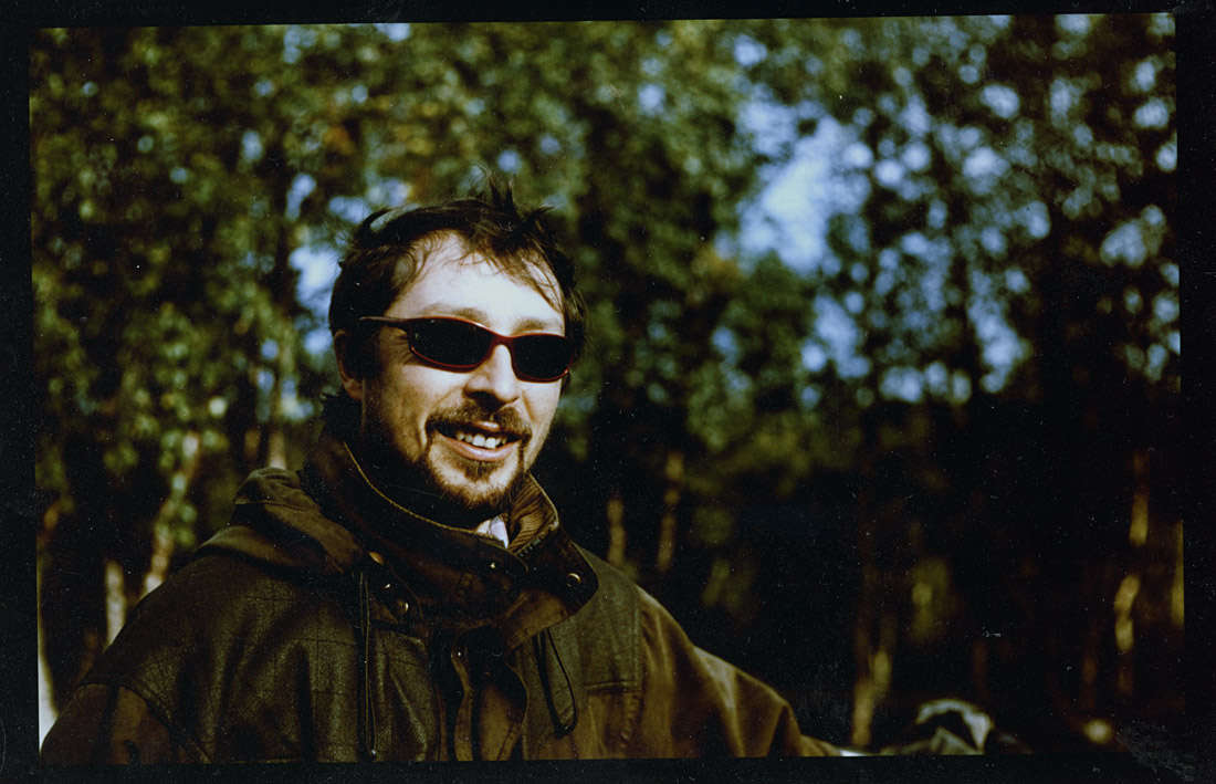

(Sensia 100.) Some of the first experiments. Print number 25 after many modifications.
Quite good, but shows the cyan forehead problem.
First dev: Agfa Neutol 1+3 (normal dilution is 1+7) with 20% of a medium-sized hypo crystal in 500 ml (didn't have scales at that time), 3min30sec
CD: Normal
Filtration: C17 M0 Y140 (on Fujimoto, normal neg filtration about C0 M50 Y100)

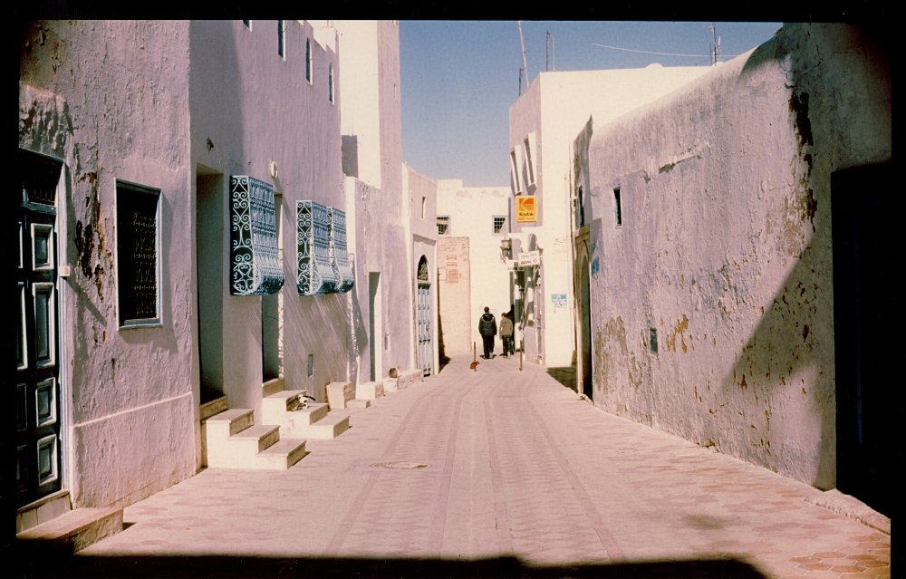

(Sensia 100) Newer experimentation with much less work.
First dev: Dektol 1+2,5 (about normal dilution), no modifications, 2min.
CD: Normal
Filtration: Might have been about C0M50Y180.
So, as you can see, using different first developers affect greatly to the filtration!

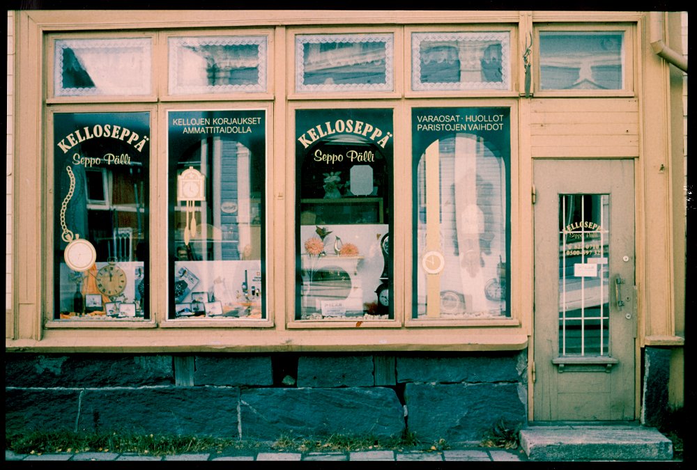

(Velvia 50.) Experimentation with added hydroquinone.
First dev: Neutol 1+3 with huge loads of HQ (I have the amount down somewhere but it is around 30-40 g/liter!!!)
CD: Normal
Filtration: C3 M0 Y146
(Sensia 100.)
Same first dev as in the previous example. Quite good. A little cyan problem and the whites could be a little more white, but if exposure is added, they go too low-contrast.

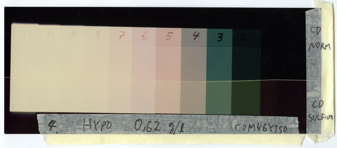

In your first step wedge, not enough cyan silver is developed in the first developer, and so too much dye is formed in the color developer giving a cyanish colored toe. This is probably due to the bromide inhibiting the cyan layer developing to completion, which should take place evenly in all 3 layers to make a neutral. Some silver halide solvent in the developer might help along with lower bromide.

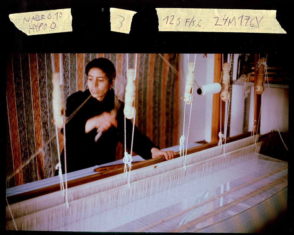

Okay, what I did. Yes, I made my own first developer, a non-bromide "Dektol". I found out, however, that a little bromide is needed, and a little amount of hypo is good.
So, this is my current formula:
FD (add in this order, stirring at every step until dissolved):
Start with: Water 500 ml
Metol 3 g
Sodium sulphite 45 g
Hydroquinone 12 g
Sodium carbonate (monohydrate 80 g) (or 68,4 g anhydrous)
(I replaced 5,1 grams for bicarbonate because I haven't enough carbonate :tongue:)
Potassium bromide 0.20 g (the original "dektol" type formula asks for 2 g!!)
Sodium thiosulphate pentahydrate 0.20 g
Water to 1 liter
Dilute 1:1 before using. Develop 1 min 30 sec at 23C.
CD
Normal RA-4 dev with added sodium sulfite 0,50 g/l (0,80 g/l could be even better).
Adding more hypo increases contrast and clips highlights and shifts highlights towards yellow, and vice versa. This current value seems to give nice whites, not yellowish nor bluish, while allowing to adjust yellow filtering to get quite neutral shadows at blue-yellow axis.
No hypo, tried to balance colors. (I could select between bluish highlights or yellowish shadows)
Hypo 0,20 g/l, tried to balance colors. (Now I could select between bluish shadows or yellowish highlights). And too high contrast.
These results led me to take the hypo concentration between 0,20 g/l and 0,00 g/l: 0,10 g/l.
Decreasing bromide may give even whiter whites, but may quickly lead to very bad DMAX. I added 1/10 of the "dektol" formula's bromide and expected to see some change, but DMAX went straight to black. Well, that was the objective :smile:.

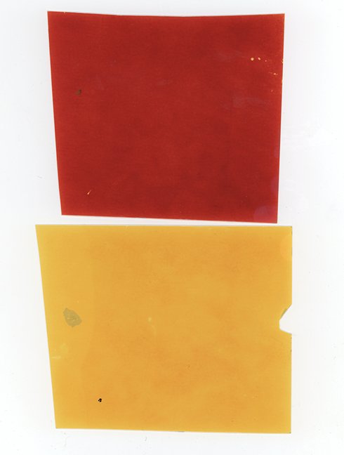

Effect of no bromide at all - unexposed sheet - should be black. The first one without hypo and the yellow one with 0,20 g/l hypo (double compared to the final formula)
Stand development (2 min 15 sec total; 45 seconds agitation first and then 1 min 30 sec completely standing) helps manage the contrast a little bit, boosting the shadows a little and restraining highlights.

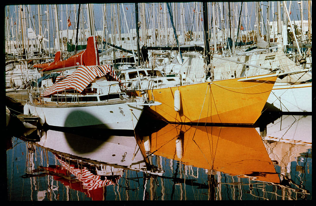

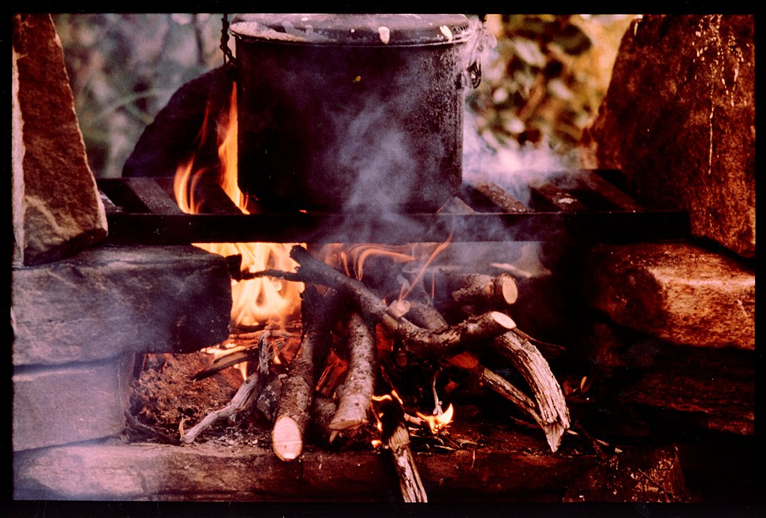

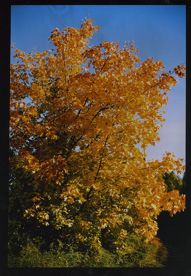

And then, some more pictures. These are all quickly made, without bracketing exposure or filtering!
AHH, whites!
I like the green crossover, this is originally quite a dull image, I used long ago expired Agfa slide that has gone yellowish.
Ahh! The flame is not clipped.

I did som reversal RA-4 experiments a couple of months ago. It worked, but the results were not that great.
After I have seen your pictures I will sure try again, as I have a fair amount of slides that i would like to print.
