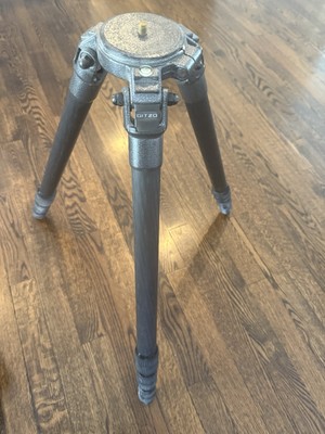

Just to reinforce...
Gitzo 1348 with the flat plate.
another one (may have been sold, it doesn't say)
Here are the specs for this (Page 5 at the bottom):
And for the granddaddy resource of them all from 1998 (Page 425):
There are several center columns that will fit it, but the one that was sold with the tripod to make it a G1349 was made with CF as well (called the G1318), whereas many of the other ones weren't (the geared ones weren't, and some of the rapid ones weren't as well.
With the 4-segment legs of the G1348/1349 legset, I basically only use the bottom leg sections when I'm on uneven ground (and I'm 5'-9" or so) because the head you choose adds at least a few inches and possibly up to about 6" to the height. Plus the camera.
