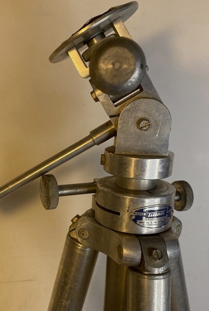

from ebay
Those are all machined parts, not cast - no plastic. It's just a totally practical design. But it's not a good choice for a large camera.
And I'd hardly call it the "star" of this thread. Has anyone actually recommended it for large format? It's been mentioned mostly in passing.

The only significance of the Leitz association is they didn't put their name on crap at that time. Not so sure about since then. The association is not a reason to buy it. This isn't "flimsy"
View attachment 395044from ebay

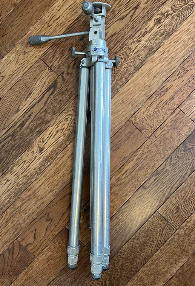

The Tiltall is a contender for sure. D@mn, I wish I could find that Linhof though…
Graf, I used Tiltalls for years.... I almost bought a Linhof once...it was somewhat lighter...but then i saw one with the channel leg..bent...& broken. The tube is stronger than a U. Currently using a Hollywood Ries & a Gitzo metal....
IMO the Marchioni Tiltalls are a steal at $75 -$100 USD on Ebay.... they'll last your lifetime.
