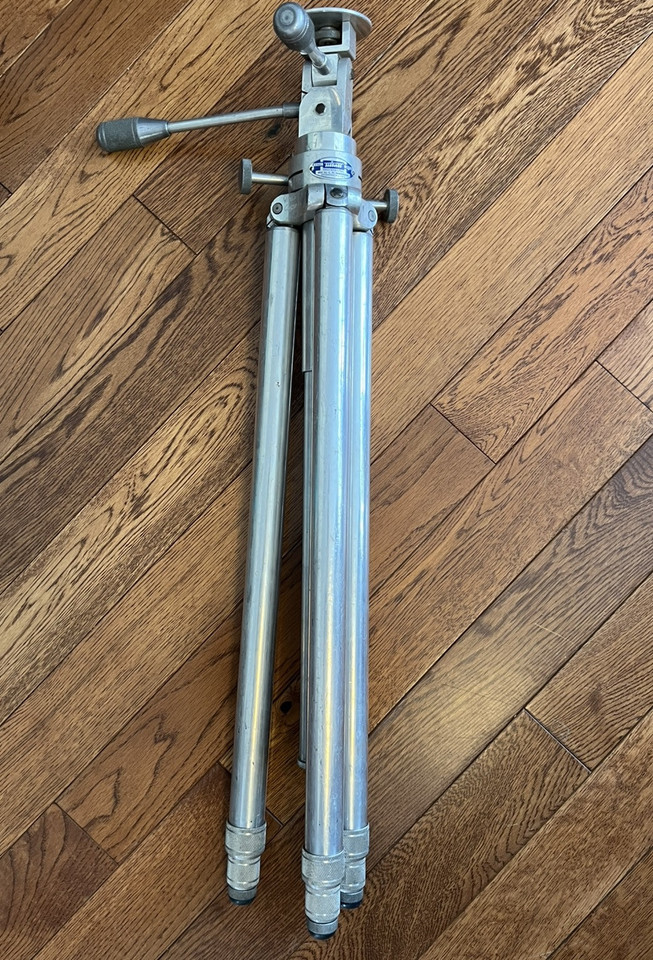

My choice for a large, sturdy, and cheap tripod was a vintage aluminum Tiltall. It's much more stable than my compact Manfrotto travel tripod. I'm able to use a 300mm f/4 Canon FD lens on it with a teleconverter and gimbal. That would be about 5 pounds with the camera. They go for a little under $100. It doesn't have all the fancy features of a newer model.

I will look at the Tiltall as well. Does yours have a model number or anything on it?
