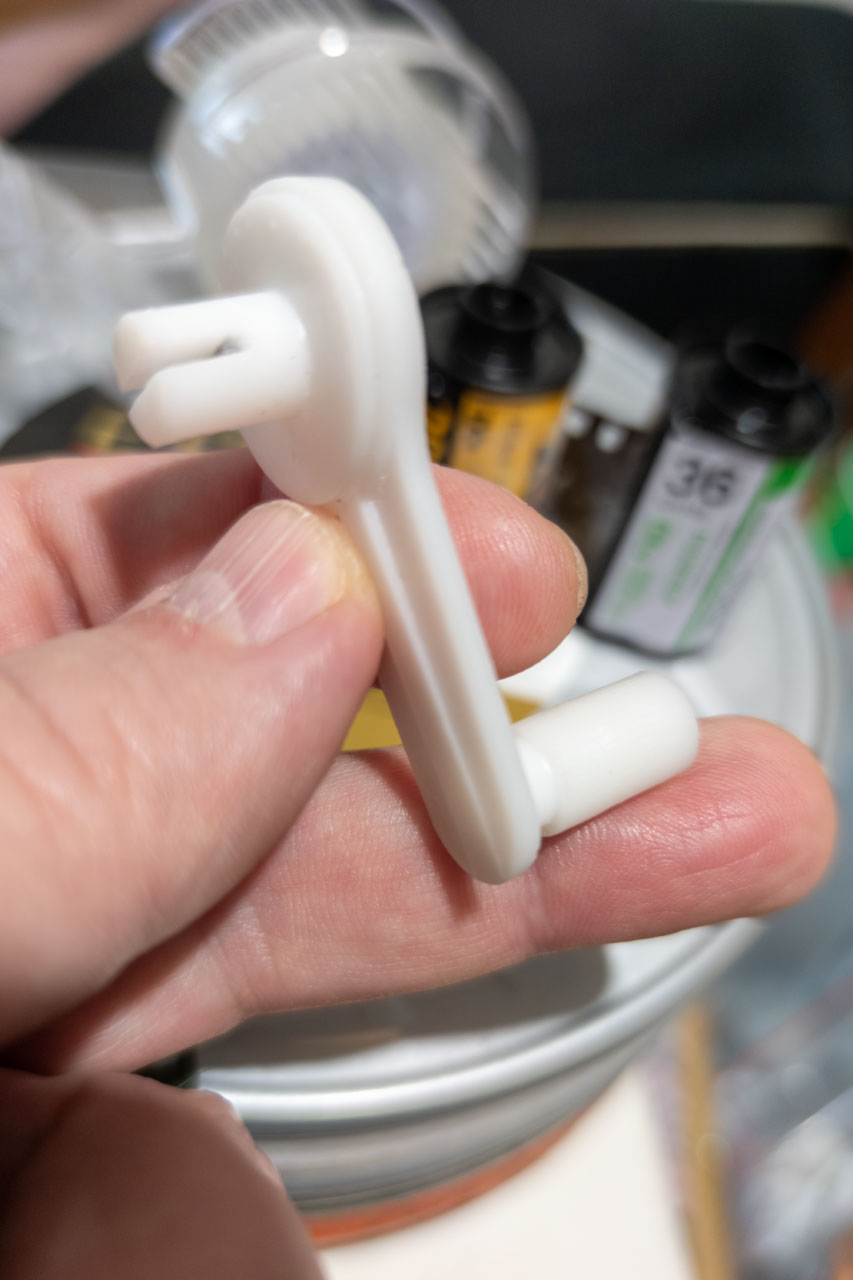

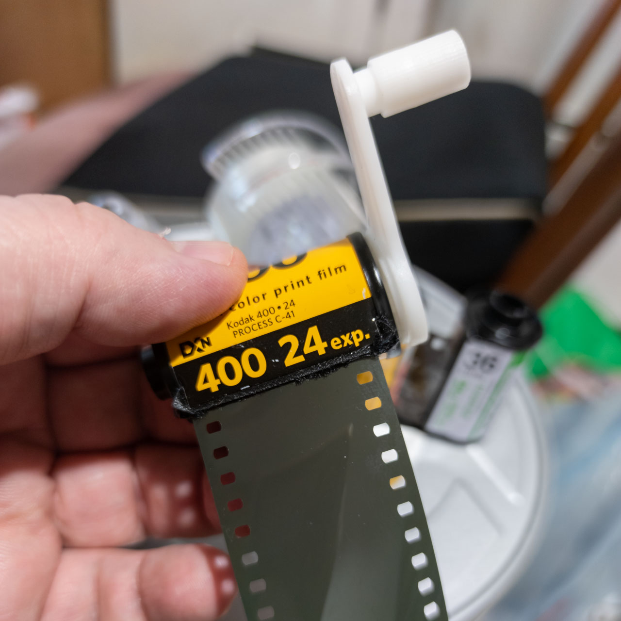

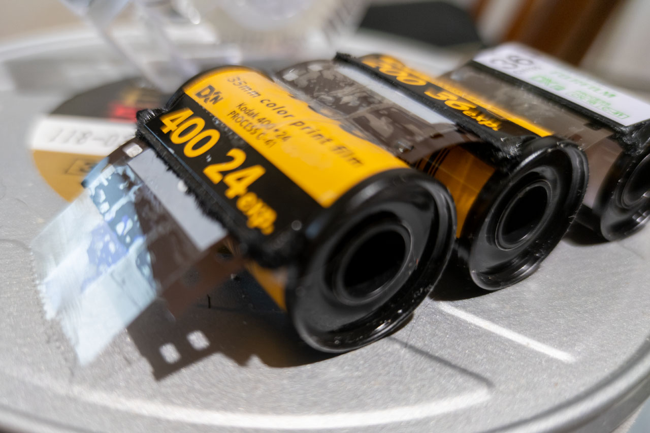

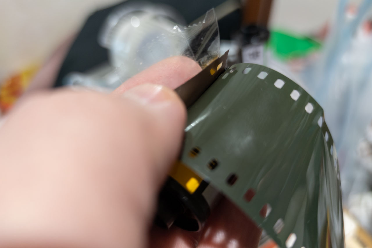

Yes exactly. I use such a crank (example link from eBay). For the frames - I usually do 26-29 full turns. I stop spinning early if it starts to tighten. With 29 turns you can get over 41 shots, usually 27-28 turns are enough for 36 shots.
In order to make my work easier, I prepare in advance in the light - I stick pieces of tape to the leader in the light.
Okay, that sounds good. 10 cartridges with protruding film cost around 14€, I guess that's fair enough.
Look for more ads - for a similar amount you can get a larger number - about 100.
