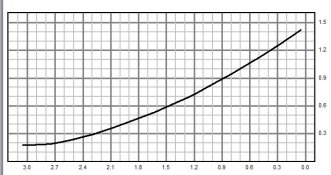

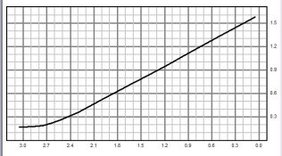

Yes,Mr Crawley did include the curves.While, after the toe, those for TMY, TMY-2 are almost straight, the curve for 400 Delta justs bends gently upwards.He just says it is the nearest to an S-curve.As you say , that does seem to be interpretation.He does mention that it is the full S-curve they give that accounts for the continuing popularity of of traditional grained films such as Tri-X and HP5.
On closer inspection, Crawley's curves are only given for about the 3 stops nearest the toe,they do not reach the shoulder S-shape region.

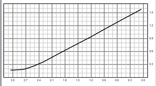

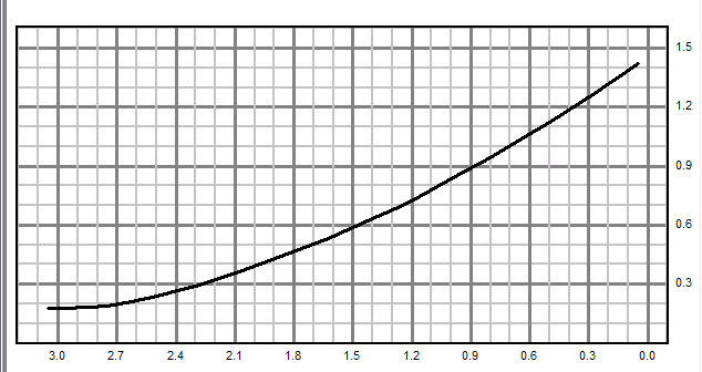

Alan makes a good point about the importance of the developer for curve type. Both developer and type of development can have a very significant impact on curve shape. I recently published an article in View Camera on two-bath development. In film testing for the article I tested Tri-X in Diafine and divided D23 with both intermittent and continuous agitation. With Diafine the curve shape as almost completely straight line, while with divided D23 the curve has a very long toe and flaring curve that is more typical of Tri-X in a traditional solvent type developer like D76.
My point is that if you really like the look you are getting with a specific combination of film/development/paper process that look may difficult to achieve with another combination without some experimentation. Of course, if you understand the relationship between curve shape of the film/developer combination and how it reacts with the curve of the paper process it should be easier to narrow down the combinations that will give the desired result.
Attached are the curves produced by Tri-X in Diafine and D23 with divided development.

The curves look like they are underexposed from the standpoint of a film designer. Since Dmax goes to 3.0 on most films, you are using only the lower portion of the curve for demonstration. In the left curve, I would use densities from 0.9 upwards for imaging and on the right I would use about 0.6 upwards for imaging. Maybe I would go higher. I would try to minimize grain and maximize exposure on the straight line. This gives me more latitude on either side of the area I choose.
PE

The samples are definitely not underexposed. However, temperature and time of development was such to give a relatively low average gradient of about .50, or slighly lower, as the objective of the article was to establish a convenient method of producing negatives optimized for scanning. This explains the relatively low Dmax. This goal is one that film designers probably did not think much about a few years ago.

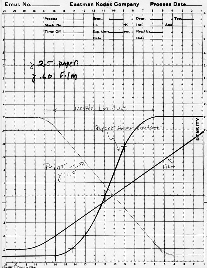

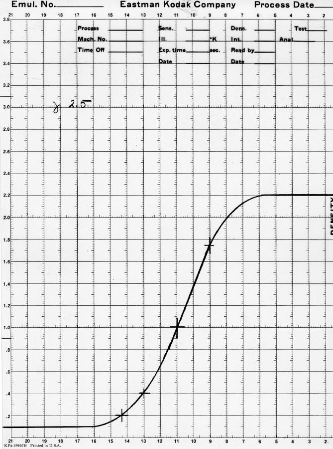

I surely don't like the curve on the left then. Sorry about the misunderstanding though.
I've incorporated 2 curves here. The one on the left is an average grade 2.0 paper, and on the right, superimposed on that curve are those of a negative film like yours in the right curve and a print curve from the two neg-pos curves.
As you can see, the soft toe of your left negative would impact on the print, lowering contrast and the film curve described in the OP which bows upward would cause a sag in the mid tones of the print.
Neither of these is desirable IMHO. Although in scanning a lot is corrected by the scanning operation via automatic software.
I have displaced the print curve and the paper curve a bit far to the left to get everything on the page. Usually, this entire sequence is plotted on a wide horizontal paper.
