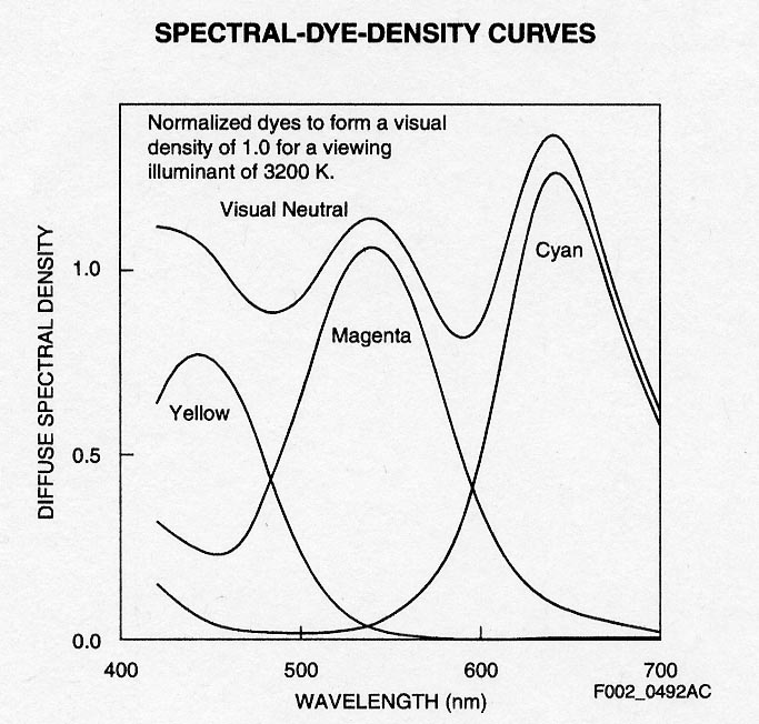

You must understand that the Kodachrome "look" was a colorimetric accident or mistake, due to the peculiar nature of the cyan dye that was formed. To get good stability and reactivity, the dye had a very peculiar visual response that created neutrals that were often green. Some thought that the greens were beautiful, and that the sky was beautiful, but in reality flesh tones were harsh and greens were often dark or even black.
It was quite hard to print, and prints and dupes lost detail in reds due to that oddball cyan.

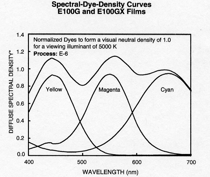

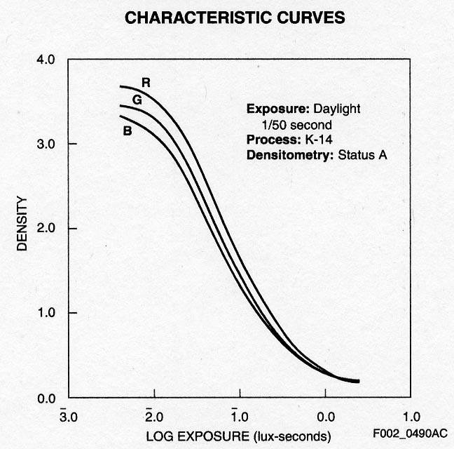

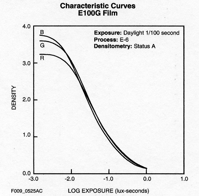

Well guys, the "norm" in visual response is a balance between C/M/Y when we look at films. Kodachrome has a mismatch in C/M/Y in terms of band width and density of the cyan, and this does what Roger states. Caucasian flesh tones tend to be washed out, African-American flesh tones often turn greenish, especially in the highlights.
Take a look at the 4 figures and observe how well matched the Ektachrome characteristic curves and dye curves are compared to those of Kodachrome. This mismatch in Kodachrome gave it excellent dye stability as well as unique (but odd) color reproduction. Direct side-by-side comparisons of any E6 film with Kodachrome would show you.
And there was an effort made to get Ektachrome to "look right" in terms of overall color response. I would guess that if Kodachrome had had another round of R&D, the "errors" would have been fixed.
PE

Kodachrome did not get much research over time, and its needs for couplers was quite particular as they had to be soluble in the developer at pH values near 12, and they had to be stable. They had to make stable dyes, and etc... So, during the life of Kodachrome, we probably had 3 dye sets. I'm not sure now. Other films had many dye sets.
Kodachrome satisfied a very happy but narrow customer base. It made slides with low detail in red objects (cyan again), and odd greens and blues. It made flesh tones seem chalky in some cases. But, I have remarked elsewhere that each person sees color a bit differently. This is due to the ratio and nature of the pigments in the eye and many other factors.
Over time the E6 film dye set evolved more rapidly and E6 films from about the mid 80s are far more stable (I think) than films from the mid 70s. I know this is the case for C41 films and the color papers which evolved very rapidly.
I have done Kodachrome-Ektachrome-Kodacolor comparisons in the original and in prints. Kodachrome was most often picked last for color quality.
