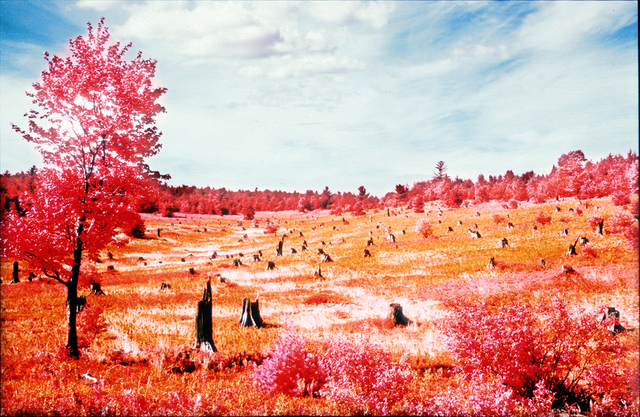

Here's a pic taken on 35mm Kodak EIR back in the mid-1990's. I've long forgotten the specifics, but I believe I used a yellow filter.

Yes, my goof. It was EIR that was the color version. Sorry!
As for false color, the blue record was never photographed by EIR. The Green was rendered as Red and so tree leaves were Red. Everything was scrambled and at the moment, I cannot remember the color orders in the film. In digital, you get all 3 layers unscrambled, but have a superposed IR image. No false color unless designed into the sensor which is not done for consumer digital, only for "spy" purposes.
So, EIR was false color and the reason was that the IR picked up heat sources and camouflage. So, if a tree was a fake, it was not red! The forestry service used it to detect dead or dying trees or shrubs. You would see a field of red healthy foliage and a dead one would stand out by being "not-red".
You may want to read this: http://en.wikipedia.org/wiki/Infrared_photography#Color_infrared_film instead of asking someone else to look it up for you! :D
Jim B.
Yes I read about using a yellow filter with the EIR and used it for most of my shots on the roll I had, sadly it was processed incorrectly as I mentioned.
