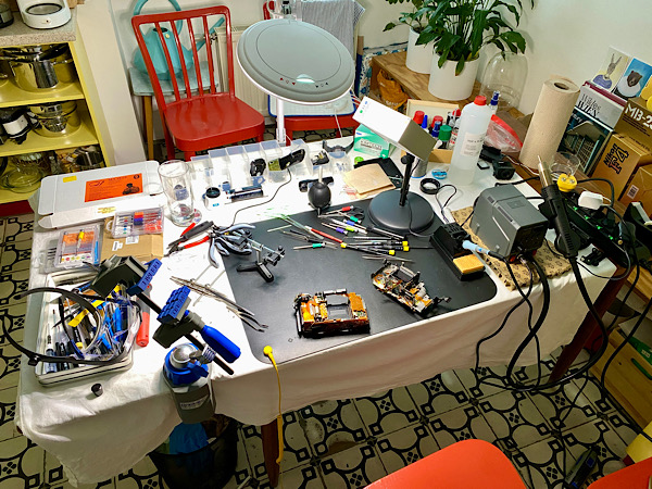

Yesterday I spent eleven hours repairing a Nikon F4.
The aperture control had to be cleaned and lubricated.
Complications included milling out a screw for the tripod plate and the exposure compensation knob. Its little spring for the safety button came out and I needed time to put it back in.
Without complications and with the right practice, it goes faster, let's say a nine-hour workday including a final functional test.
At an hourly rate of EUR 120/USD 130, that would be EUR 1080/USD 1170. Spare parts and materials not taken into account, tax included.
For this I can get three nice F4s on the second-hand market. I'm not going to consider whether these also have the aperture problem.
Who pays that price?
I now understand better why workshops usually refuse to carry out such repairs.
So there is no choice but to do it yourself.

Another aspect:
I believe customers are more likely to accept reasonably high prices for repairing mechanical cameras than for electronic cameras.
Mechanical devices are associated with high-quality craftsmanship, you have an idea what it is about, while electronics remain abstract or, at best, associated with cheap, mass-produced goods.
Therefore, customers may find it difficult or impossible to understand the cost of repair for an electronic camera.
