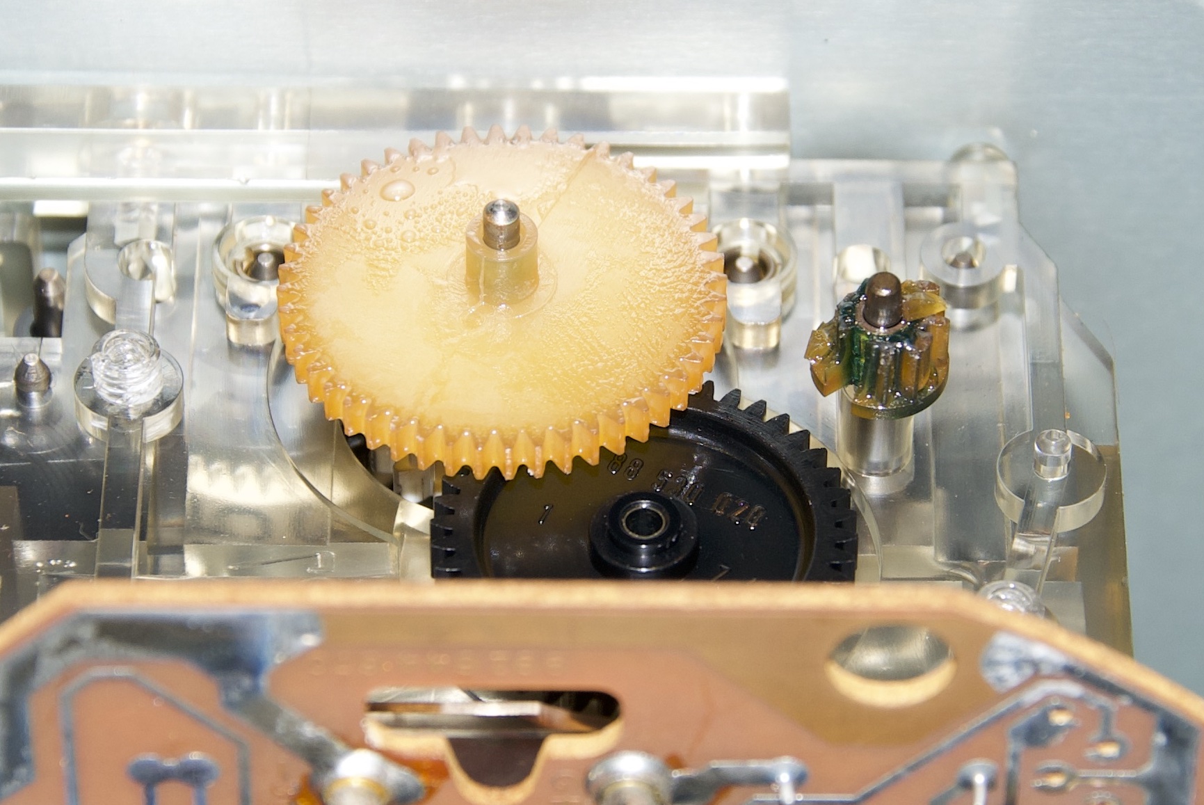

OFF TOPIC: Mercedes r109 (SL) gears appeared lubricated, though the wet appearance may be due to the breakdown of the plastic. I think every R109 has this problem.
My gears were like jello. (photograph shows Mercedes SL560 odometer gears).
It does look like that plastic is 'sweating' the oily stuff. It's also interesting that there are 3 gears, made of 3 different plastics with 3 different levels of longevity. The black gear seems fine compared to the tan, which does not look too bad. Then there's the small gear which just turned to mush with age.
