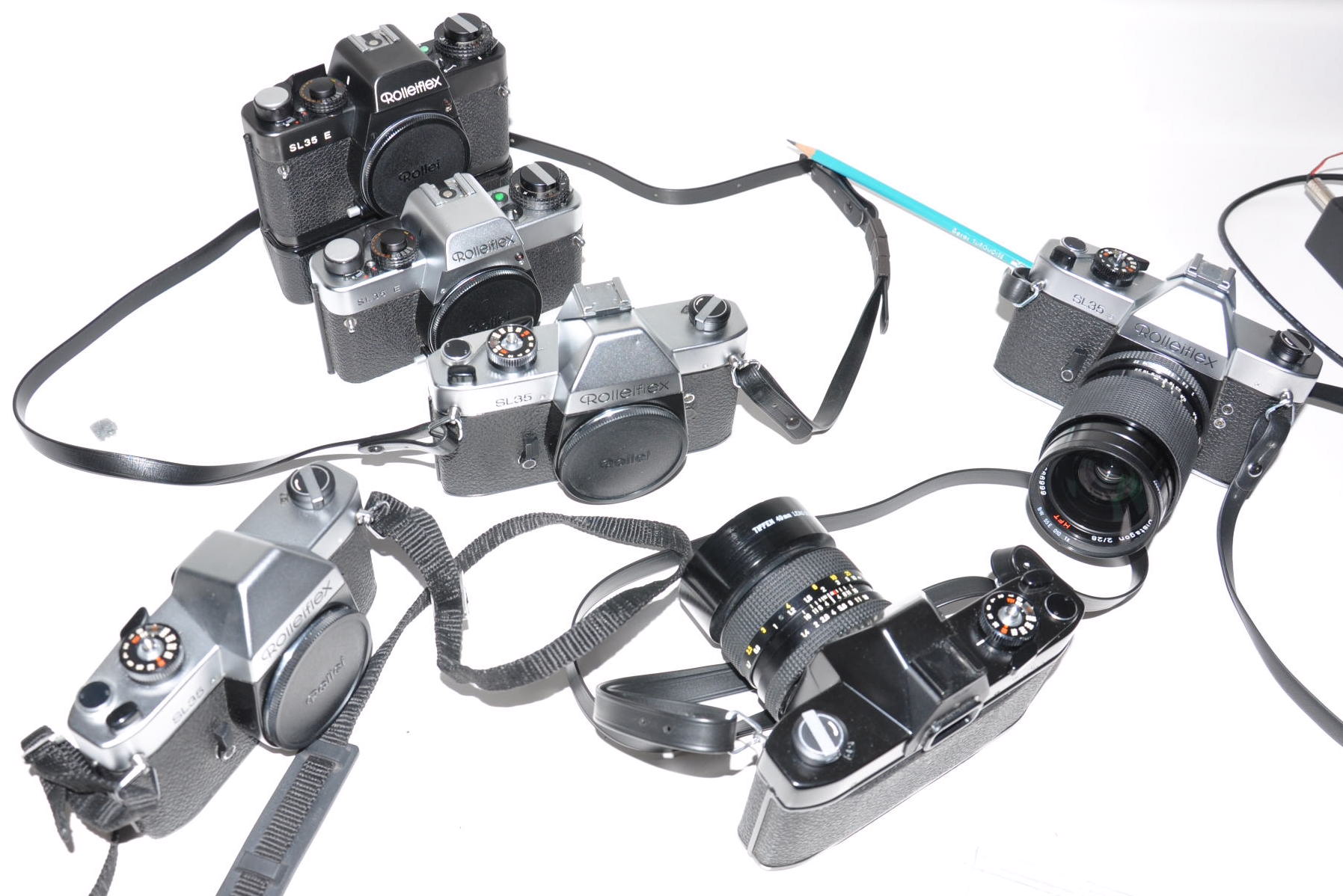

I got into mechanical Rollei 35mm SLR a little out of frustration. Seems the Japanese Bessaflex and Kenko cameras of the early 2000s came in Yashica/Contax, Nikon, Pentax, 42mm and maybe some other, but I always wished they made a modern Japanese camera for the Rolleiflex Zeiss QBM mount lenses.
Turns out the SL35 is somewhat of a copy of a Pentax anyway, and these mechanical Rollei are easy to find on ebay, so I started fixing them for my QBM lenses. But now I have more bodies than lenses...and this picture only shows about half of the bodies.

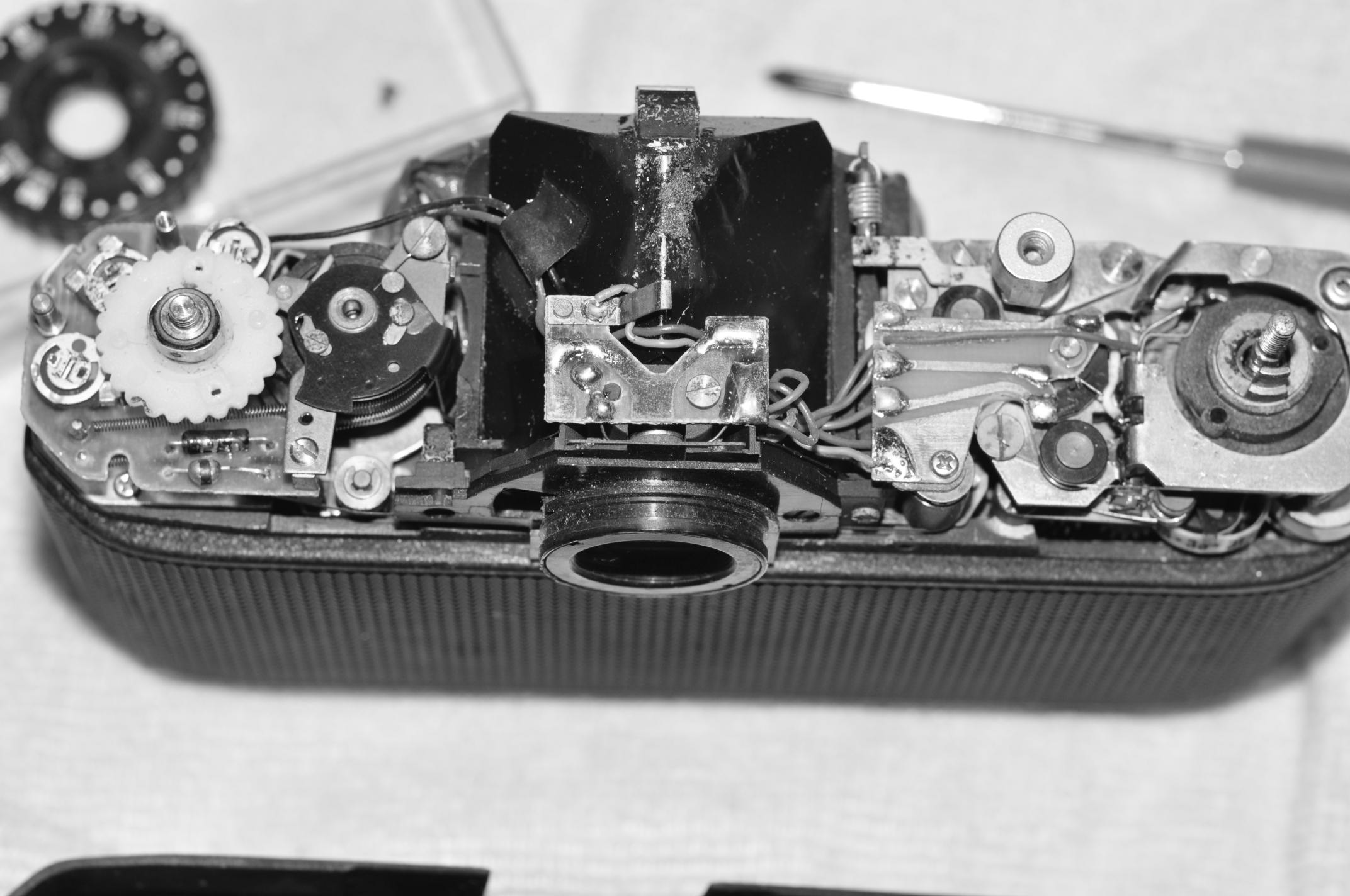

Once you open a SL35, you might not want to work on SL35M again :smile: I have not totally given up on SL35M, I have two that I got working well, but I don't think I'll buy any more SL35M to fix again. I think the SL35 is a much better design on which to work.
My SL35M was received free. It was treated as spare parts waiting to be teared down but fortunately it never happened .
What I learnt from it is from the bottom . I am sorry I didn't take any pictures but I can tell there are something wrong with this design, like putting all important stuff to the bottom. The mirror release and return delay mechanics are all there. So when that gear failed to trip the camera would jam, just because the camera can't let the mirror flip up at instant or return at correct time.
The upper part is , slow speed timer at right side of your pic, under the released button. Left side is the meter and my SL35M has old dirty lubs that glued them up. I cleaned it and the meter works again . The advance lever is a bit unnecessarily complicated from today's pov or even compare with japanese camera at the same period time .
The only thing I can't fix is the little separation of the prism. But anyway I am not dare to replace it since the wires and circuit are all around it .
Somehow it gives me a feeling that Rollei was struggling during the SL35M / ME / E models period. They are trying to catch up all japenese tech at once but they can't and making them much falling behind.

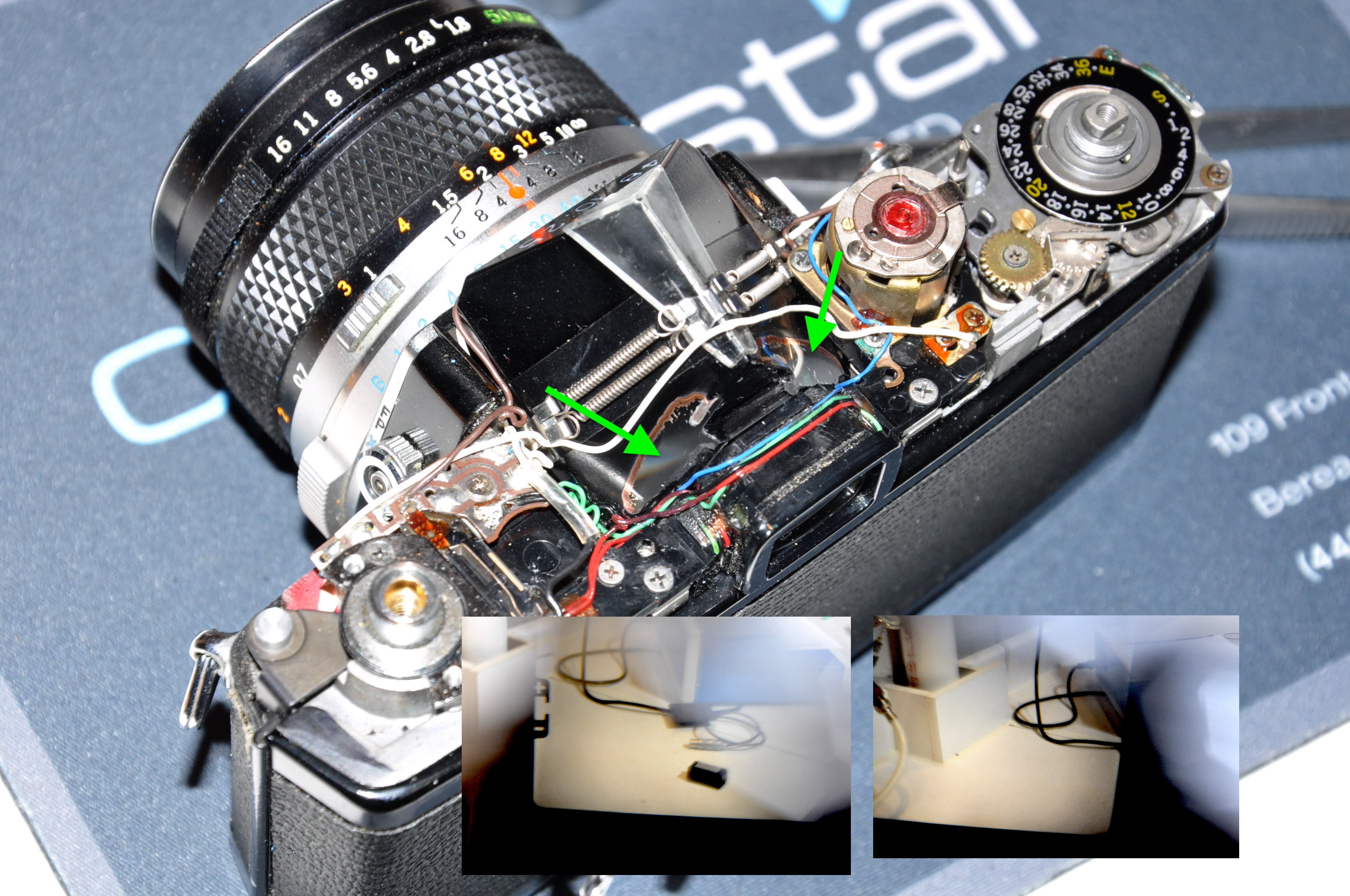

Looking at my picture, I might want to get that un-repaired camera out again and try cleaning the goop from the prism. On my OM-1 I recently fixed, just cleaning the goop off the prism cleared it almost completely.
