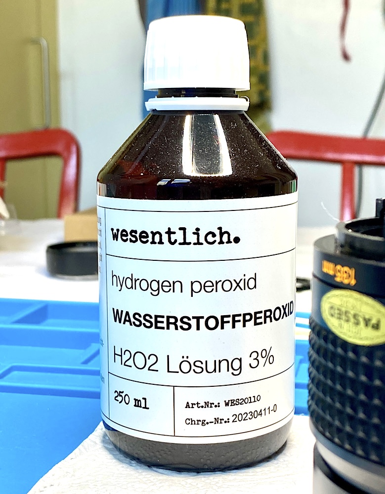

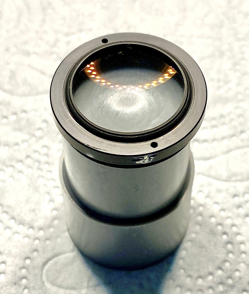

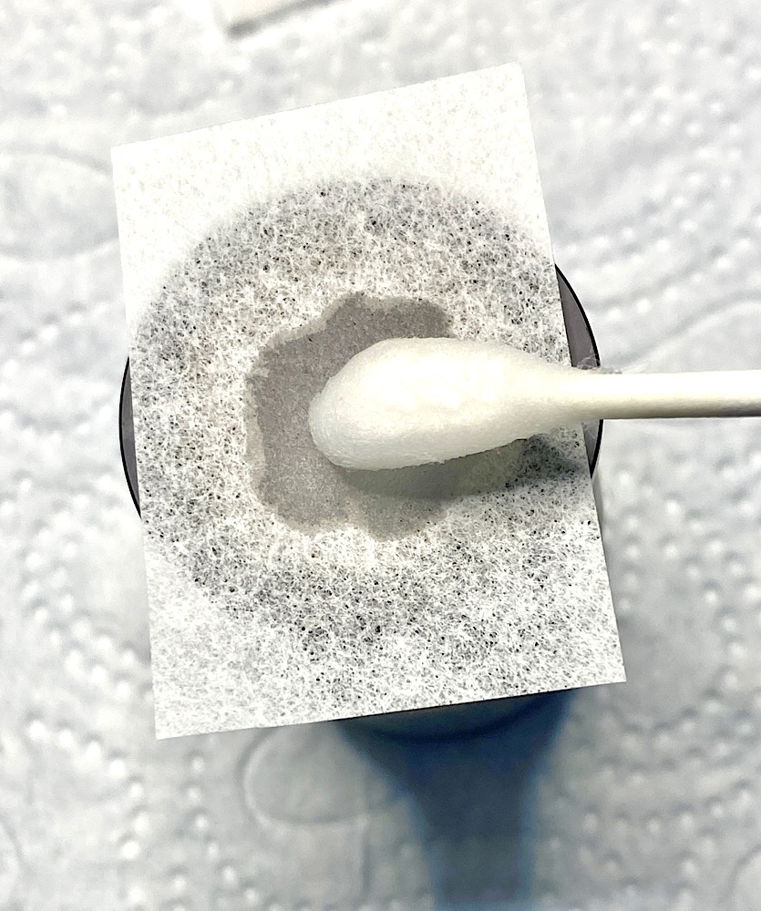

as well as someone who would be willing to work on glass, stop the little of fungus that's there. Clean as best as possible and maybe recement separating elements, I know it won't be perfect....
If the lens surface affected by the fungus is accessible, the fungus can be removed with hydrogen peroxide and then cleaning the remaining streaks.
If the fungus has already etched the glass, the only thing you can do after removing is have the lens polished. But this is only an option for expensive lenses where it is worth it.
This process worked for me on a Minolta 135/3.5 (II) with Fungus:
Hydrogen peroxide 3 % …
… wound spirit on lens cleaning paper …
… clean
All information provided without guarantee and use at your own risk.

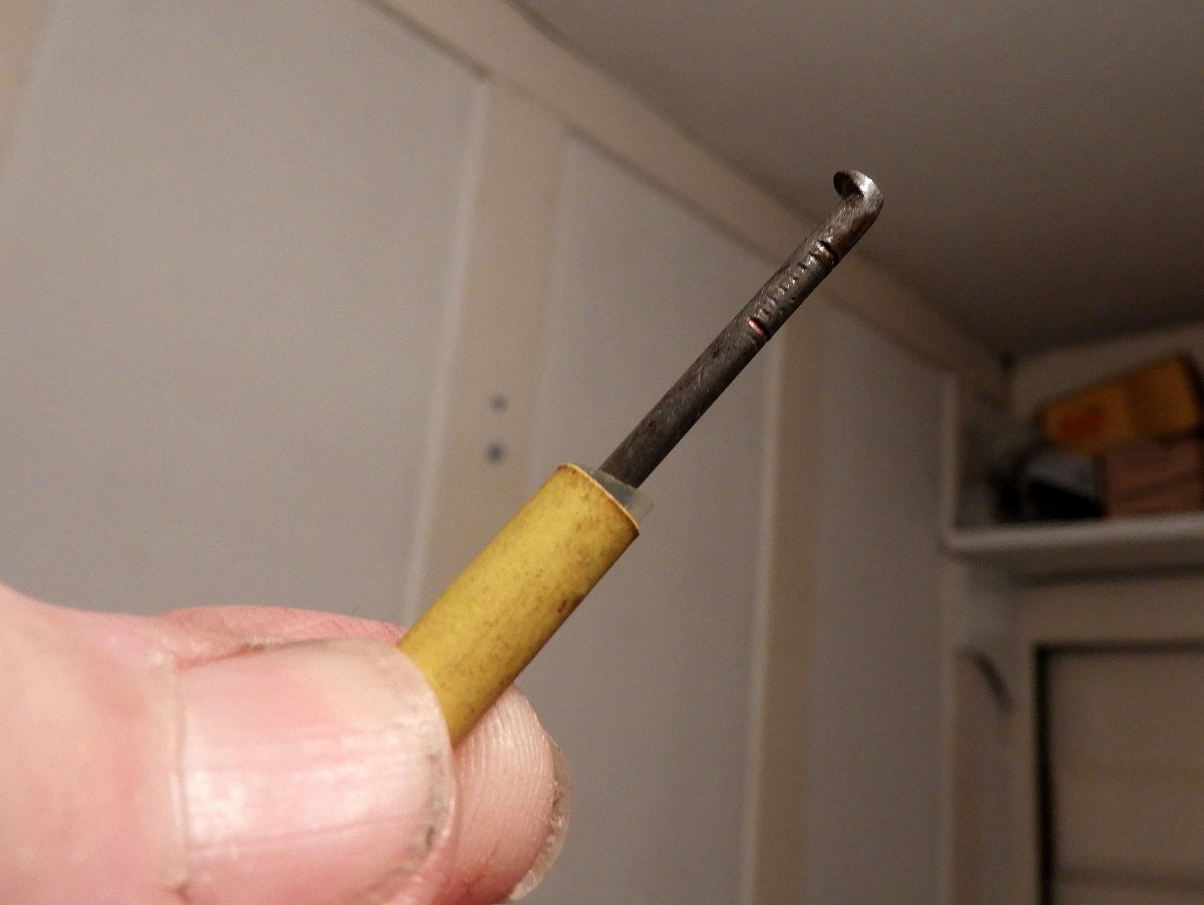

This thread got me wondering about a Pentax Spotmatic SP II I have with no rewinder and the film door stuck closed. I had given up on it, but watched a video yesterday which revealed that there are two screws under the leatherette that, when removed, will allow the door to open. Voila! It worked. Of course, there are other problems, but that's a start.
There's an easier way than that. A stiff piece of wire or a small thin nail with the end turned over (think of a small crochet needle) can be inserted down through the rewind crank hole, held to one side and then gently pulled upwards releasing the back catch. Working on 35mm Pentaxes, the rewind crank usually has to be removed before the top plate can be lifted off. If the back cover is closed and the rewind spindle ends up plopping inside the camera, which it often does sooner or later, then the ability to open the back easily is very welcome. Attached is a picture of the tool I made for the job. Apologies for the grimy thumbnail - a leftover from replacing the car gearbox seal yesterday!
