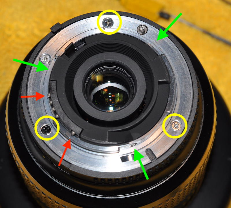

Remove the 8 screws indicated in the picture.
The aperture ring and lens mount will come off leaving this.

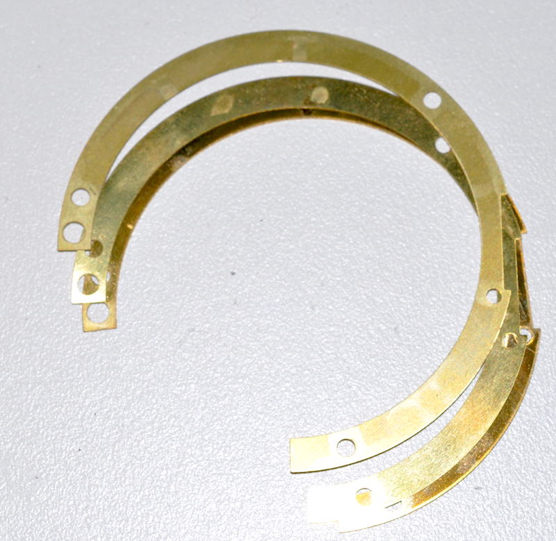

The brass semicircle lifts off. In my case it was in triplicate. Other lenses may be different.

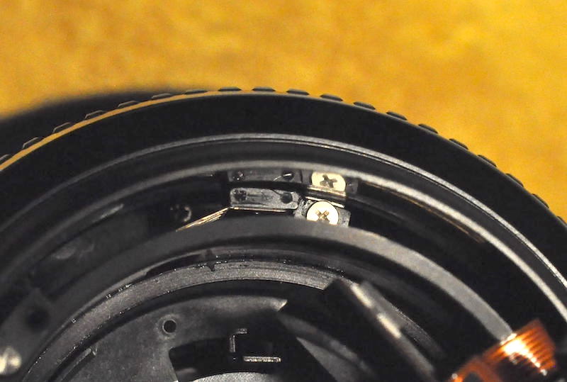

In the case of this lens, the culprit was not that hard to find. This image shows the wipers for decoding the zoom/focal length of the lens.

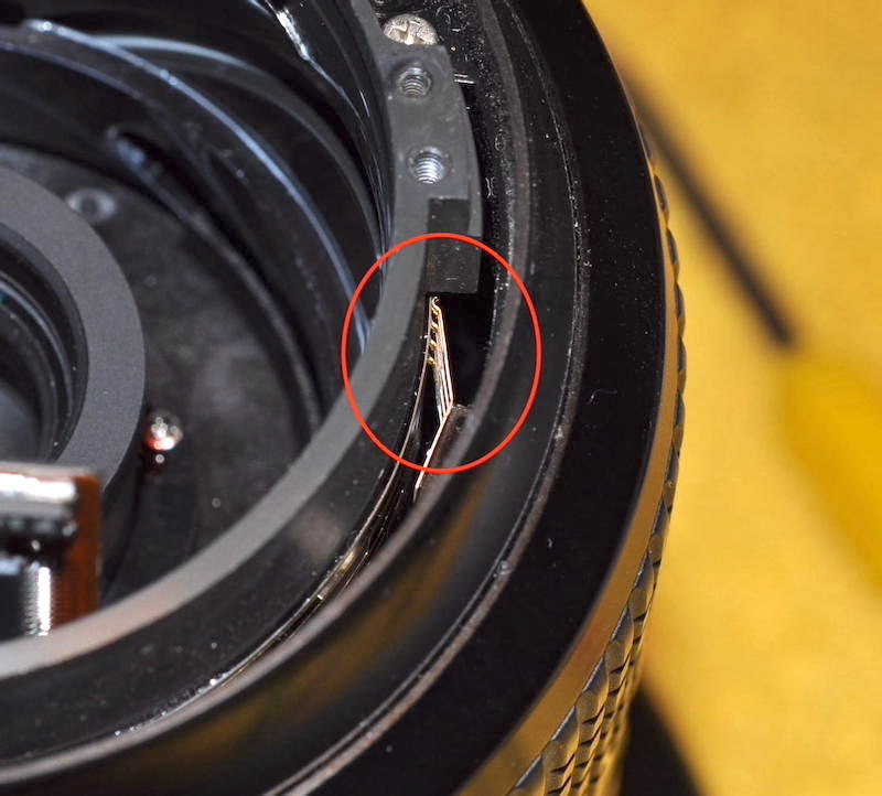

What has happened here is that the wipers have come off the tracks. The lens was stuck sending only "35mm" to the camera (how to tell? Will explain later...)
So, when the AF electronics in the camera think the lens is 35mm but the lens is zoomed longer than 35mm, it will hunt back and forth and can't find exact focus.
This is another shot of the wiper assembly. In this case the wipers are too far toward the camera taking the picture. This whole assembly needs to be bent downward to get the wipers back on track.

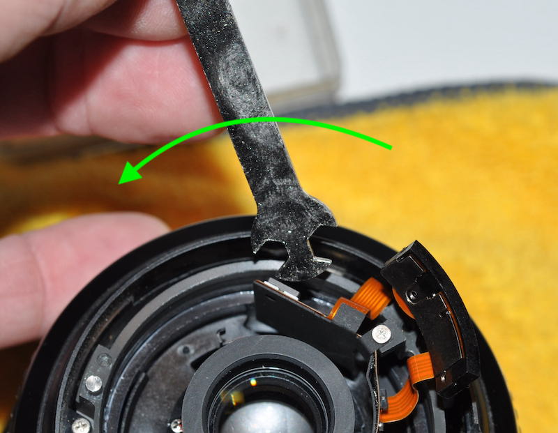

Ok, but how to do it?
I was able to come up with this little wrench. I placed it around the screw and bent the metal tab holding the wipers. Just enough!! Not too much.
It worked! The wipers now were riding on tracks and stayed on the tracks as the zoom ring was rotated back and forth.

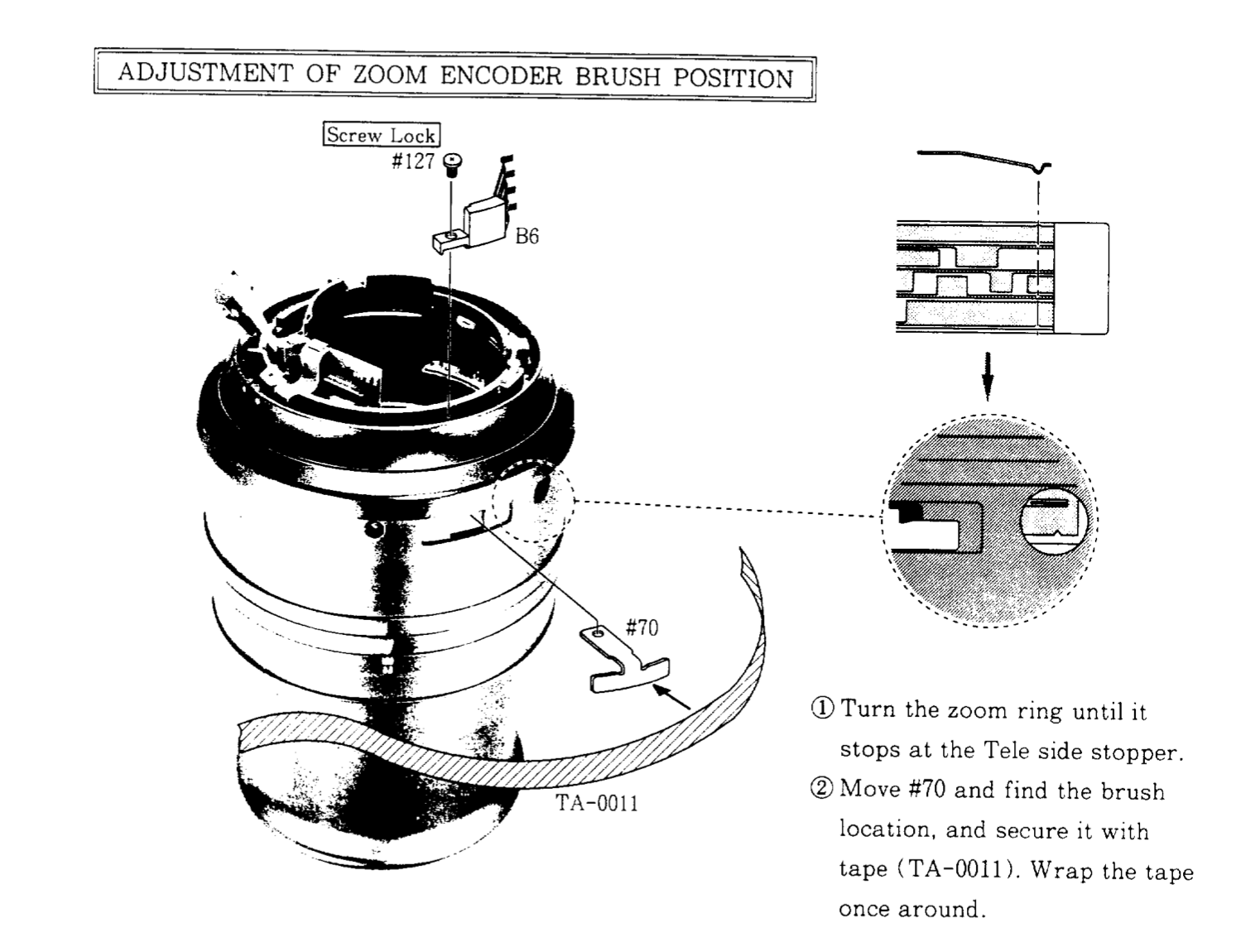

Information on the zoom encoder brush from the factory service manual:
