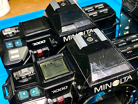

If you look around the web for information on repairs to newer electromechanical SLRs, such as the first generation of AF cameras from Minolta (9000, 7000 and 5000 AF), you will find little concrete information.
Batteries should be exchanged with fresh ones, replace the backup battery for the settings, thorougly clean battery contacts or the camera should be switched on and off again after a certain procedure.
All good and sensible advice, but often it doesn't get us anywhere.
Often it is not a cryptic error in the electronics when an electronic SLR does not work.
The most common advice is
„Buy a new used one, repairs are too expensive, spare parts are rare“.
Posts about repair attempts are almost non-existent.
The same is probably true of other cameras from this 80s generation.
And that is why many former family favorites will probably end up in the electronic scrap yard.

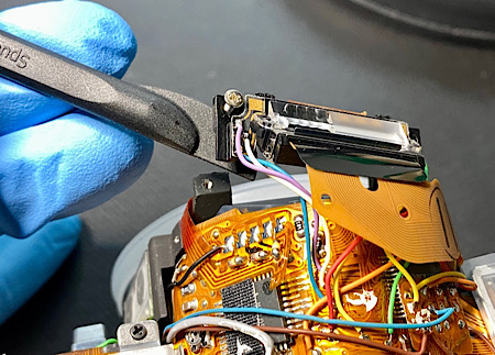

Such interventions on a complex camera look worse than they actually are.
Which is a shame
because once again it has been shown that it is not usually „the electronics“ that fail, but rather banal reasons that cause the cameras to malfunction that have nothing to do with the electronic control system:
Dirty magnets, stuck shutter blades, decomposing contact elements on LCDs, misaligned mirror devices for displaying data in the viewfinder, damage due to force, corrosion and dirt.
All of this can be remedied with good chances of success if you are willing to invest time and effort in a repair.
Once the mirror box is removed, you have access to the heart of the camera and can troubleshoot.

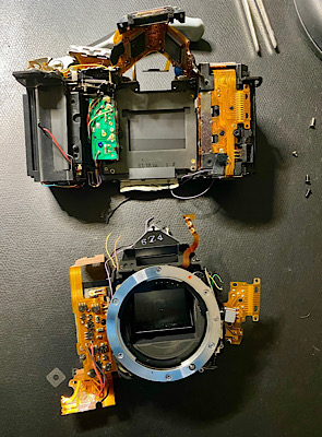

The key to many repairs
is removing (and reinstalling) the mirror box from an SLR. From there you have access to the shutter, aperture control and mirror mechanism. Spare parts are available from discontinued cameras of the same type.
You just have to want it.
In the case of an unknown electronic error, you can replace the entire circuit board.
