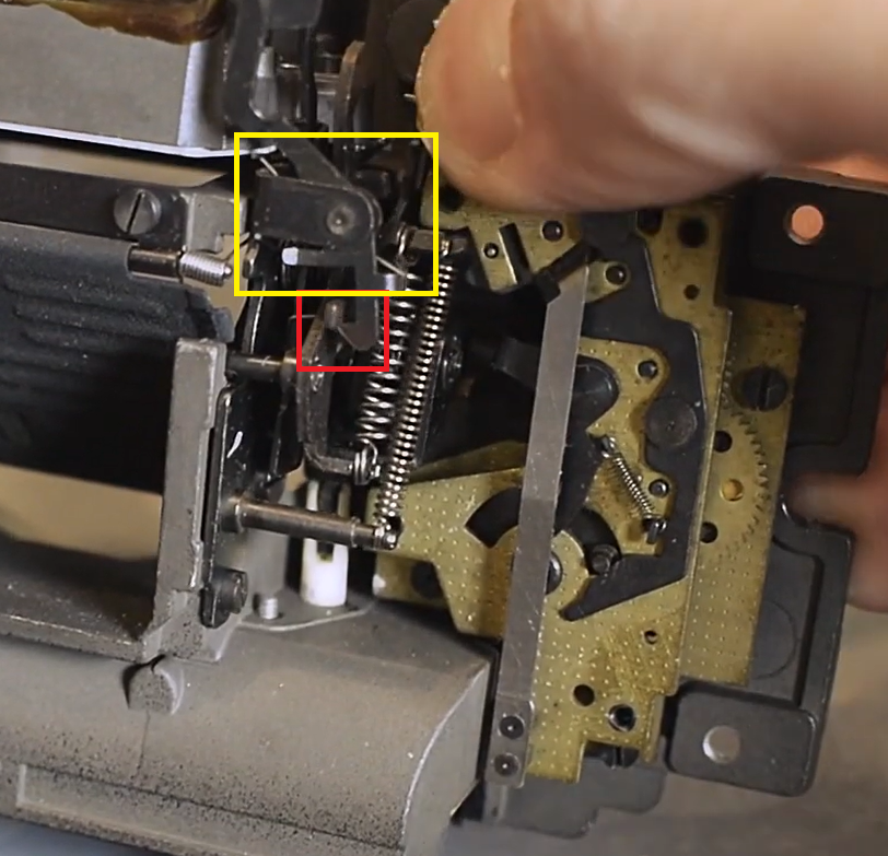

This is the part (SP3) of that likely causing advance lever failed to advancing film & tensioning the shutter.
One the spring is off from the position, the driving clamp/hook behind would failed to keep in pressed position in order to draw the wheel below.
The true cause of loosing this spring is unknown. But for cases like this I often found it from:

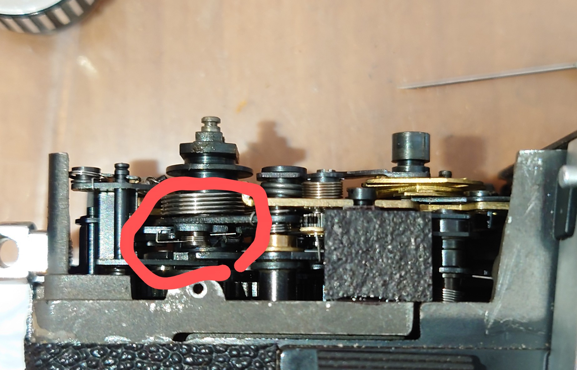

Thank you, this is very helpful! Interestingly, this spring seems to be in place on my camera, and it turns when the advance lever is turned. However, the pieces below don't move at all. I'll keep testing and see if I can identify the problem.
My spanner wrench has arrived, so I've been able to get the top plate off - yours and Chuck's advice were very helpful here!
EDIT: Here's a link to a photo of my camera, in case that helps to diagnose the problem. (I've had to upload it separately as Photrio is throwing up an error when I try and add a photo - possibly because I'm too new.)

Thanks for the photo.
I can see it hasn't been bended , but it seems to me that the clamp is not pressing inwards? 🤨 This clamp should be pressing inwards when driving the gear below, and it is only released when the lever returns.

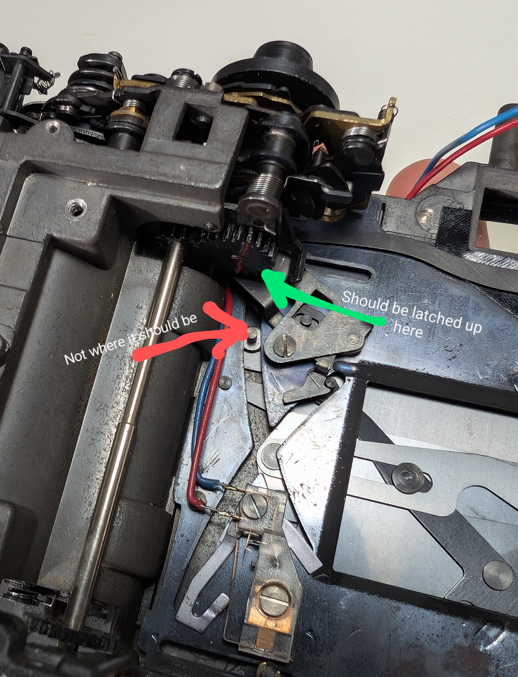

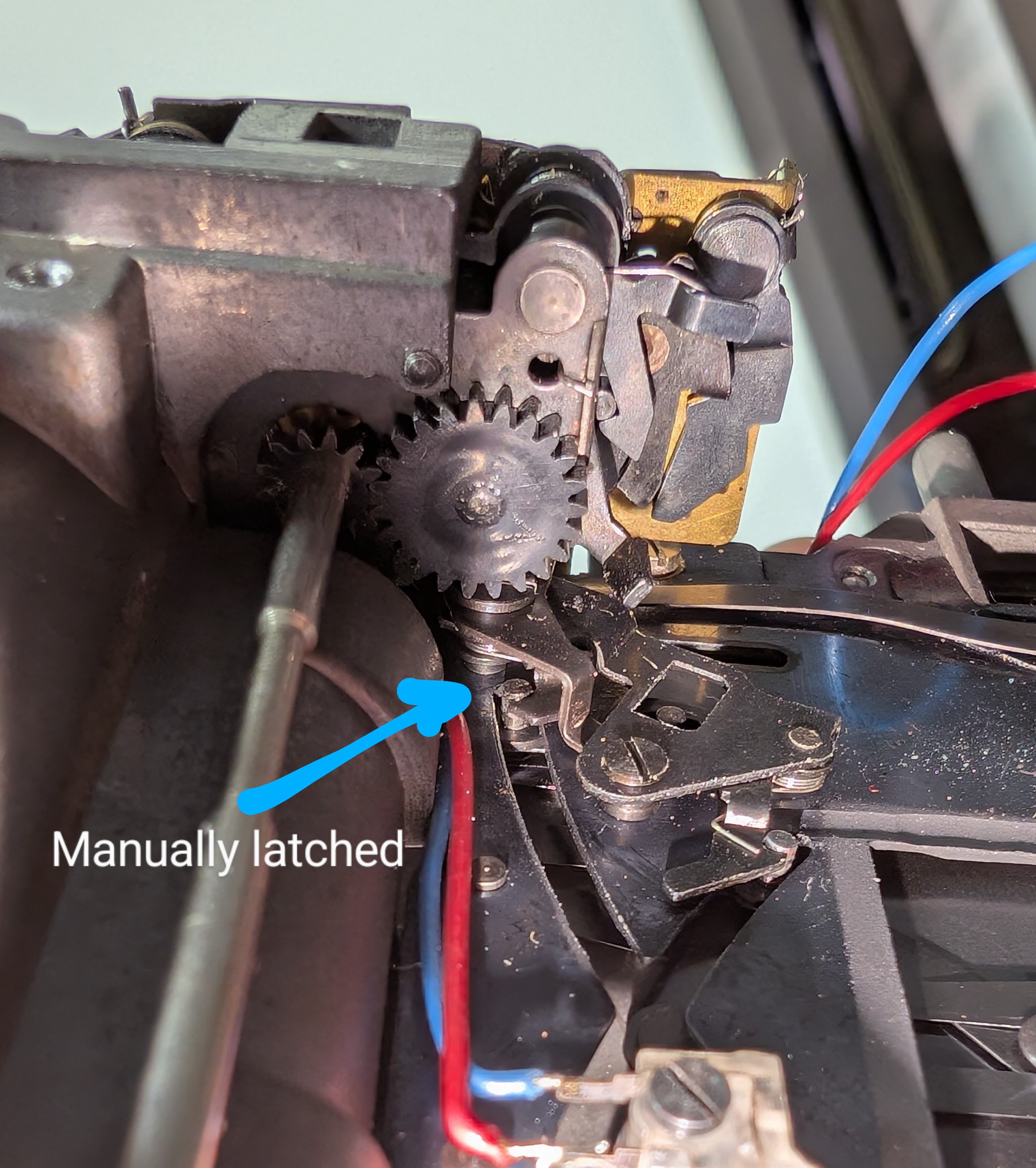

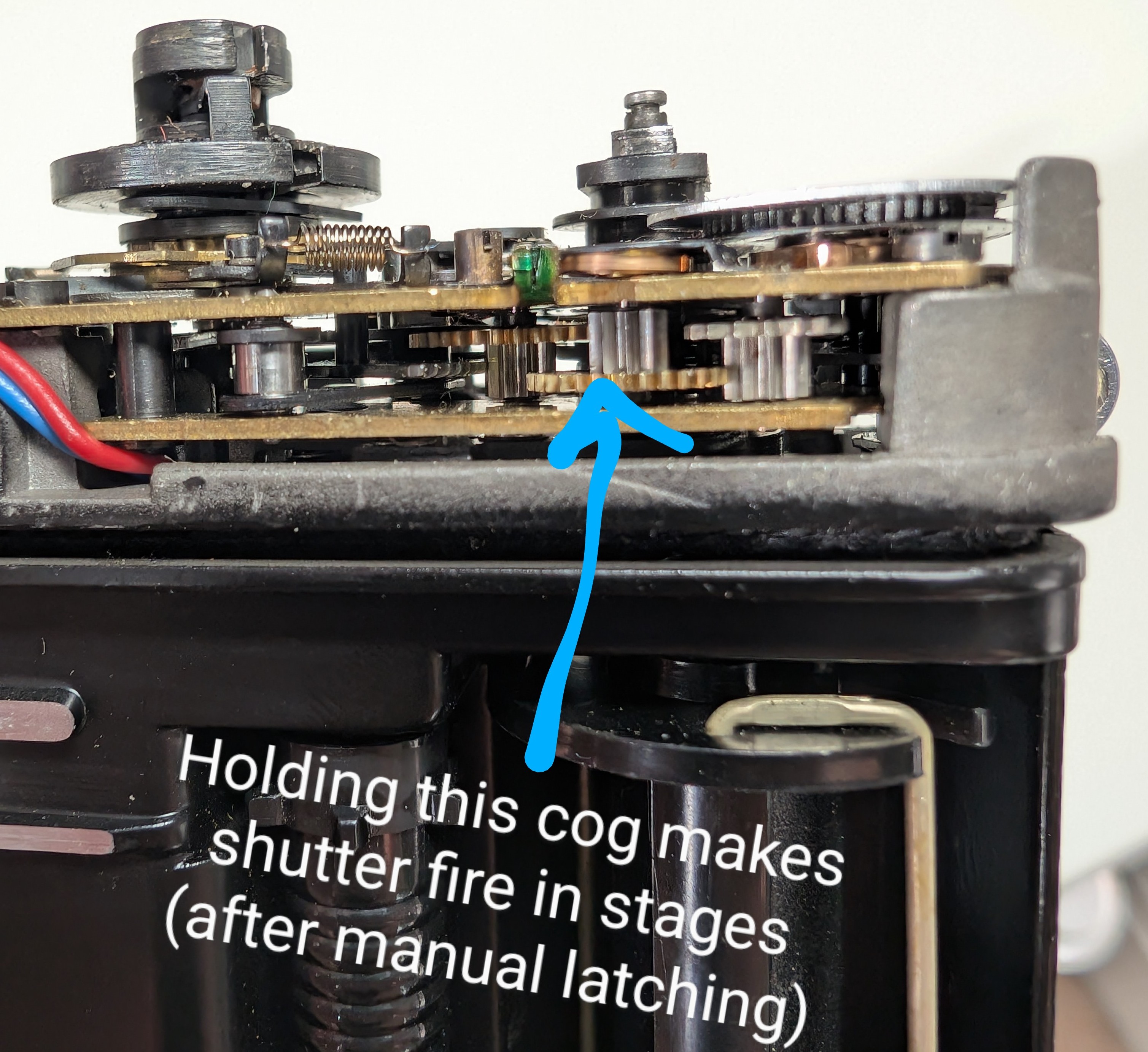

I've had a breakthrough, thanks to your comment about the clamp! You're exactly right: the clamp was on the wrong side of the spring. The spring seems to be slightly misshapen, but if I push the clamp in manually, I can get the camera to fire perfectly. Now I just need to figure out how to fix the spring itself, so that I don't have to push the clamp in every time. Thank you for all your help with this, really appreciate it!

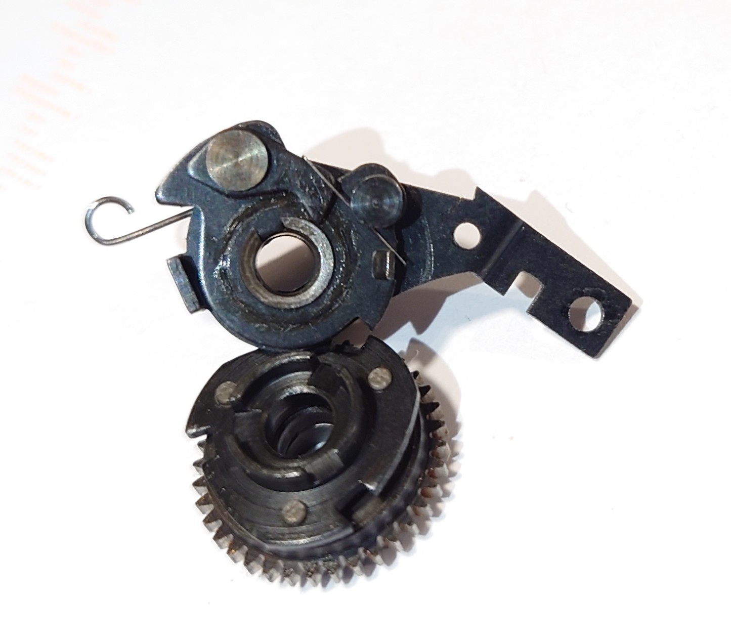

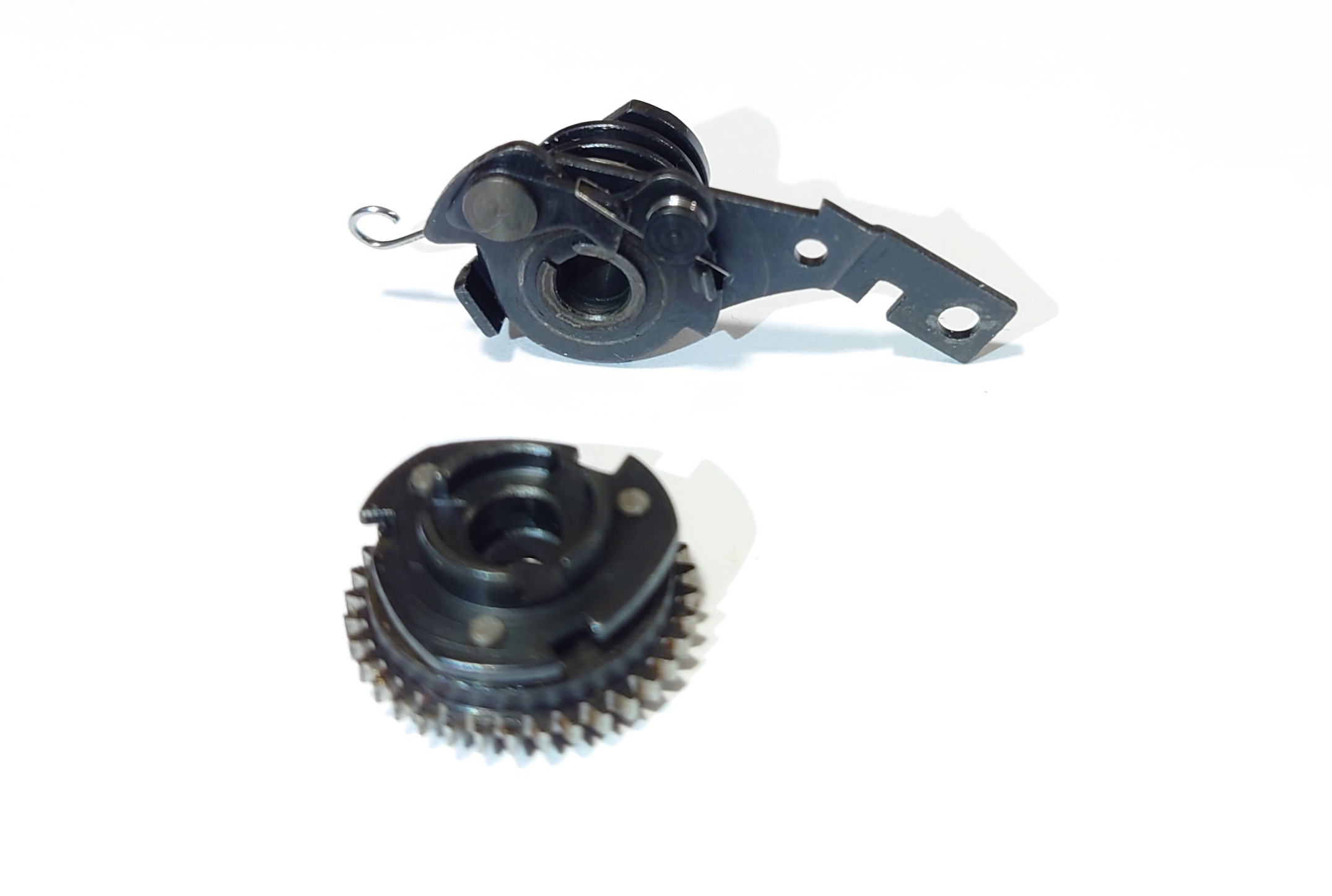

I have found a normal parts of that winding/advancing gear. You can see the " clamp & spring " positioning from these photos.
Hope these photos can help you.

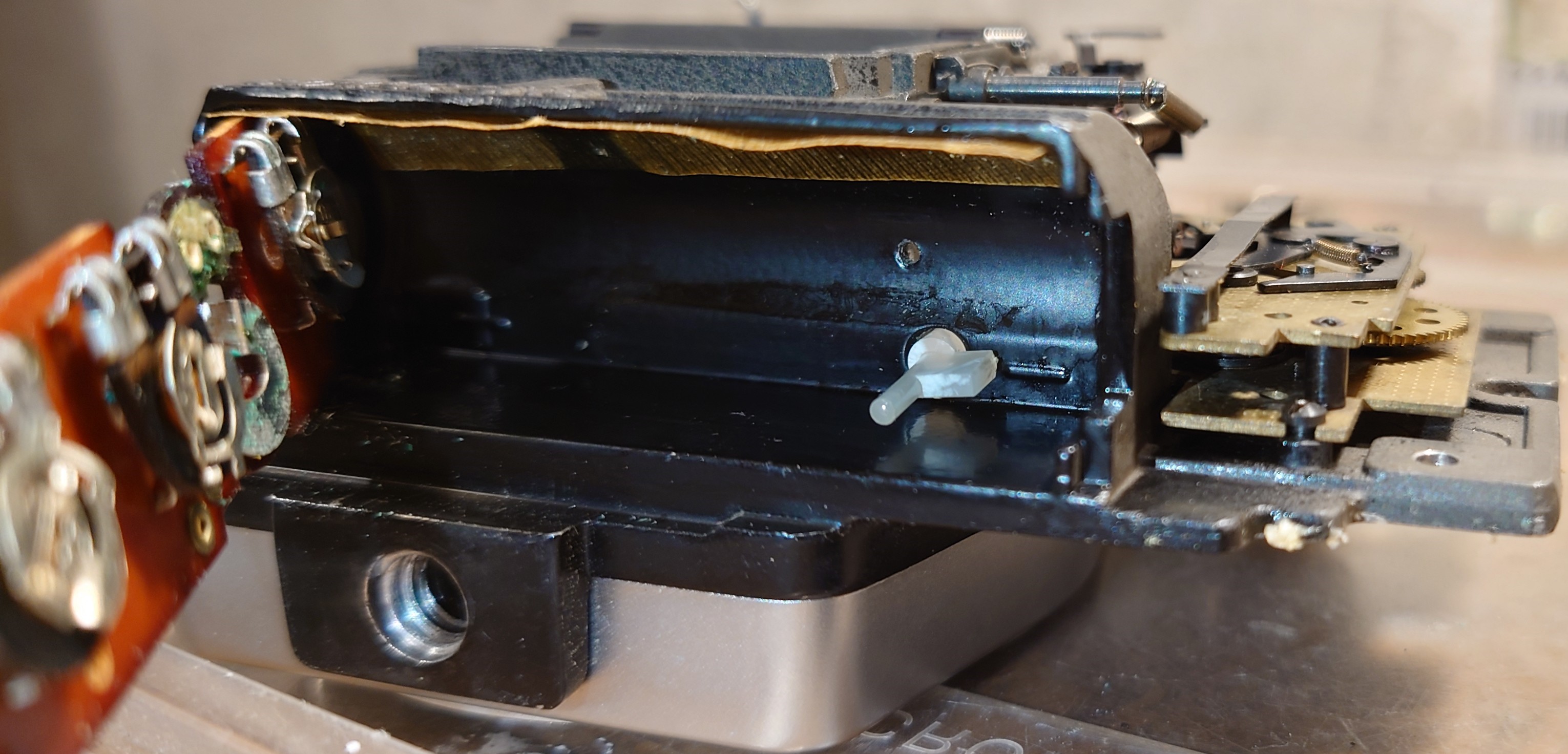

About Praktica 's front plate and mirror box (Not LLC/PLC/VLC)
**Make sure to set ISO =12, Shutter speed at Flash first **
To remove (after removing the top and bottom covers) :
  1. Take off the self timer, Unscrew the ring around the released button.
  2. Remove the surface leatherette with anhydrous alcohol
  3. Remove the thin metal sheet (or cardboard paper in some cases)
  4. 4 large slotted screws,
  5. 2(or sometimes in 3) screws around the resistor disk from below picture, after removing the bottom cover.
Then you should be able to slowly lift up the front plate / mirror box and slide it out from the shutter speed controlling unit without flaws. This resistor disk would come off without desoldering as well (since it is connected to the metering circuit board on next to it).
Desoldering/ Soldering is not something I would suggest in Praktica L . The metals are old and the circuit board can not afford too much heat. Old wires are often found not holding the solder well .
As mention in the above the text, setting the set ISO =12 + Shutter speed at Flash would bring rotating selector of resistor disk to the photo's position . It should be a "7" like . In the future no matter you have to fix the speed selector gear above or replace this resistor disk, this "7" is the default location of "ISO=12, speed = flash" .

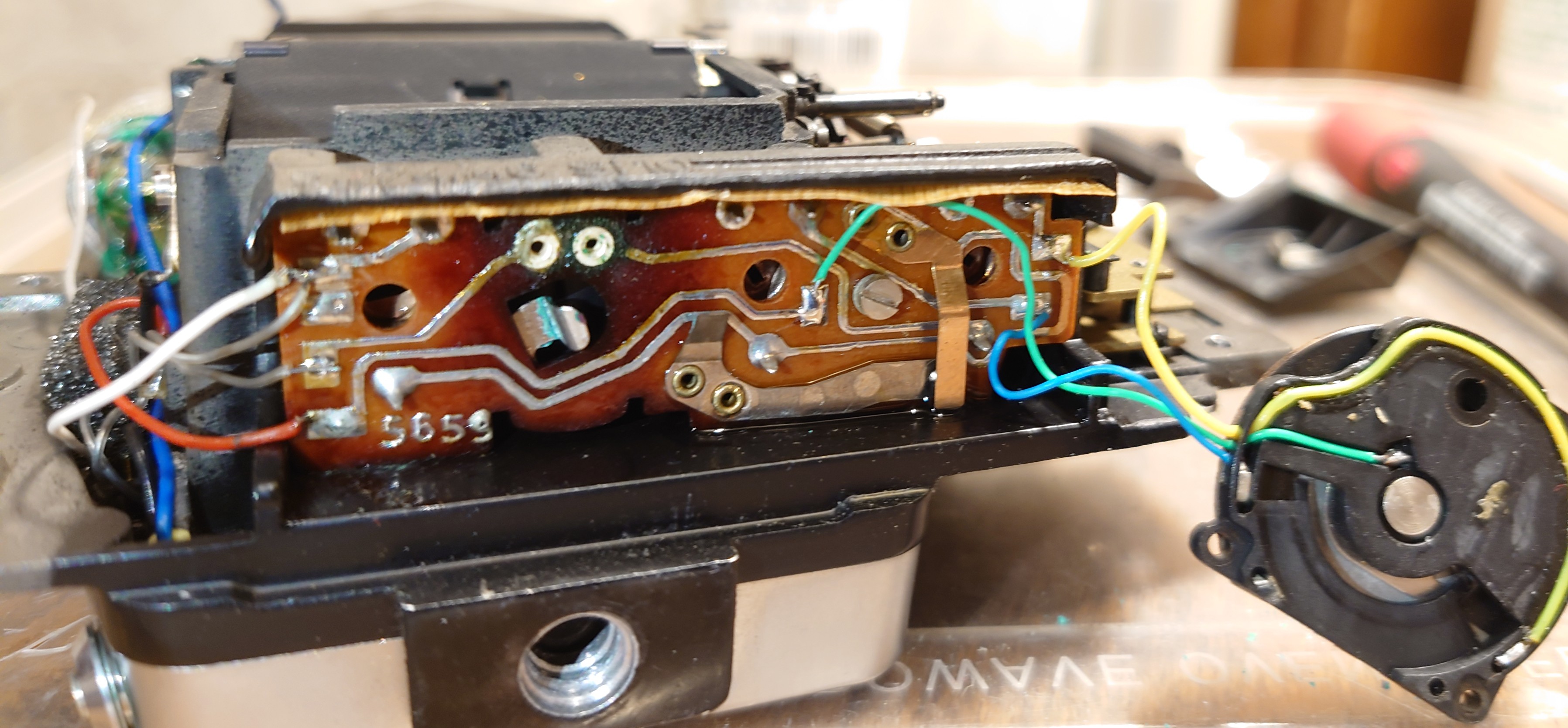

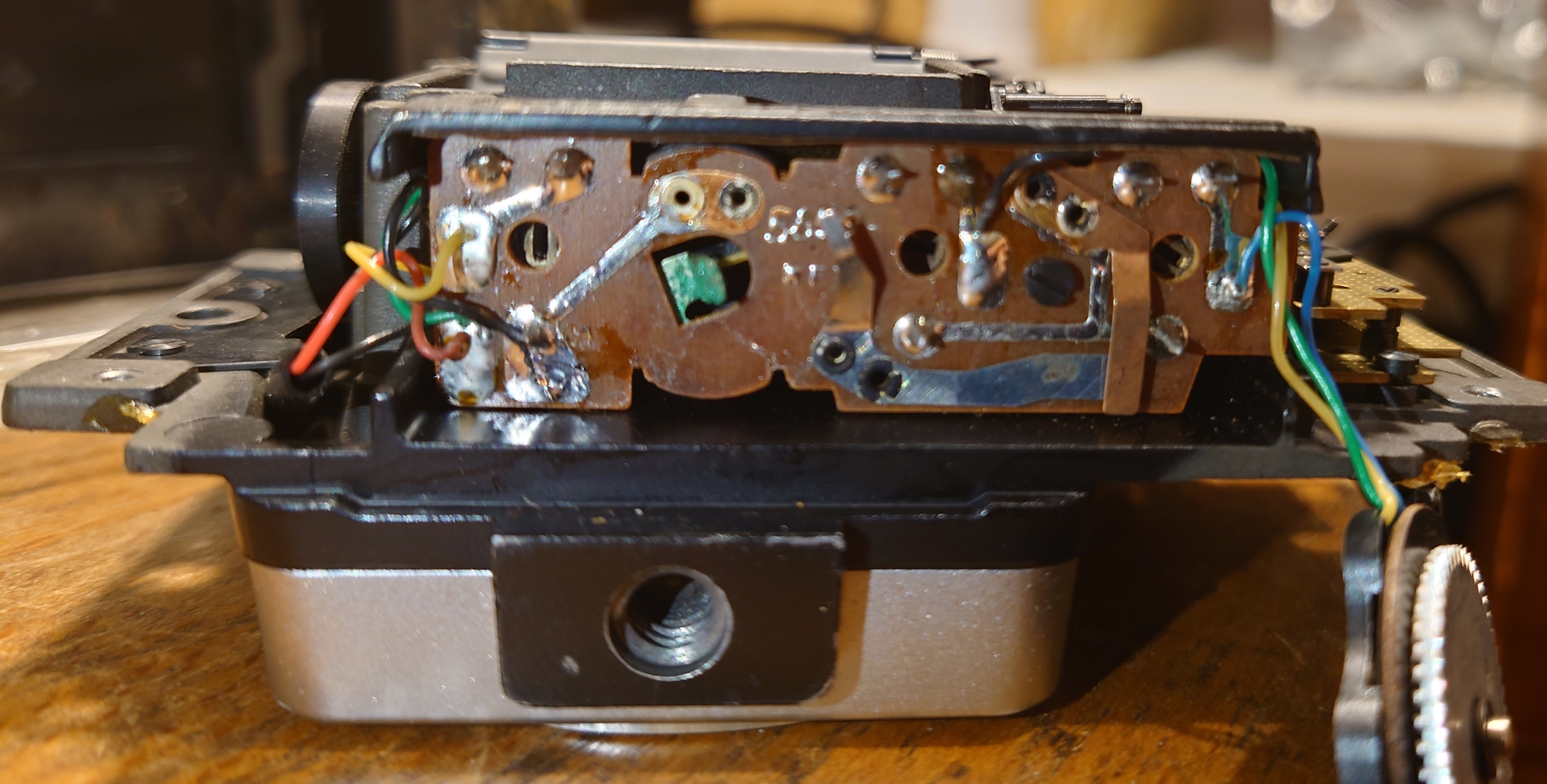

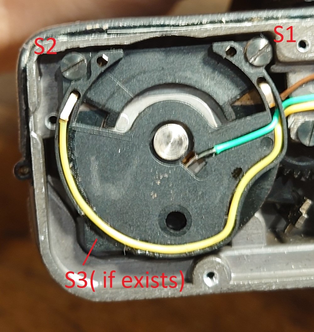

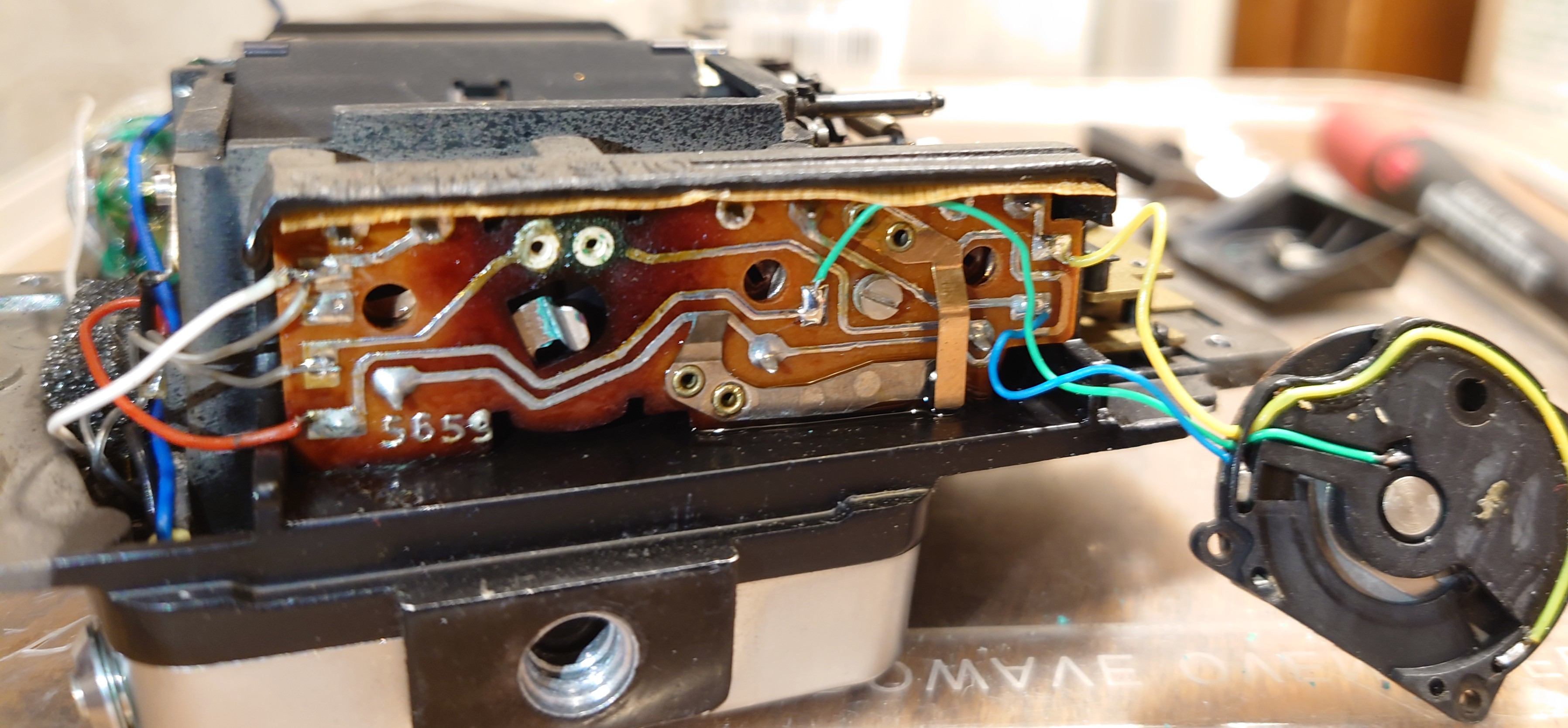

There are several variations in the circuit board as well . The above version is the very last and most common in late models .
While this one is sometimes can be seen in earlier version :
If you nee to remove this circuit board, unscrew the single brass screw .
Under it should have a black plastic support (not shown here) and the pushing rod .
The brown tape seen in the pictures is the insulation tape. It is too old and would fall off in most cases. Replace it with another insulation tape, electric wire tape , or simply a stationary tape would be fine. It helps to prevent short circuit from the electrics touching the metal compartment wall

Thanks so much! Unfortunately the spring broke (snapped) when I was trying to maneuvre it back into place. I'll have to make a new spring, so we'll see how that goes - these detailed photos will be really helpful! Thanks again for all your assistance with this, much appreciated.

Hello everyone!
First of all, this forum was already helpful in the disassembly of a Praktica VLC 2, that got to my hands completely unusable. I'm trying to reuse some of its parts for a project, but for that I need the shutter to cock and actuate.
In the following video Jonathan clearly presents the shutter and mirror mechanisms for a Praktica:
In 0:58 there is the engagement of a hook (I marked that in red) that enables the shutter to be cocked.
There is a very thin wire / spring that keeps that hook tensioned down (towards left) at all times. I marked that in yellow.
I am missing that wire in my camera. I tried to come up with something, but ended up with a wire mechanism that has tension in the other direction, which does not help in keeping the hook tensioned so that there is engagement.
Any ideas on how to get this mechanism in place? I have the impression this is a common mechanism that is used in more than a model.
Thank you all for the attention!!
Gustavo
