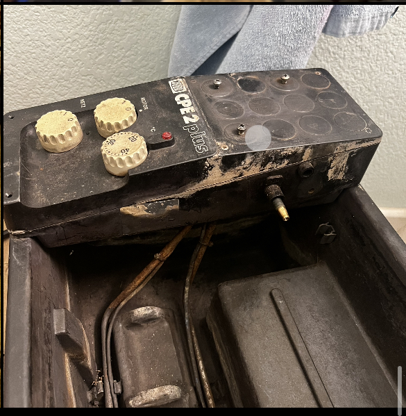

Hi,
I got a cheap CPE2Plus with a Lyft and of course it did not power up.
EBay seller said everything works but does not accept returns.
Lyft seams to be in a good shape
Is there a repair manual for the CPE2Plus?

There's a thermal over temp breaker switch that trips out. The switch on the left side of the unit, is reset with a pen or pencil etc (hole is on the side). This can be accidentally tripped when cleaning with hot tap water, or just momentarily turning on the unit without water.
Look at Jobo USA for manuals etc. Catlabs is the service center in USA

So does the motor run if power is on and motor is switched to on? The little light is illuminated when heater is on.
No light no noise.
Maybe I have to fill it with water for it to start?

First fill with room temperature water, next reset the thermal switch on the left side of the motor housing, then plug it in, next turn power on advance the thermostat until light comes on, then turn on motor.

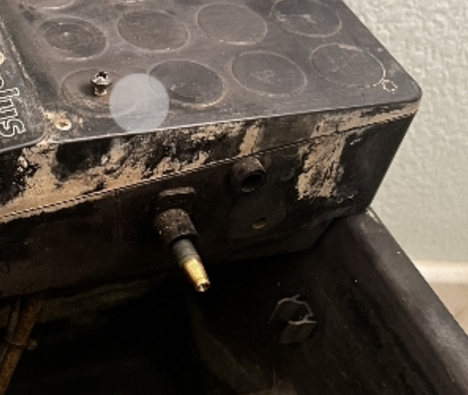

has a leak? Easy to fix?

After cleaning some contacts motor runs but only goes one direction.

The leak is not a big deal. A little epoxy and/or duct tape. Any connection with corrosion needs to be cleaned up with a fine brass wire brush. Could be a stuck relay maybe tap gently with the handle of a screwdriver.
I'm hoping you have the drive cog? I would get the leak patched on the inside with a bit of tape, fill up the trough and confirm it heats. If that works you are in business.
1500 series film tanks will work fine even if you can't get it to reverse, not print drums you will have streaks.
I would confirm heat. Then start cleaning terminals. UNPLUGGED. When you are testing don't be standing in water and become a lighting rod. It's amazing how much current the human body will carry if well grounded 😩

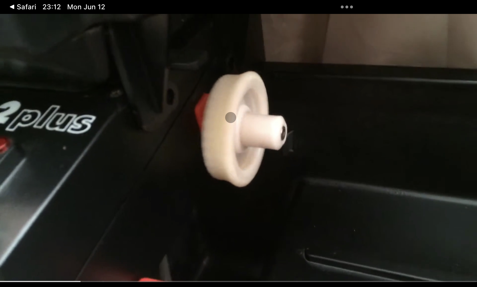

Will do. I have Jobo tanks but not cog. Also i think one gear is missing on the CPE-2plus:
Might try the magnet first.

Definitely need the drive cog. Not sure why it has a lift but no cog? Did you get a round magnet? Magnet is how tank is driven without a lift
I can find the magnet on the tank but can not find the magnet that goes on the CPE-3Plus
mpirie
Sep 19, 2005
629
Highlands of Scotland
You need a magnet on the base of the 1500 tanks and another magnet on the end of the motor shaft.
Be careful which motor magnet you get, Jobo changed the design and it looks like you have the tapered motor shaft.
You should not have the heater on without water in the bath, otherwise the element can overheat and break.

You don't need magnets if you want to use the lift. You need cogs on the tank lid and on the drive motor.

I cleaned every thing. Heater works and temp censor works.
Motor spins one direction.
Lift works well just needs a gear between the CPE-3 and the lift.
Where can I find that gear? See picture bellow?
