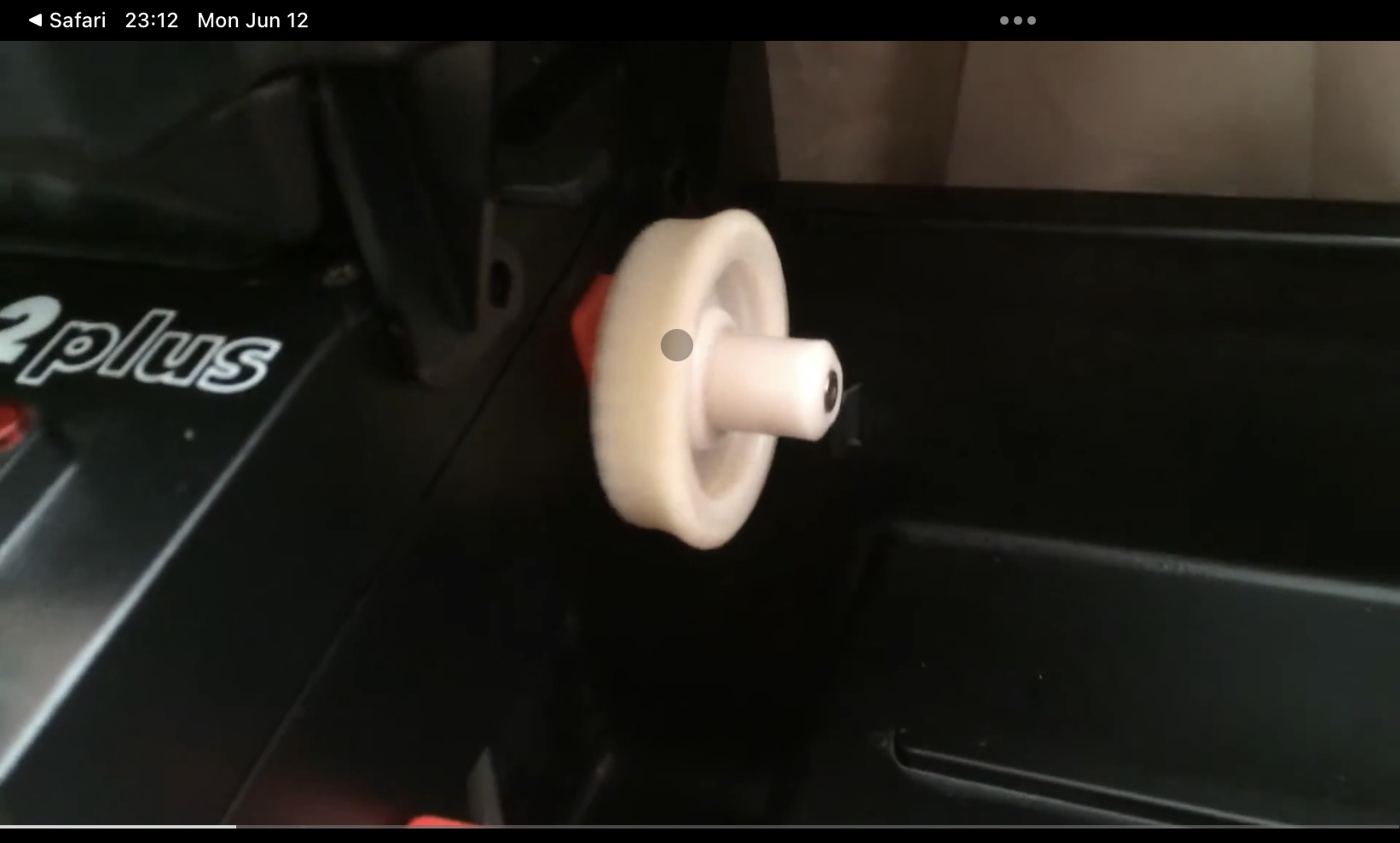

I cleaned every thing. Heater works and temp censor works.
Motor spins one direction.
Lift works well just needs a gear between the CPE-3 and the lift.
Where can I find that gear? See picture bellow?
Can you show a clear picture of your machine? My CPE2 Plus and my CPP3 have a motor drive gear that is black nylon. This black gear drives either 1 or 2 (CPP3) White nylon gears on the lift that in turn drive the tank gear.
If you are in the USA Catlabs in Jamaica Plains Massachusetts are your best bet. The drive cog is usually supplied with the lift. May be Ebay would work??? There's a straight shaft and a tapered shaft motor, I believe that the CPE2 Plus is the straight but I'm not sure.
I would start with Catlabs, ask for Jobo service, be patient.
One other thought, reach out to Fotoimpex in Berlin, they sell Jobo, I suspect it would be a simple phone call for a place like Fotoimpex to get the correct repair parts. If you're in N America start Catlabs
