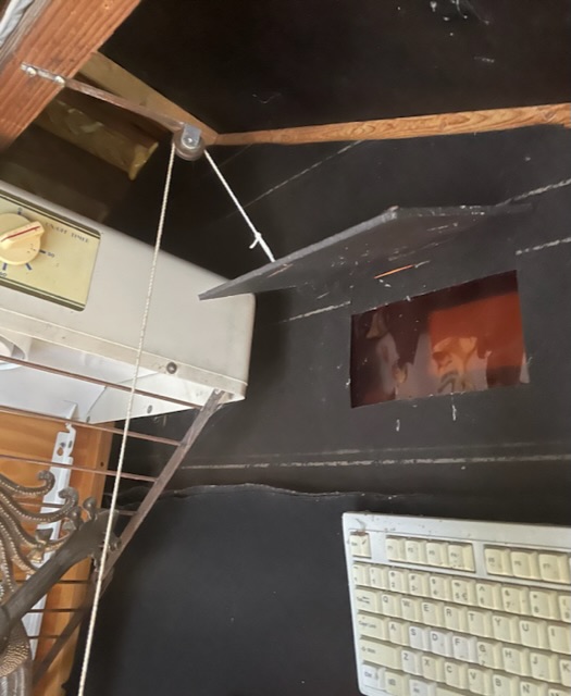

Bill Burk
Feb 9, 2010
9,290
Hear me out. I use X10 but it’s not “fast” so I wouldn’t rely on it for what you’re trying to do.
But here’s the solution:
Flap, string and pulleys.
Run a string to a flap that covers your safelight when you want it covered and opens it when you want the light.
In my darkroom I have a computer running CompnTemp in the rafters behind some Amberlith but you could have a safelight there.
Tied at the end of the string is an X10 remote that I use to turn on and off the white light.
When I lift the string and put the remote in the pocket I made in the curtain… the flap drops and I can use the timer to develop film. With the flap open I can time prints.
