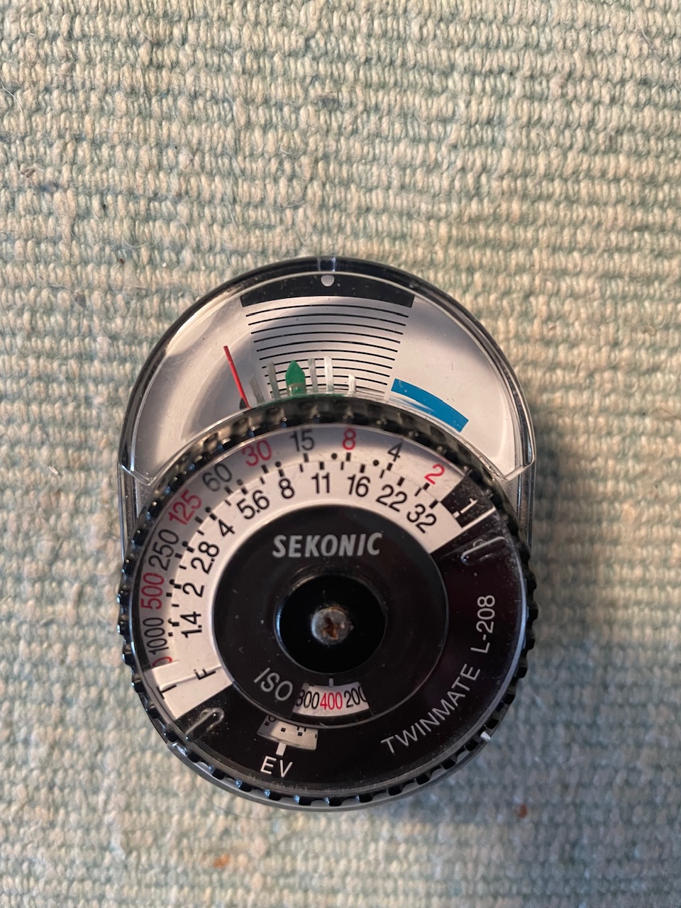

Sekonic makes a small analog meter called the Twinnmate L-208 that might work for you. It uses a silicon cell and has an analog dial.
However, I did not like my L-208. It was OK for taking readings (both reflected and incident), but the dial seemed rather loose. Not as solid as I would have liked.
The dial IS loose and it cannot be fixed. I have dumped mine.
