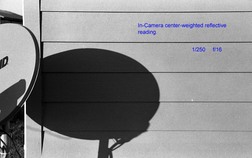

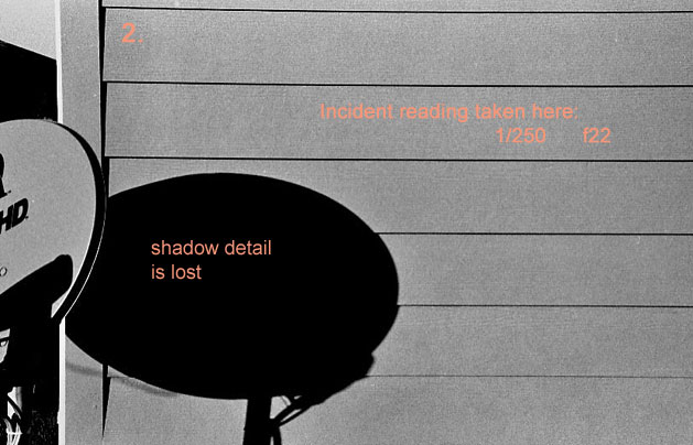

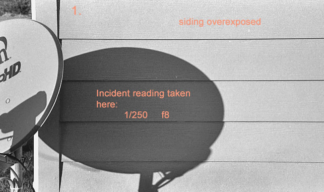

But using the incident meter in sun/shade mix situations will overexpose the high values if read in the shade and under expose the shadow values if read in the sunlight.
These are not real good negative scans but the point is conveyed---some examples of this point about incident metering.
There is obviously more light than dark in this subject. But when composing the third shot, I made sure the center-weighted meter of the camera was influenced more by the dark shaded area. The meter's outer, less sensitive regions were also a factor in determining the exposure, just not as much, but ultimately gave a more satisfying result.
Taking an incident reading in the sun and then the shade could have been done and then expose for the average reading. That would probably be the better use of an incident meter IMO, since it does take into account acutal reflective values at both the dark and the light end of the range. It actually attempts an average exposure rather than letting the reflective meter alone try and average the scene, which can lead to some pretty poor exposures if the scene is nowhere near average.

On the third shot, if you had taken an incidence reading agint the siding and then in the shadow behind the dish would the average have been the same as the third, center weighted shot?
Did you say you had a Gossen Luna Pro? Set it to 1/250 at f8 and you'll see there are three stops between the shadowed reading and the sunlight reading.
The shadow reading was 1/250 at f8 and the sunlight reading was 1/250 at f22. Taking the exact average would be 1/250 at and halfway between f11 and f16 on the dial. So, I guess on my Canon Rebel X, I would have set the average at 1/250 at f13, pretty close. This would have given just a bit more exposure to both the shadow and sunlit area.
It should be kept in mind though, that this is a very simple scene with basically two main reflective surfaces. Using the incident meter to average the high and the low light levels, while I think is a good way to use it, still does not give you an idea of the many reflective surfaces that makes up most scenes. In that respect, the spot meter is the best tool IMO, to zonies like myself, it affords the greatest amount of control. To others into the BTZS system, the incident meter is the tool of choice I believe.

CPorter, can you explain this? "Did you say you had a Gossen Luna Pro? Set it to 1/250 at f8 and you'll see there are three stops between the shadowed reading and the sunlight reading." Explain Shadow reading and Sunlight reading please.
In your post #25 you said you had a Luna Pro. In my post #29 with my example photos, I gave the exposures for each photo. The shadowed incident reading was at f8 and the sunlit incident reading was at f22, three stops difference.
I was only suggesting that you look at those on your Luna Pro meter.

Not quite true.
We usually want to have the bit the camera sees, the bit that will be captured on film, to be exposed the way we want it. Who cares about the parts of the subject we don't see?
So where the camera lens is relative to the subject does indeed matter. It determines what parts of the subject will be on film, which will not.
They don't say those things for nothing, you know. :wink:
zumbido
Jan 5, 2010
123
This is definitely part of what I attempted to encompass with my point.
Where the camera lens is has absolutely nothing to do with taking an incident light reading. It is where the light is that matters.
But wouldn't a corollary be that the light falling on the subject from the direction the camera is viewing is very likely to be the light we want to meter for? Since, after all, that's the light that we'll be viewing the subject in for the photograph.
zumbido
Jan 5, 2010
123
